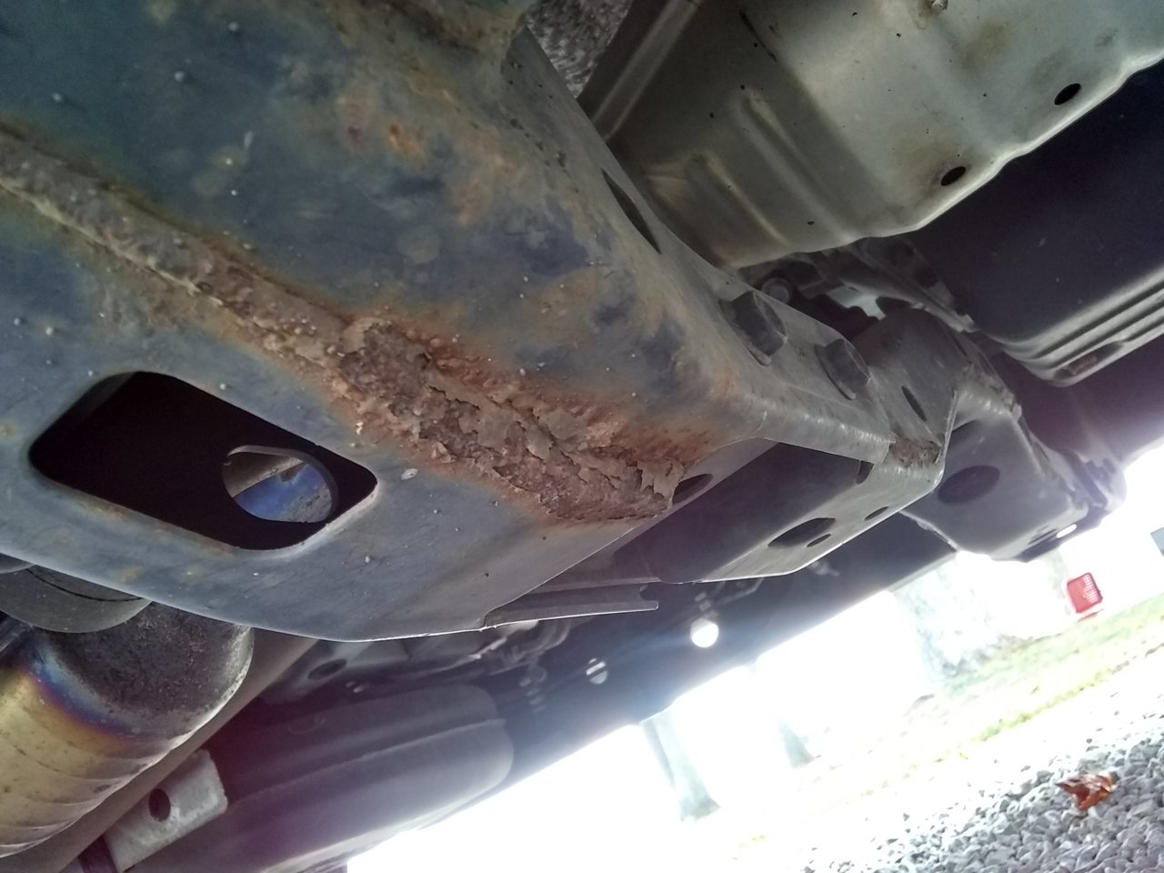

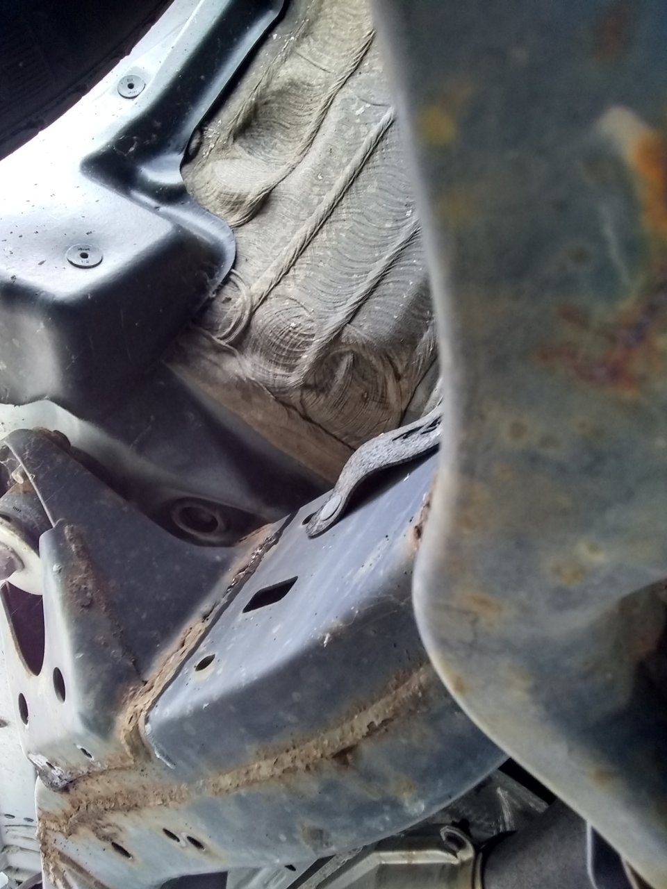

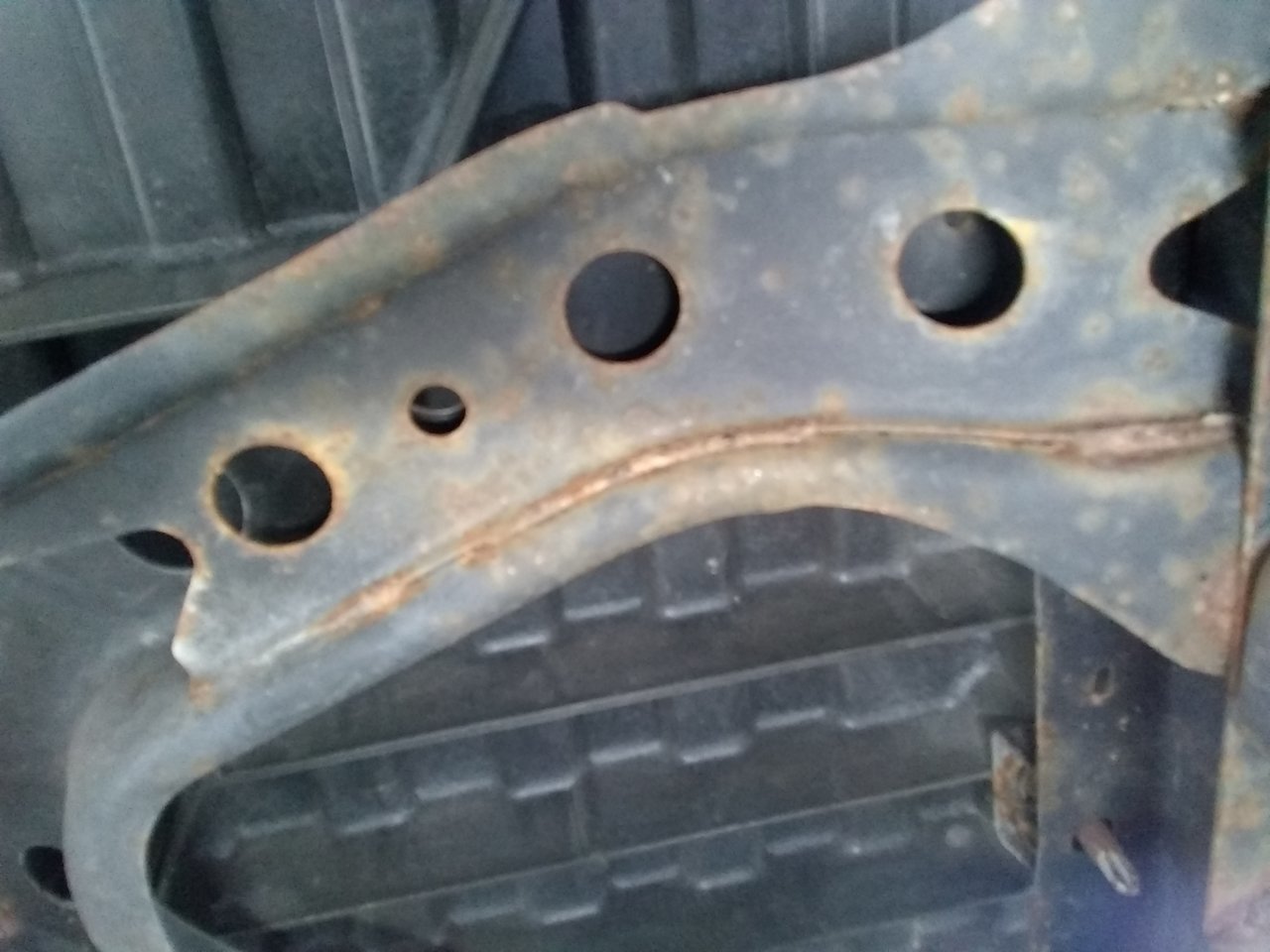

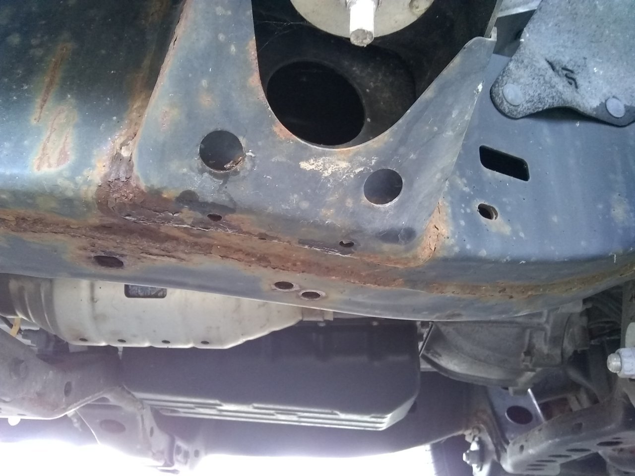

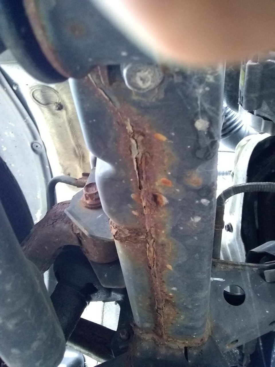

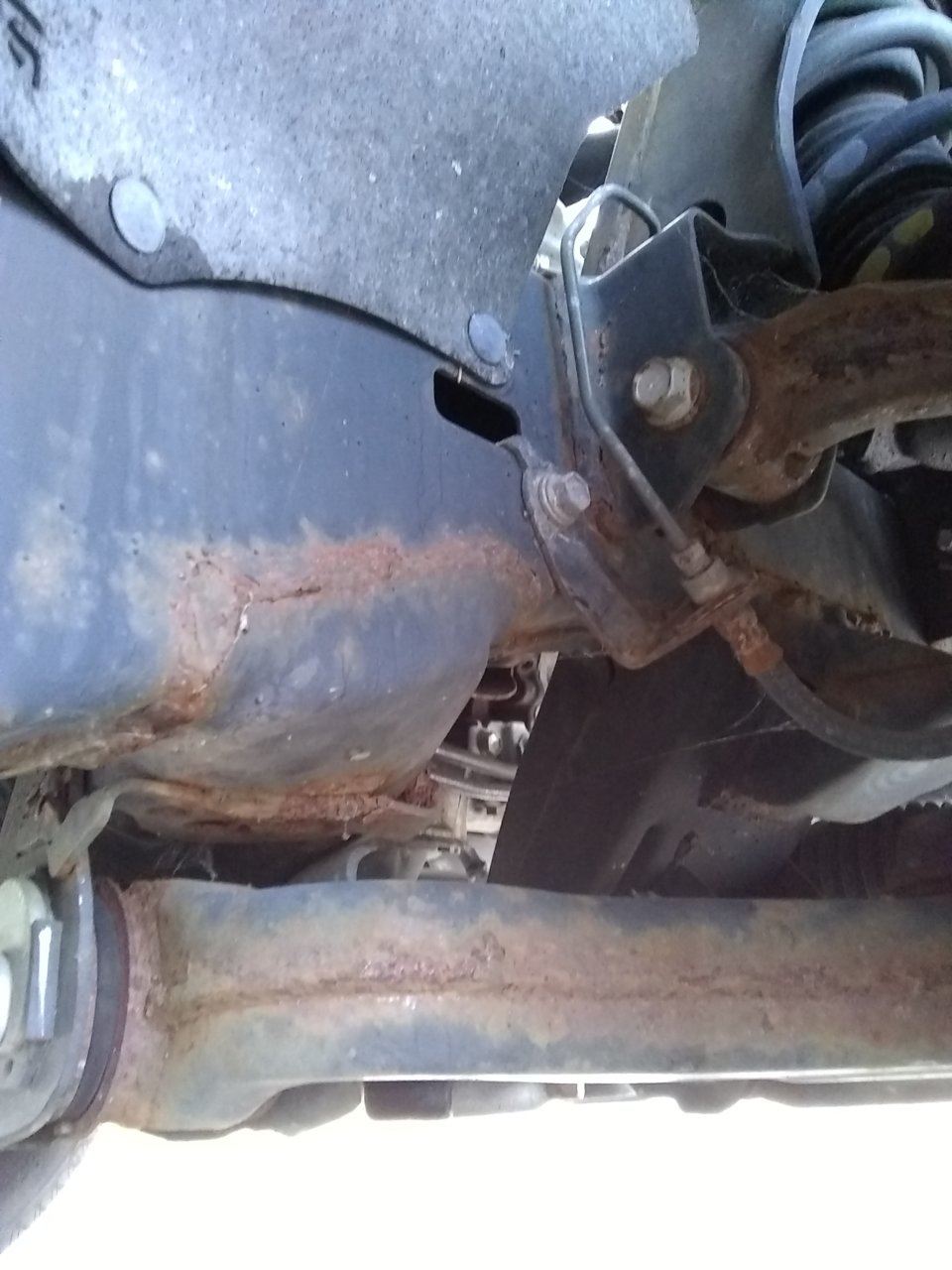

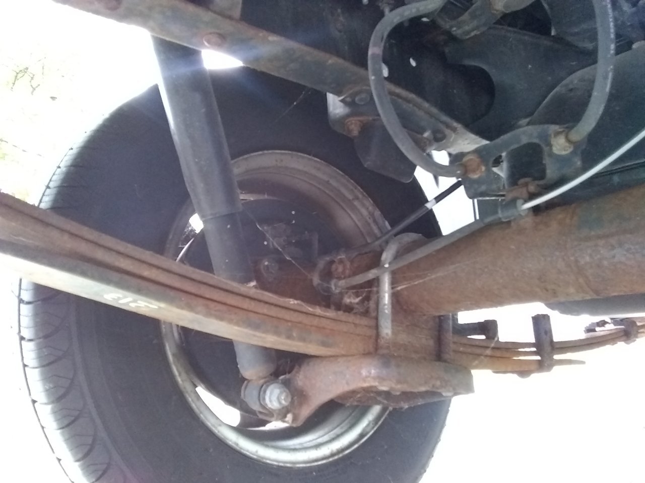

    2009 considering buying, seems to be surface and seam rust, but no perforation. Had not been dealer inspected for the warranty enh. program. Appreciate opinions as to purchase or not. Thanks.IMG_20190815_161524327.jpg IMG_20190815_161404552.jpg IMG_20190815_161138696.jpg IMG_20190815_161413091_HDR.jpg IMG_20190815_161302463.jpg IMG_20190815_161224156_HDR.jpg IMG_20190815_161144687.jpg IMG_20190815_161134087.jpg IMG_20190815_161216205.jpg IMG_20190815_161134087.jpg IMG_20190815_161524327.jpg IMG_20190815_161404552.jpg IMG_20190815_161138696.jpg IMG_20190815_161413091_HDR.jpg IMG_20190815_161302463.jpg IMG_20190815_161224156_HDR.jpg IMG_20190815_161144687.jpg IMG_20190815_161134087.jpg IMG_20190815_161216205.jpg

    Where is the location? What's the asking price and model of the truck? If it's a truck in the salt belt northern states, I would say that's not bad. The control arms looks to be the worse as far as rust. Everything else looks treatable.

    For a 10 year old NE truck it seems not too bad.

    Depends on the price. It's not THAT bad. Personally i'd stay away from it unless its a good deal. If you do buy it, you'll want to address it immediately

    I would not buy it. Too much rust at all the seams.

    Unless the price was a steal and I had the time and energy to address the rust myself, I'd personally pass on that one.

    Honestly doesn't look that bad. Could hit all the seams with a wire brush to knock all the big flakes off, then do a coating like fluid film or something. Whatever you do, make sure you get the inside of the frame too

    Iowa, base model for 11k, in good condition with only 80k miles. Should still be covered until 2021 under the frame wep even if it did develop perforations. Was not coated with the crc application though, which expired 5-21-19. Wep still good till 2021 though. If you treat it with por-15 or fluid-film, does that negate the wep and potential frame replacement?

    My 2009 doesn’t look like that after ten winters in Cincinnati. I’ve got some surface rust but not that much at the seams. But I agree, it really doesn’t look that bad. Would only take a few hours to knock most of that rust off and coat it yourself. The rear of my truck takes the most abuse from the salt/snow. I had to replace my rusted rear bumper support and my tow hitch was in terrible shape until I removed it, wire brushed and sanded the rust off and recoated it.

    Thanks all; think I'm in. Always wanted a simple, base tacoma, mileage is low, and have the enhanced frame warranty till 2021
    Fluid film or por-15 is the question after the wire brush.
    I have searched and I know the base model doesn't have the two cross supports at the spare tire mount. But this base model truck doesn't have any spare tire at all! Should there be one?

    take it to the dealer now and get it inspected. be dumb not too have it checked before buying. wouldn't be surprised if they find a hole up by the cat.

    Poke around under there with a screwdriver to make sure that it's just surface rust. For the price and model, I would look elsewhere online to buy one in a non salt belt state and make a trip to drive it home. Yes, you will spend more but the end costs and worry will offset by the time you repair this one. I would not even recommend driving this one until you replace the control arms. The CA's look to be rusted through and would not be safe to drive on.

    This ^ I wouldnt touch that truck UNLESS the dealer put in writing the frame can be replaced under warranty.
