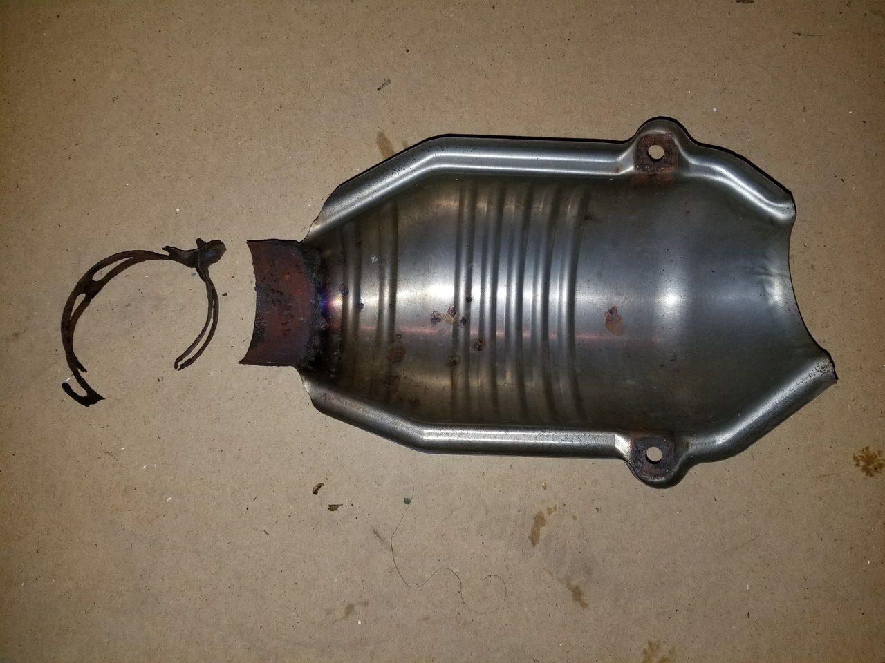

    Thought I measured it out pretty well, but after changing all of the fluids (transfer case, front & rear differential) with Royal Purple I now have a rattling sound.
    I assume it's from the transfer case because it was rattling slightly when I would first accelerate in drive. I thought maybe I didn't put enough so I added more fluid and now it rattles just having it in drive and upon initial acceleration.
    Sounds to me like I over filled. This seems odd though because as soon as I removed the FILL plug I had oil pouring out significantly, so I thought there would be no way I could put more than was already in it.
    Appreciate the help!

    Have you checked the heat shields on the exhaust system?
    Blockhead, TacoCat and DFlynn like this.
  12. Oct 5, 2017 at 3:20 PM
    GilEspy22
    GilEspy22 [OP] Well-Known Member
    Feb 27, 2017
    #211871
    62
    Gil
    2005 Silver Tacoma 4x4
    Good one. I did lay under the truck while the wife rev'd up the engine and DID hear a slight rattle from the exhaust heat shields! However, this was different than the sound that I'm more concerned about. It sounds more significant. I really hate to say that there's a metal to metal slight grind to the sound but .... there kinda is. I just don't see how this could have happened from a simple fluid change. May have to do another drain and fill to see if something may have fell in ...

    Make sure it isn't something unrelated but close to where you worked on like loose bolts on a skid or a catalytic converter heat shield.

    You da man Bro.
    Literally, just fell right off once I wiggled it slightly.
    Sorry for wasting everyone's time. I looked around the catalytic converters but didn't physically grab any pieces to verify they were this loose. Hmm ... How necessary are these heat shields anyway?

    Just get yourself a quality stainless steel band clamp and a couple of nuts and bolts for the sides of the shield and reattach it.

    A couple of years ago, I had a vibration in my commuter Corolla. It only did it when the engine was under load. I changed the axle shafts, struts and two of the three engine mounts. When I was starting to change the third one, my son was helping me pry something and said, "What's this?" It was a heat shield that had broken loose and dropped down against the fire wall. I pulled it out and the vibration was gone.
