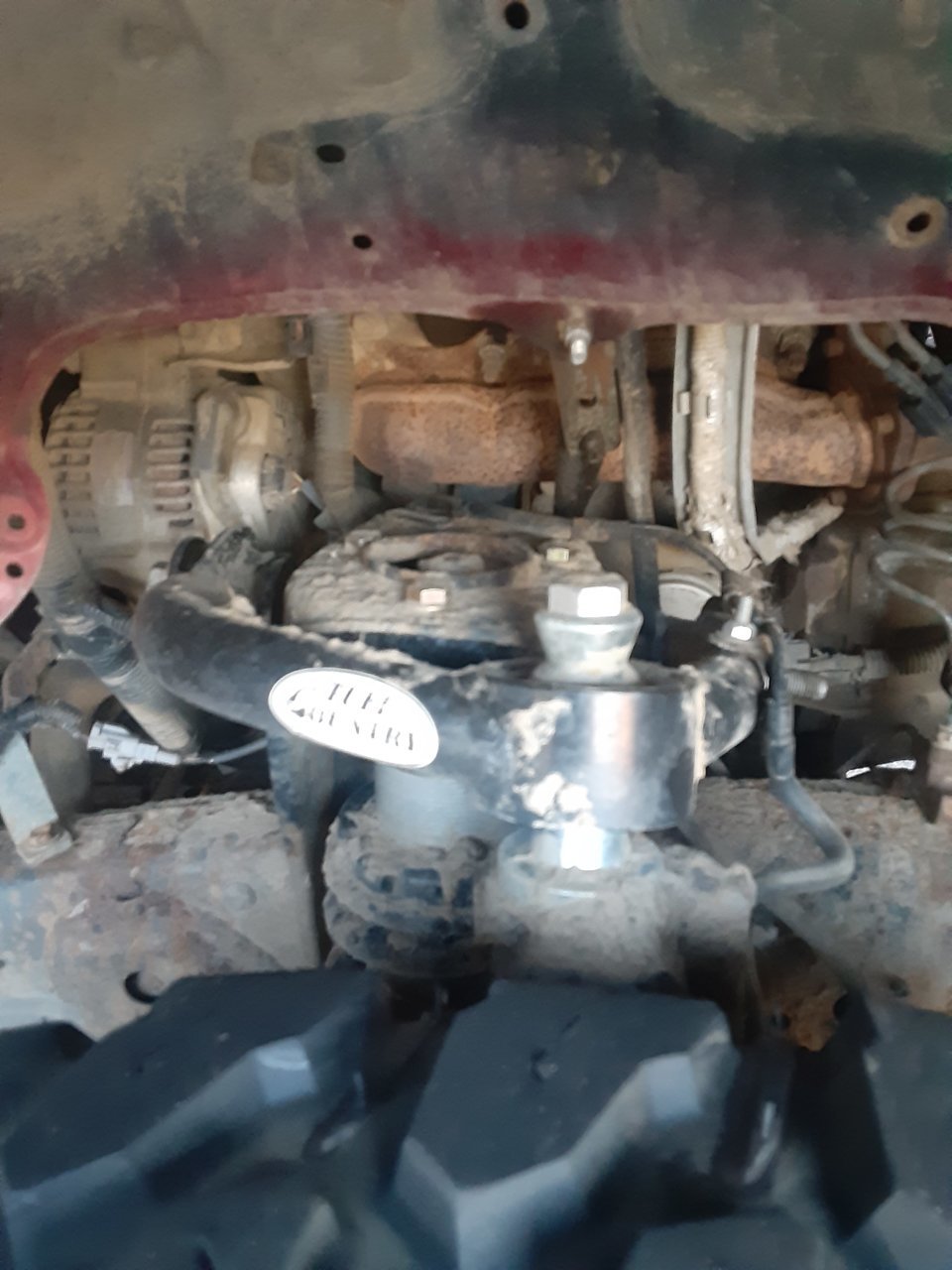

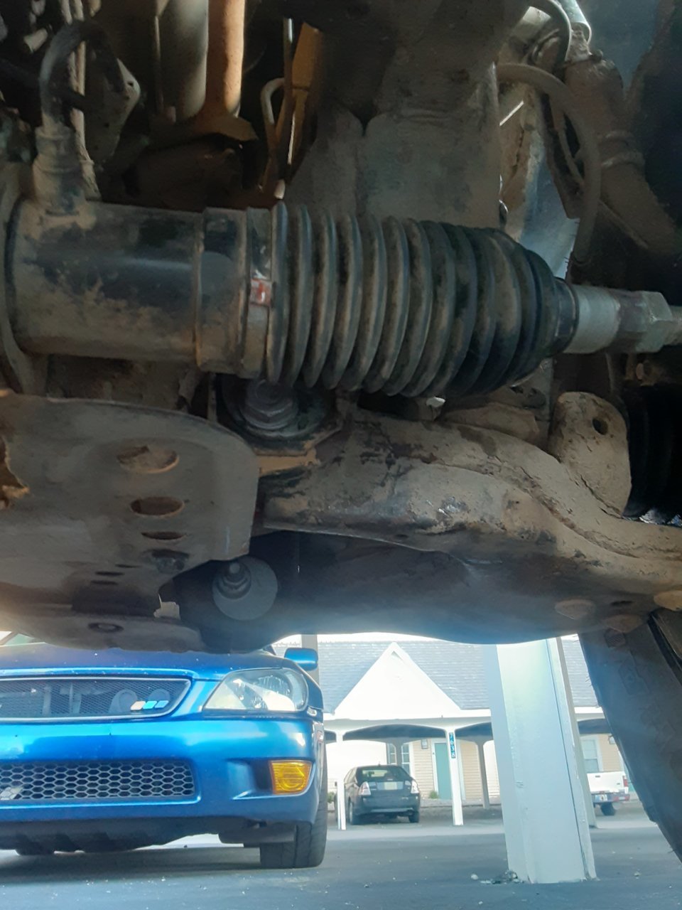

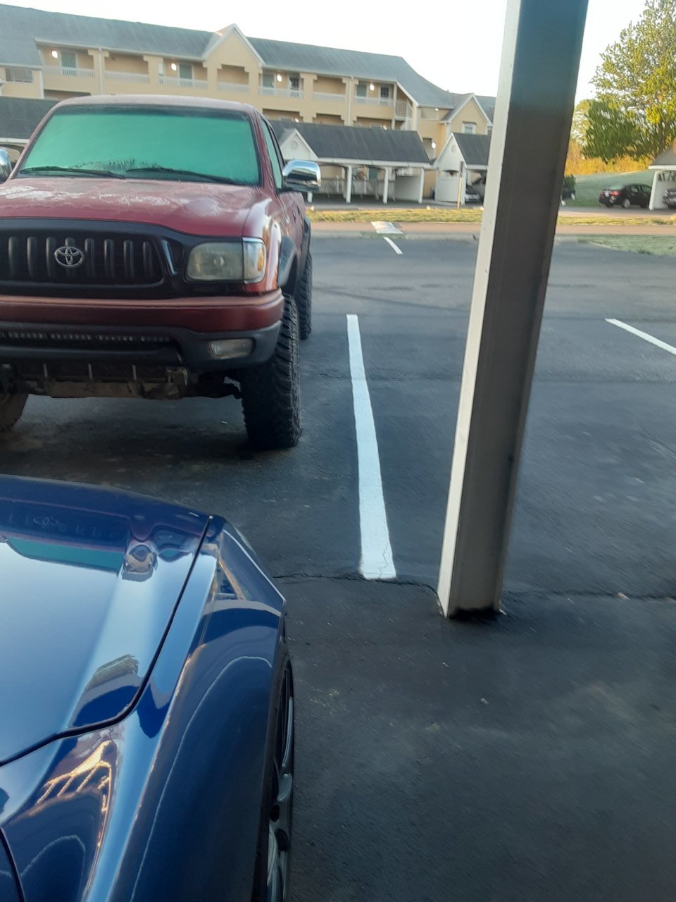

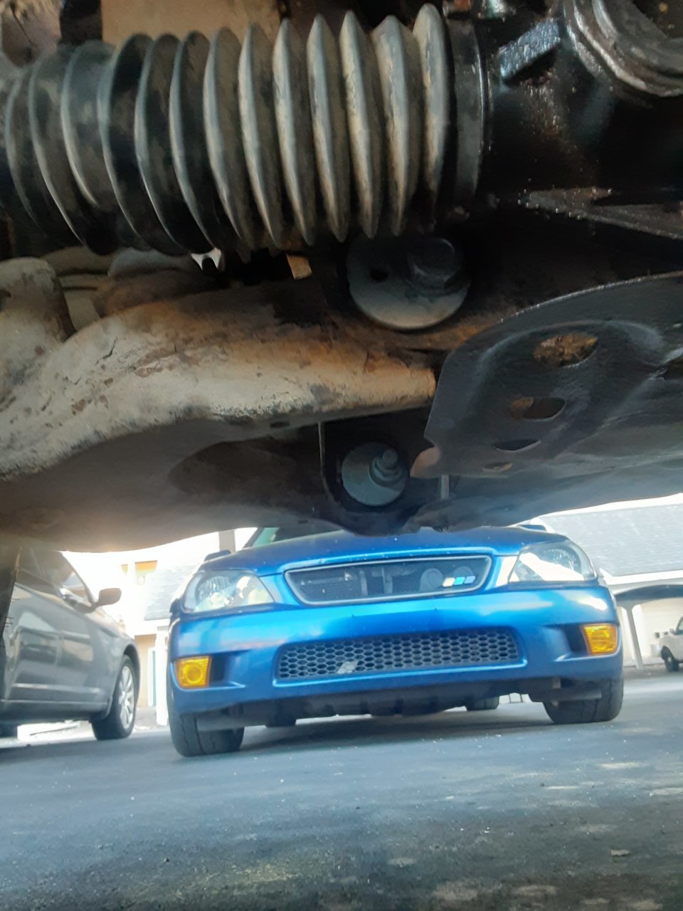

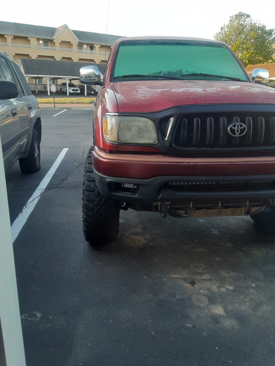

    Been struggling with too much negative camber since day 1. I've replaced LBJ, tuff country UCA with uni-ball, Icon ext. travel 3" coil overs set to whatever they came at out of the box, new LCA bushings. My cams are maxed out and I still have visible negative camber. At this point my only ideas are both of my strut towers are bent, I doubt this because it's pretty even on both sides or the UCA are creating too much negative camber for the amount of lift I have. I'd guess they're set around 1" ish.

    Need pics. Usually as you lift you naturally get positive camber so this is unusual

    Ya that's super weird. I'm at a loss from those pics. Is this a 5 or 6 lug?
    I'm almost wondering if those aren't the right UCAs

    6 lug. I'm wondering if the UCA are shorter to help camber correct at 3" of lift. I'm set to whatever icon sets them at out of the box so maybe that's my problem. Other then that idk.
