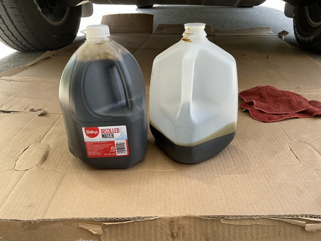

    Changing the oil in my 2008 Tacoma Sport 6 cylinder DCSB automatic 2 wheel drive with the towing package. Should have 4.8 quarts of oil. I drained it then added approximately 4 1/2 quarts.
    When checking the dipstick it's exceedingly hard to see the oil level. The oil is very clear and oil gets on the stick as I remove it from the tube. It appears there's too much oil but I can't be certain.

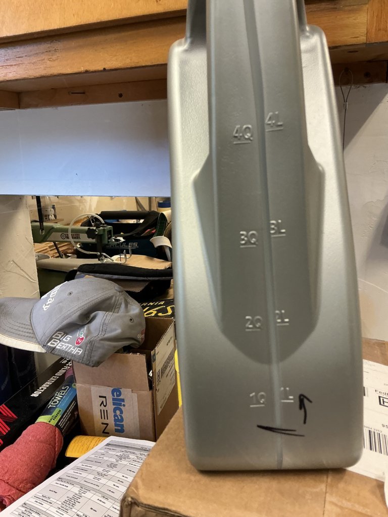

    I poured the used oil in these gallon containers (all I had). 1 gallon = 4 quarts. From the 5 liter oil bottle I poured about 4 1/2 liters. See the black mark on the bottle... from the line up.
    What do you think?

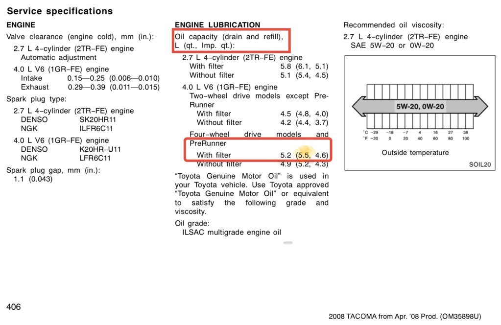

    Well fuck me. I could have sworn is it was 4 1/2 quarts in several places I looked. Now that you said 5.5 quarts I looked again and see that's right. In this situation (haven't drove it yet) under filled is better than over.

    On my 07 manual: it is 4.8 qts (4.5 liters) for V6 2 WD models. And 5.5 qts for V6 Prerunner and 4x4 models.

    Damn I've had both a 07 prerunner and a 08 4x4 both 4.0L, I did not realize the non prerunner 4.0L took less oil. When I specifically searched for 2wd oil capacity it confirms what you said.

    Ok, couldn't take the uncertainty. From the 2008 owners manual - 5.5 is correct for my model.
