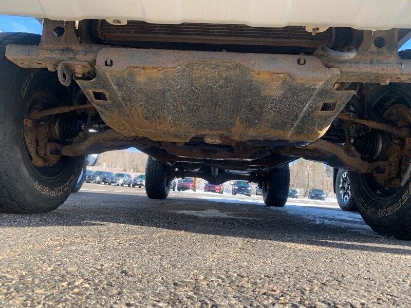

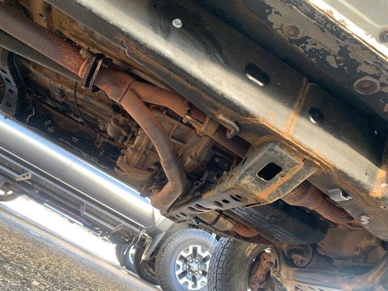

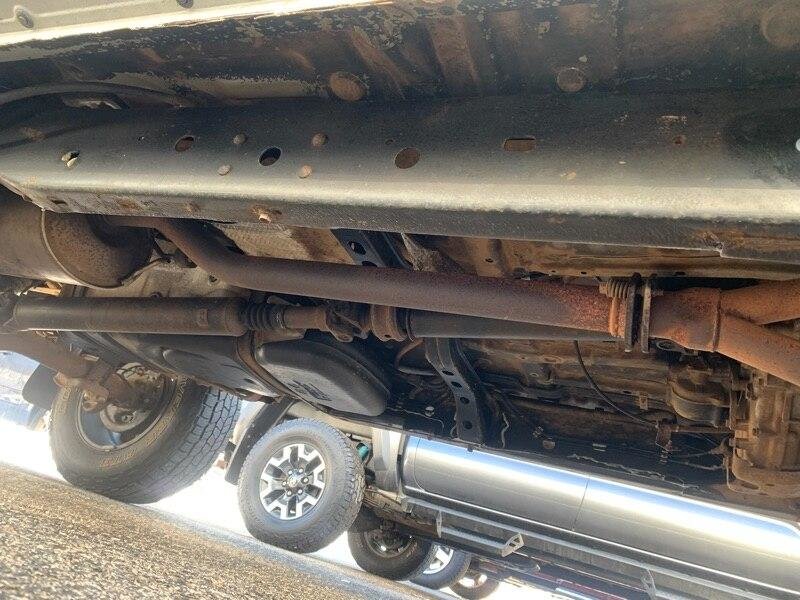

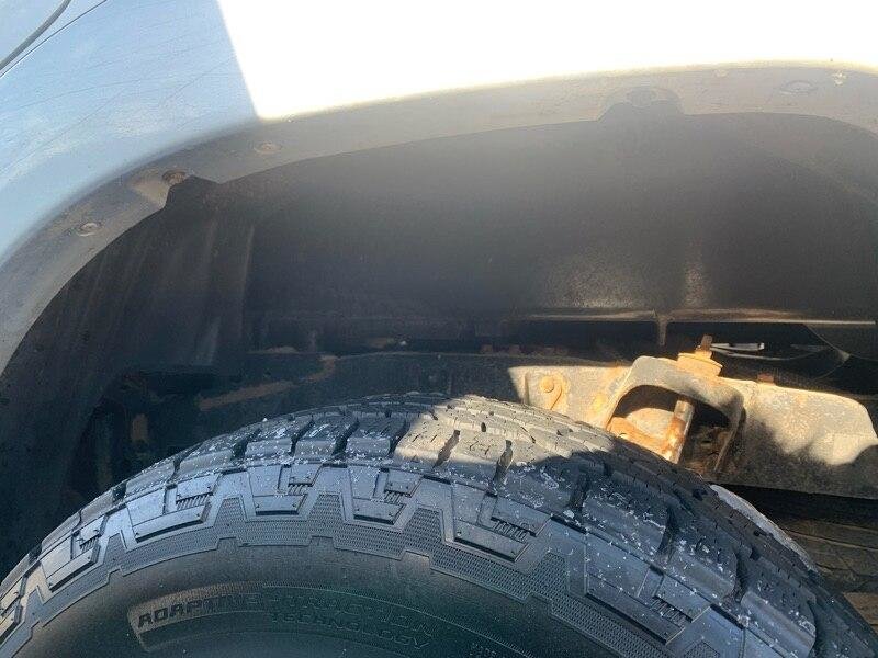

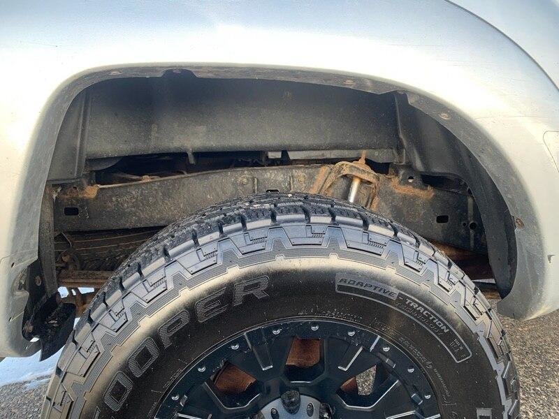

    I am looking to buy a Tacoma and found one that meets all my required specs: 4x4, crew cab, 5' bed, under 150k miles, <=10 years old, and <$17k. The only issue is that it spent its entire life in Michigan (1 owner) and accumulated some rust on the undercarriage. I realize that pictures are really not enough to tell the full story. I plan on having a dealership give it a look before I buy it. Was wondering if you all had any insight though, based on these pictures.

    It doesn’t look “too bad” by the pictures.
    But the type of pictures you posted don’t really help with a “good opinions”.
    You really need to crawl under and inspect the frame for delimitation, large scales of rust, and holes in the frame. Don’t be afraid to get up close and personal with the frame. Take a screw drive and peck the suspected areas.

    That’s actually pretty clean for a Michigan only truck. Did it have the frame replaced? It’s either been decently maintained, or the frame was replaced and what you see is the current owners neglect of the new frame.
    Like what was said above, you need to really check this thing out if you are serous. Take a ball peen hammer and whack all around the inside of the frame that’s next to the cat converters. That’s where the killer rust starts.
    I never trust integrity by photos or surface rust. These things rust inside out. It’s not about what you see, it’s about what’s on the inside.
    edit: it also has plastic frame plugs on the middle half of the frame rail. This says to me it’s at least been to a dealer to be potentially looked at and sprayed under a campaign, OR the PO added themselves, OR again the frame was replaced. I’d dig deep in the records.

    After looking at the photos again you can see it’s been sprayed with the white goop Toyota uses for the C channel seams,etc.
