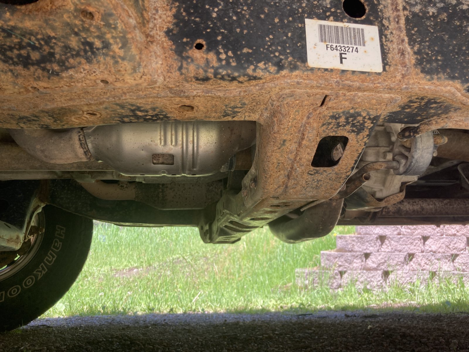

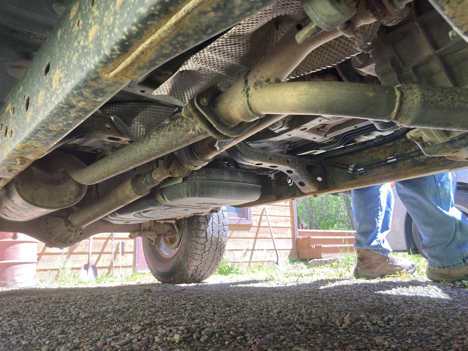

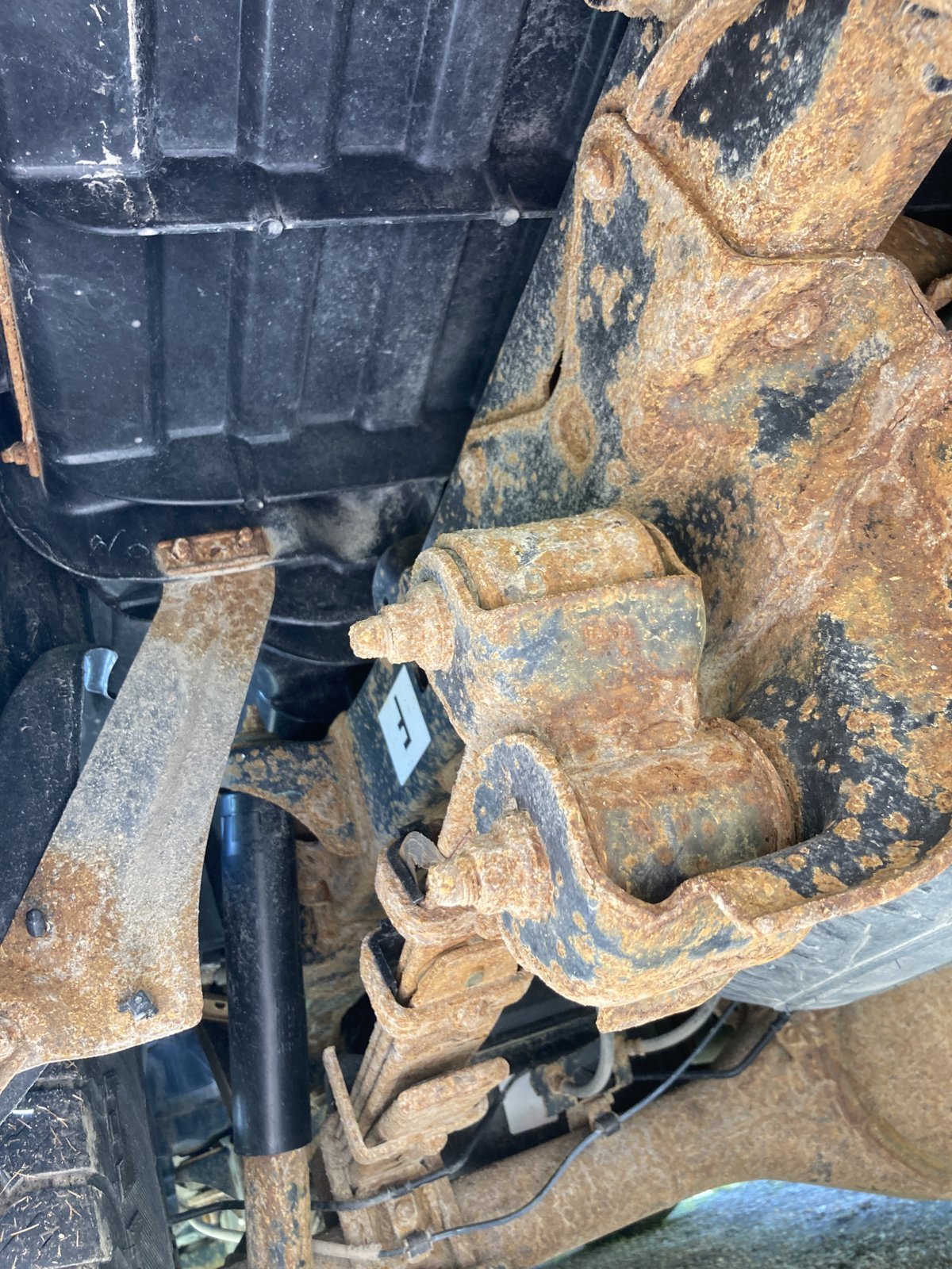

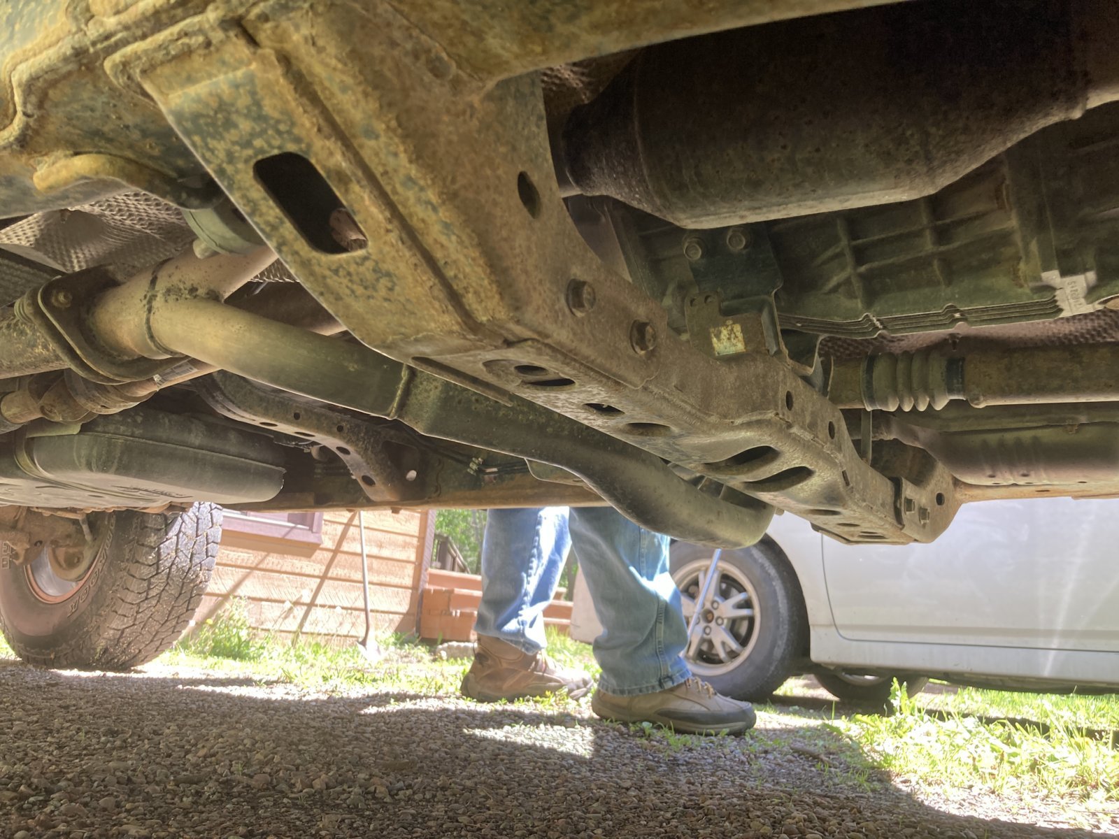

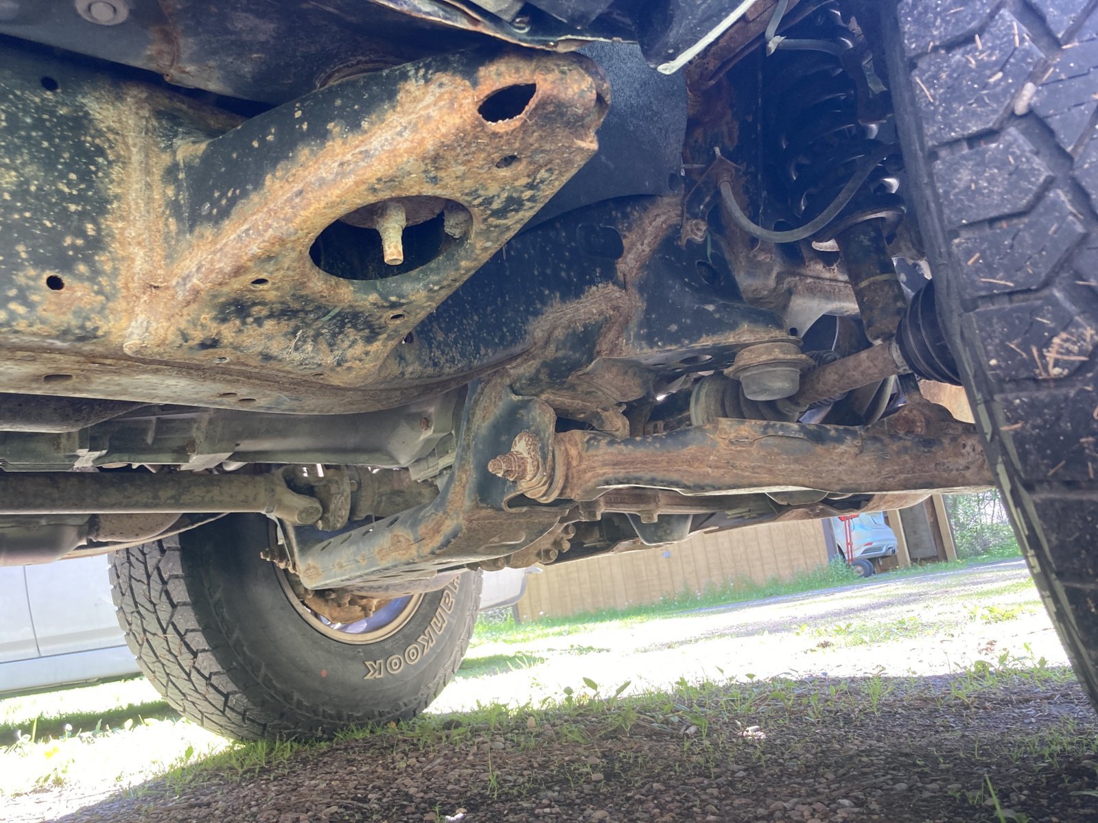

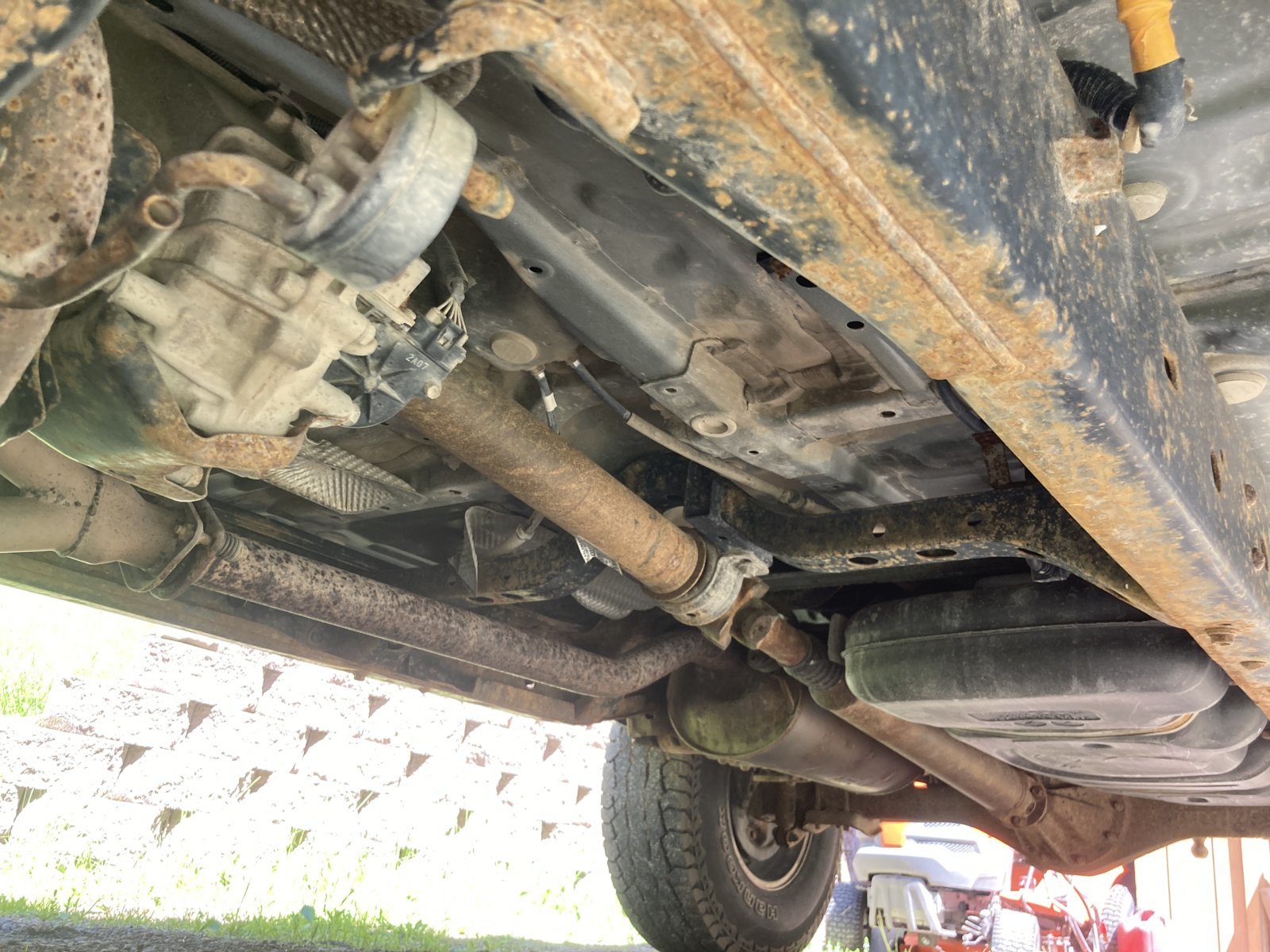

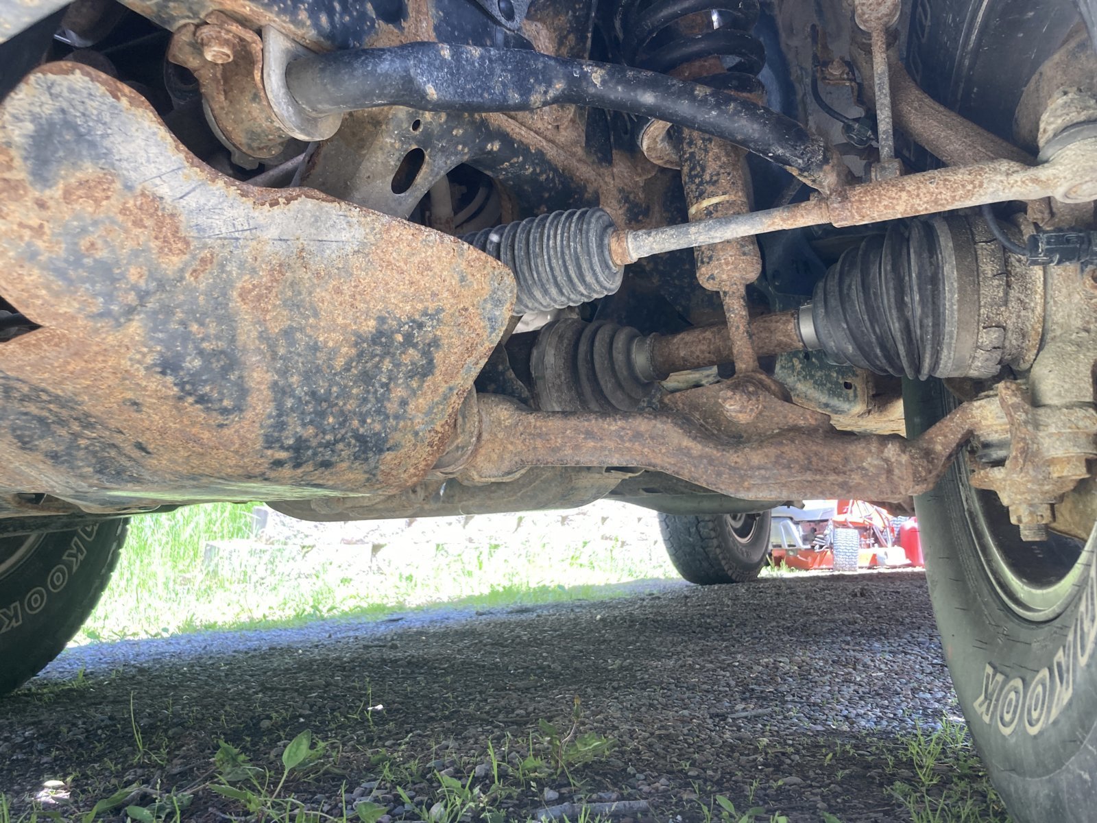

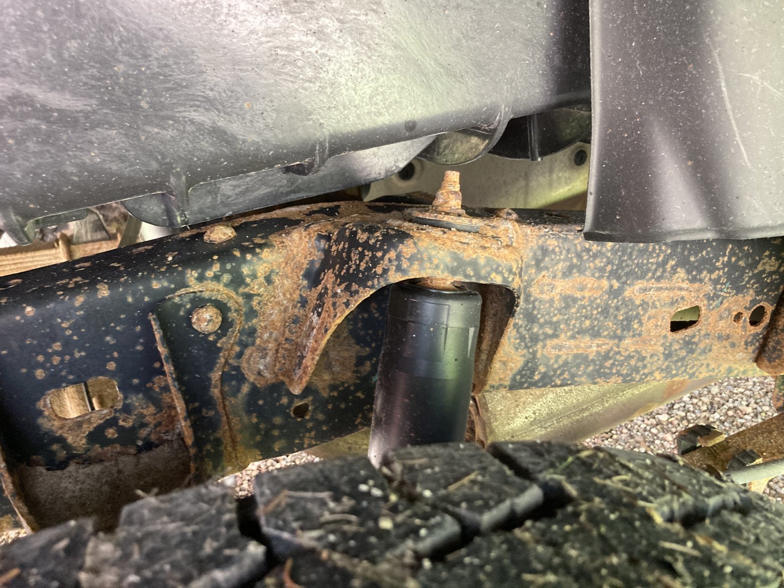

    I’m hoping to probe the depths of your knowledge as I navigate purchasing another Tacoma. I had a 2006 that unfortunately rusted out and just barely missed the warranty frame replacement… Plus was a PITA to work on given the nonstop rust battle from the truck’s early life in Maine with the previous owner. I hoped that truck was going to be a 300,000 miler or more… but it wasn’t.
    After a couple of years without a Tacoma in my life, I’m hoping to return to the fold and do not want to have the battle the losing battle of rust again. I went to check out at 2012 Taco today and it checked all my boxes, except the rust… which is why I’m asking for your input on whether this is too much or worth it To dive in some restorative work. Pictures attached.

    Also worth noting it’s lived 100% of its life in NW Montana - no salt but mag chloride…

    X2. Definitely need to do the ball peen hammer test!

    That's a lot of rust, espically the rear end. Check the frame near the cats, that's where a lot of the problems lie. If you did decide to buy this truck, you'd have to remove all of that rusk, repaint, and the rust proof if you wanted to maximize the life of the frame. The frame isn't in the "buy the truck and drive" catagory, but rather "buy the truck and put a lot of time into trying to make sure the frame lasts" catagory. I also see the rust as the previous owner(s) didn't put a lot of time/effort/cost into maintenance, which goes well beyond the rust we see in the pictures.

    It's an older fella who did keep diligent notes/receipts for all repairs done on the truck (great) but didn't do anything to avoid or fight the rust (blew it)... and although it drives real smooth I'm generally in agreement that it's more of a project than I think I'm looking to dive into. Great clarifier @JAGCanada with the "buy the truck and put a lot of time into trying to make sure the frame lasts" description... schucks!

    Man, from a NJ guys perspective, that doesnt look bad at all. Looks like all surface rust.
    Around here, truck usually look like that after 5 years.
    If you can clean off as much as you can, paint it, then keep up with a oil undercoating on a yearly basis, that would be ideal. But you could also just fluid film it as is and im sure it would be fine for many years

    If i had nothing better to do, access to a lift and an alternate means of transport I would take on the project. Assuming the lines aren't all fugged with corrosion. The frame doesnt look too too bad.
