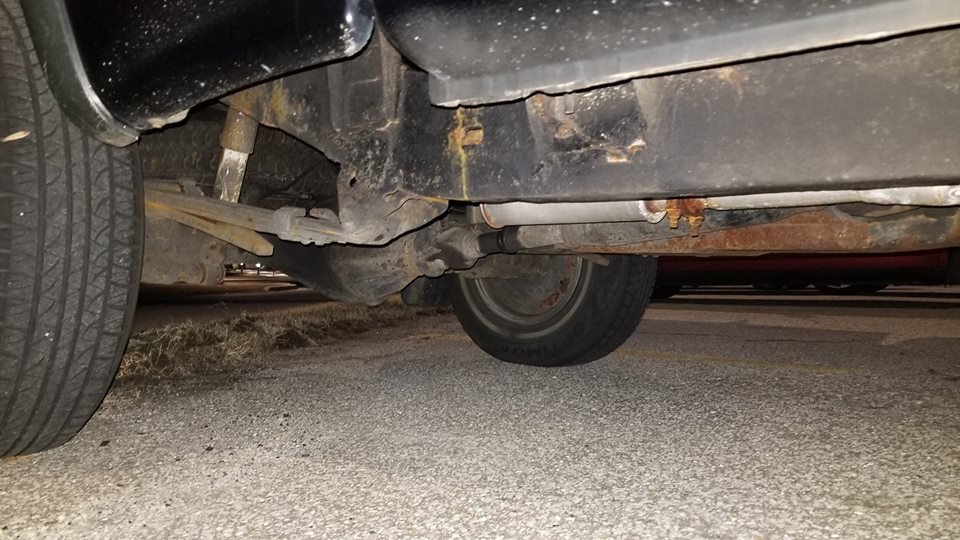

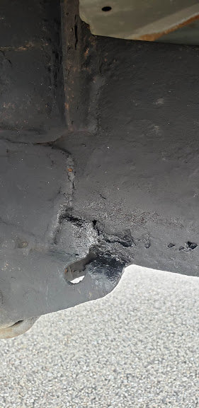

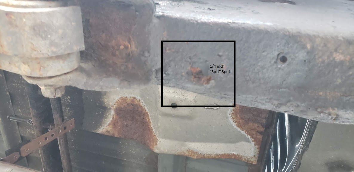

    Looking at joining the USA Tacoma family (1999 SR5) and want a second opinion - I've researched the hell out of frame rust and found a truck within my price range, but has one spot of rust that is a bit dubious to me. I tapped all along the frame and sounded solid throughout, with some (expected) surface rust.
    It's by the right leaf spring mount. (Current owner has painted it). Pictures attached of spot.
    Photos at this link are general condition of frame.
    https://photos.app.goo.gl/vUeU6f4KRyyix312A
    It also appears the the truck has been rear-ended in the past (before previous owner) and has been repaired. Repairs look good - should I be concerned? They purchased the truck 1 & 1/2 years ago from a dealer, and put 15k miles on it.
    Should I take the leap? or keep looking?
    If I do decide to purchase will be getting a inspection performed before buying.
    I could go either way on this.

    walk away, unless 5 k or less and be ready to spend 2 k to fix it. Unless your a great welder.

    Where is the truck located and where has it lived? Run a carfax/autocheck. From the pictures, I'd say no. Buy once cry once

    the thing is that these these frames rust and rot from the inside out, so what you cannot see is worse than what you can see.
    Second pic shows that it was already patched up. It doesn't look too bad because owner did paint over the rusty frame, but don't be fooled. This frame is on borrowed time. If you don't plan to keep it for a long time, it's okay, but you'll probably resell it at a loss because of the bad frame. Get it for real cheap or pass, as this is not going to be a reliable truck and you will most probably have to sell it at a loss if you do not fix the frame
    But given you're tight on cash, better spend the little you have on a better truck, as you do not want the frame to break in half on you or a huge chunk of it falling off, rendering the truck unsafe to drive
