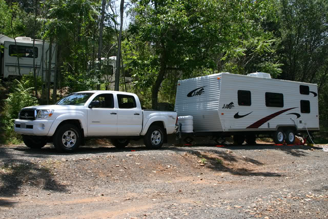

    +1 you'll be fine. I tow a 26' travel trailer (not hybrid) that weighs 4300# unloaded. I'm about 5500# loaded. Slow on the grades though and let'er rev over 3.5k to get the best performance if you're climbing and she'll do just fine.

    j4x4ar3, do you have a picture of that 26 footer behind the Tacoma? That must look cool!

    Old photo from one of the first trips. It's unhitched in the photo. I've got some newer photos with my mountain bikes in the bed but I haven't uploaded them to photobucket yet.

    Awesome, thanks j4x4ar3! Looks more reasonable than I thought, I got to say (I mean the trailer length behind our truck). If you get to uploading more pics - I'd be very interested. Which trailer is that? Looks nice. Also, are you using a WDH? Which mirrors?
