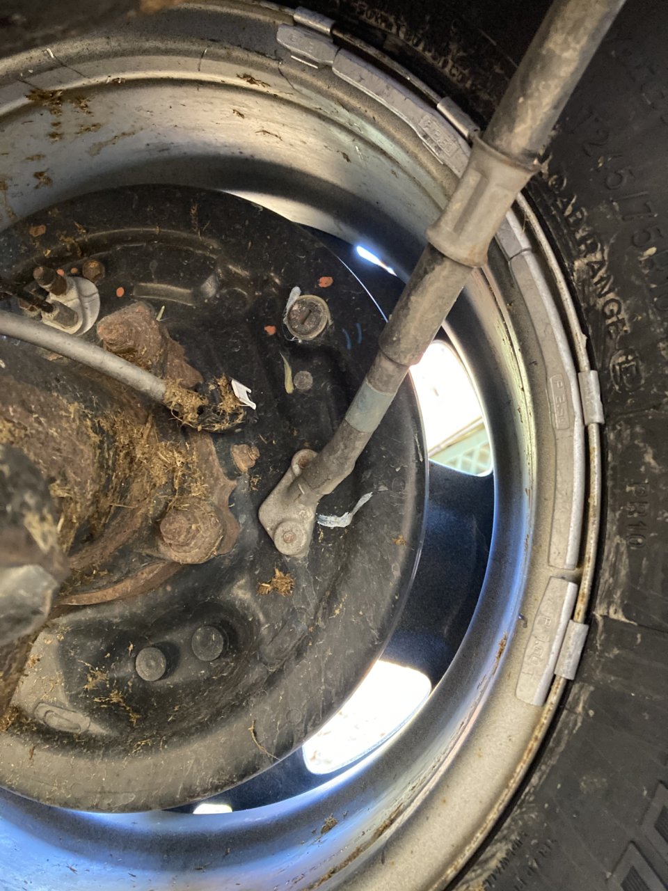

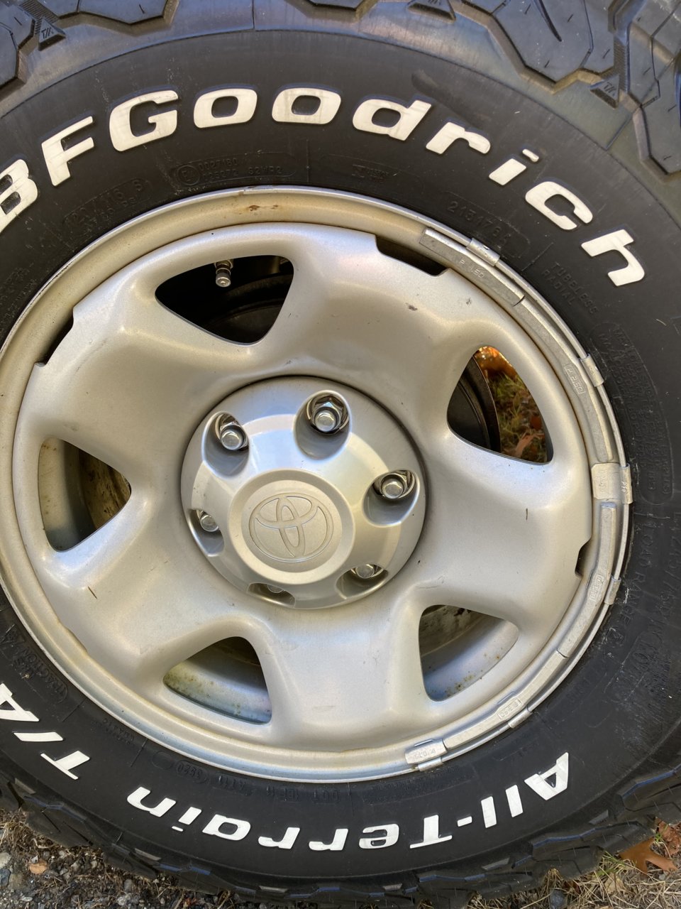

    Got these BFG ko LT245s installed at BJs. This just dosn't look right to me, should I have BJs or someone else rebalance this tire or have BJs replace it. The ride is nice and smooth for now, but I'm worried about further down the line a few thousand. Outside weights at 3oclock inside are at 9oclock oppsite of each otherupload_2020-10-8_17-23-41.jpgupload_2020-10-8_17-26-0.jpg

    that seems excessive

    no, no ,no. Have them take the tire off the wheel, spin it 180degrees, and rebalance.

    reworking them 180 degrees may help some
    when rolling at speed.......sqirming & heating up ( only takes a few miles )
    its a different creature
    big rims big tyres..........the concentric out o balance may be actually inches........FAR away from where the weights
    that are attached to compensate for the imbalance
    the weight machine only rotates in ONE plane !!!!!
    the imbalance can be center tread or inside / outside bead
    the new ‘ road force ‘ thingy doesnt apply the weight the tyre will in reality have that
    rollin .....squirming at hiway speed
    if Uv ever seen a tyre bulit from scratch
    the build up of plys
    splices on each ply
    they are Forced round in a mold..............rubber under heat/pressure moves
    quite a bit

    No way in hell, something's seriously amiss to have that much weight to balance out. Especially on a factory wheel. Tire or wheel issue, have a them check/redo.

    Update, had them redo with 180 spin on the rim, still quite a bit of weight but its down to 6oz total. Thanks for all the input!

    6 oz seems like a lot still.
    Perhaps the shop could exchange that tire for another of same. Then try a balance.
    I suspect that particular tire may have a defect from manufacturing.
