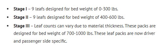

    Something like the Deaver Stage 1 or 2 might be good for you. Can run your oem shocks until you save up for others. And with an extra set of hands, swapping leaf springs is like 12 bolts and pretty easy (4 on each side for the u-bolts, and 2 more for each side, one front, one rear at the ends of the springs).
    I've been running 5160s in the back with my stage 3 and they've been great.
    Deavers are rated at ~3" lift with the below weights. (2" on a 3rd gen). I run the Stage 3, but as I'm well past 1000 pounds I run pretty close to stock height. I'd think Stage 2 at your weight would get you relatively close to stock height.
