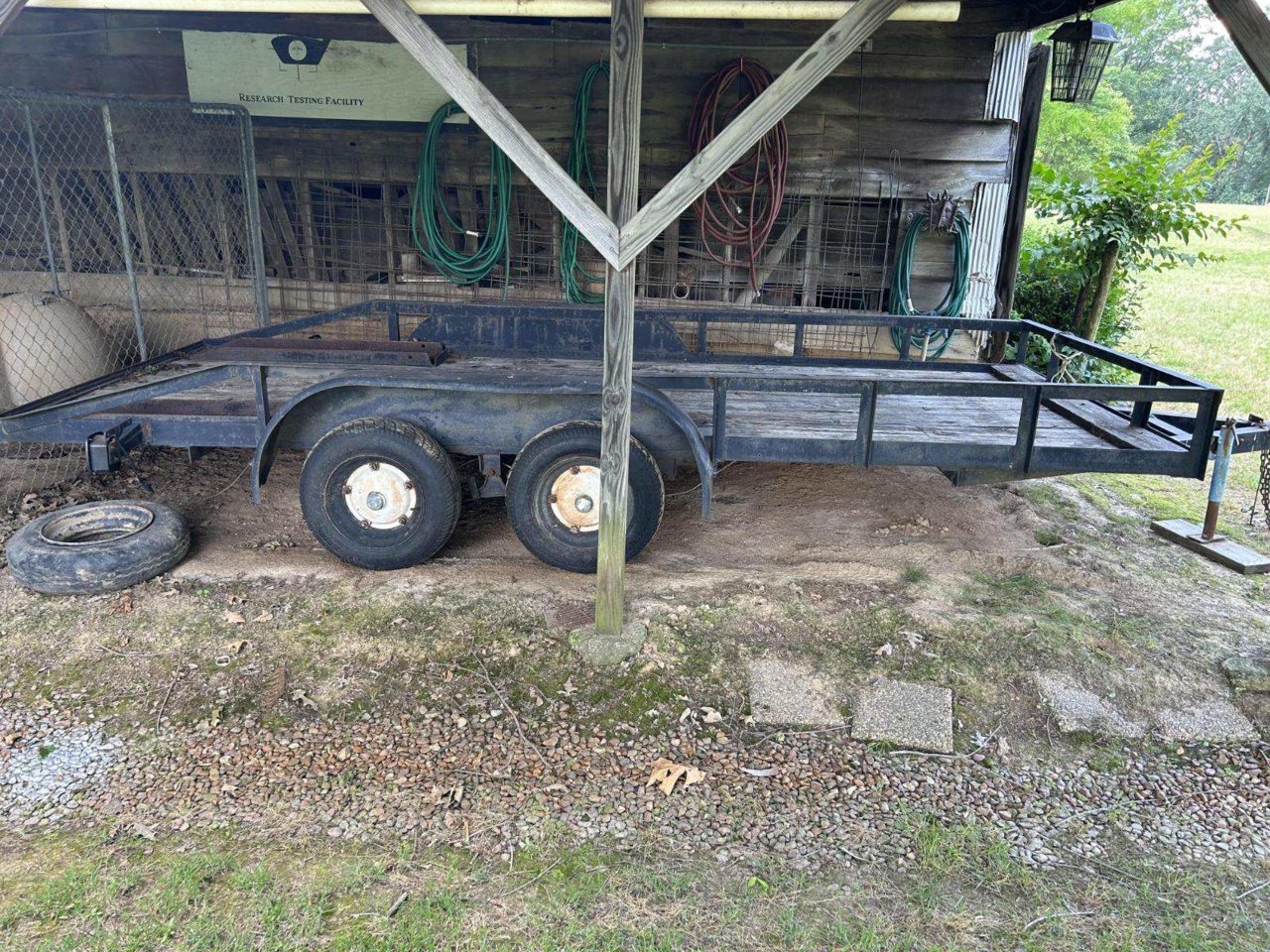

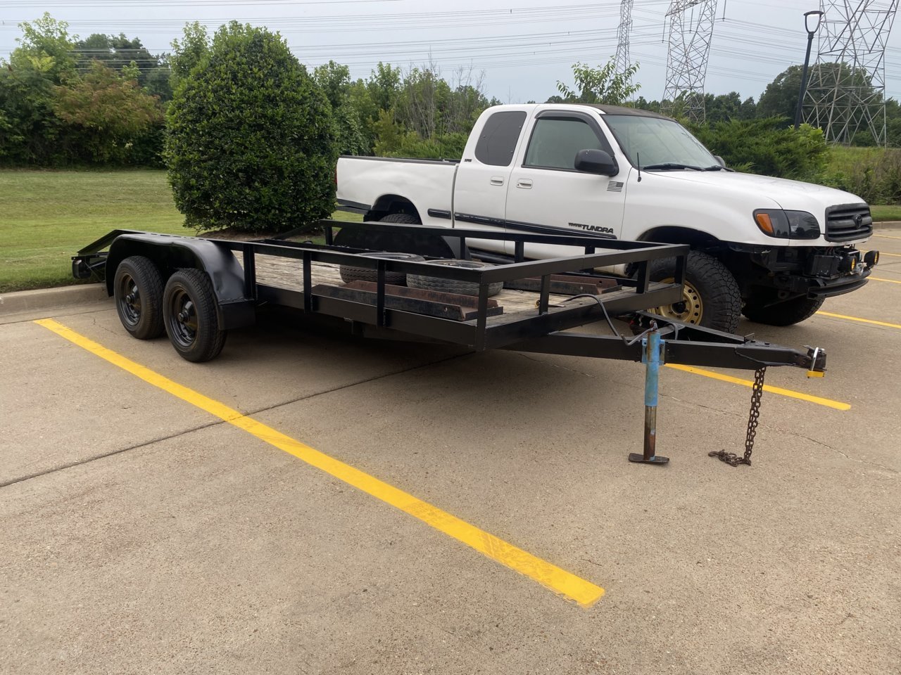

    Nice trailer, I need to find me one. That drum wasn't far from coming off :eek:

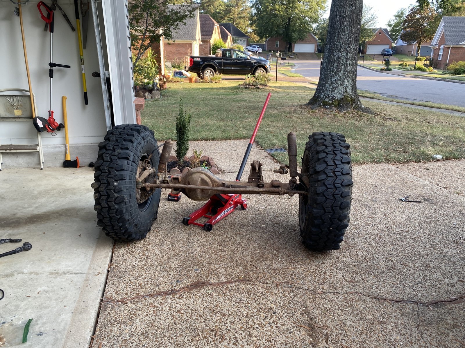

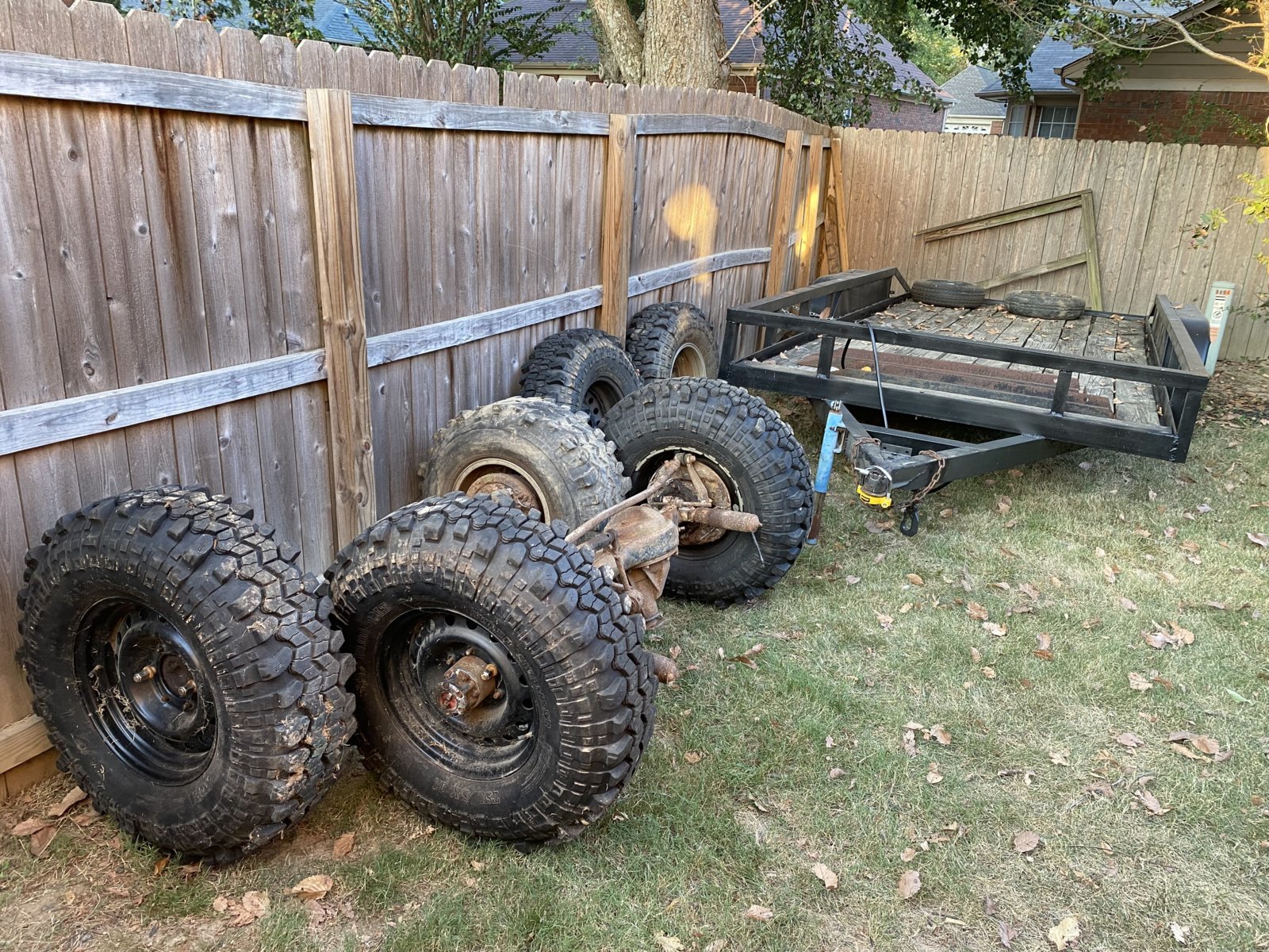

    Life has been busy for me lately so the Samurai has been put on the back burner for a bit. I recently got around to start working on it again as I’m preparing to take it out to windrock in January.
    About a month ago me and @Justinogo went up to Indiana to pickup some Toyota axles. Gonna start acquiring parts to rebuild them and swap them into the samurai.

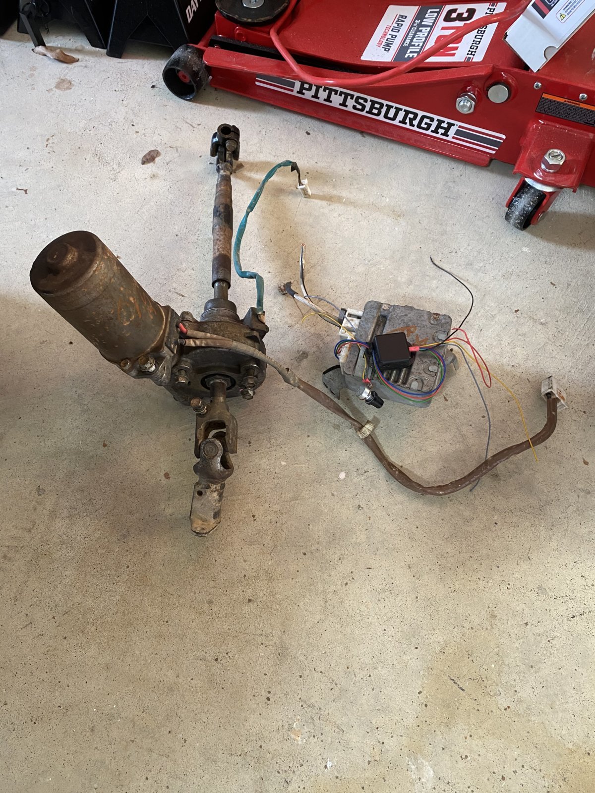

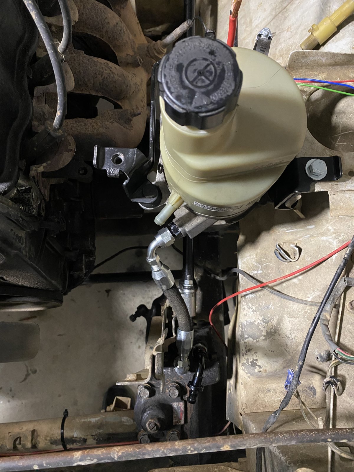

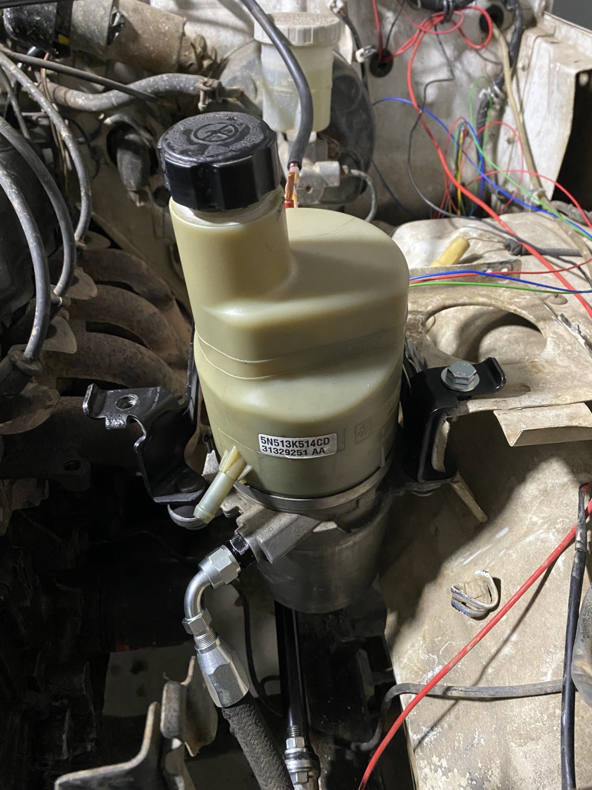

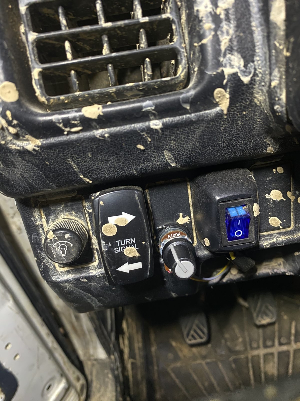

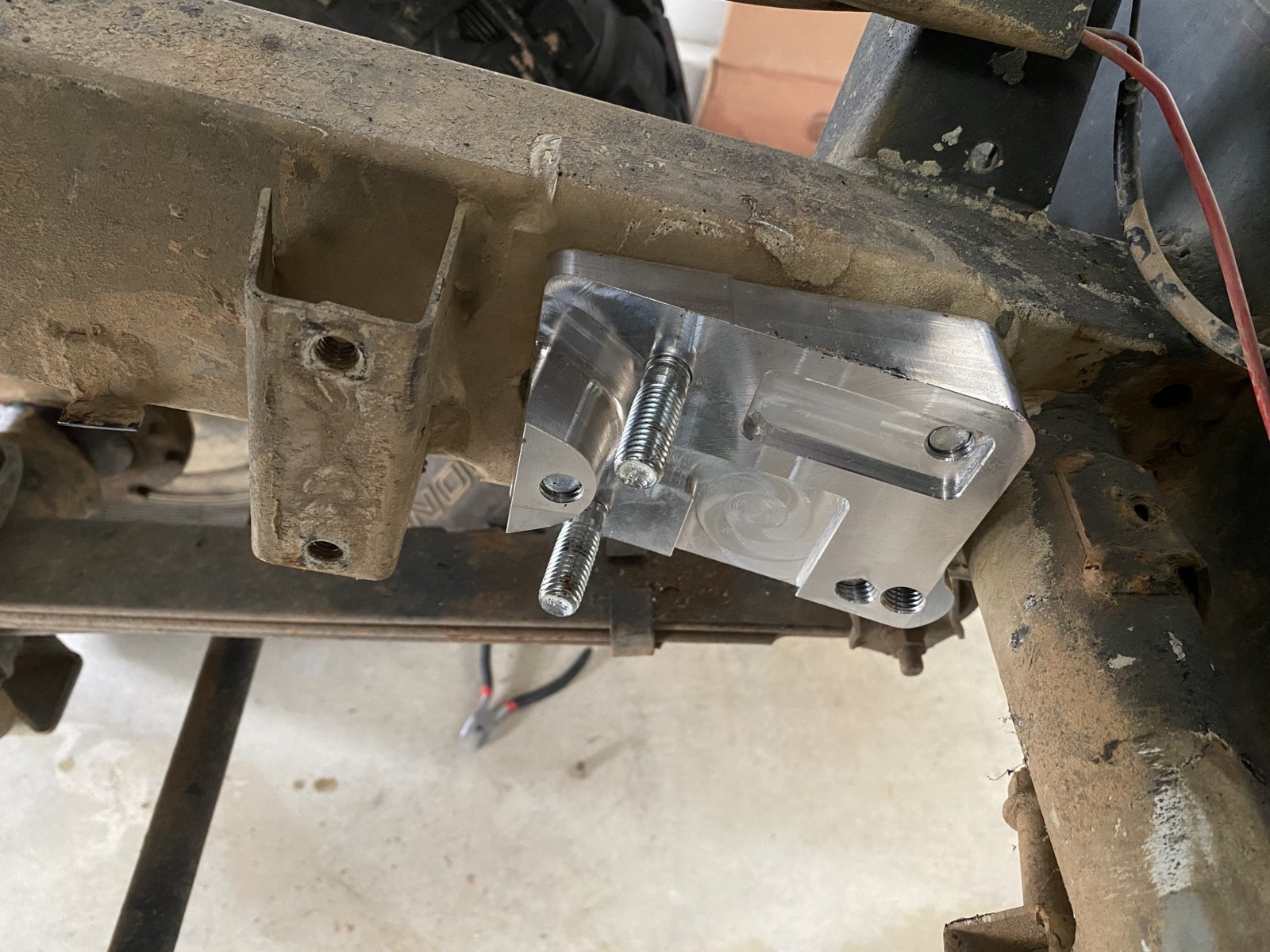

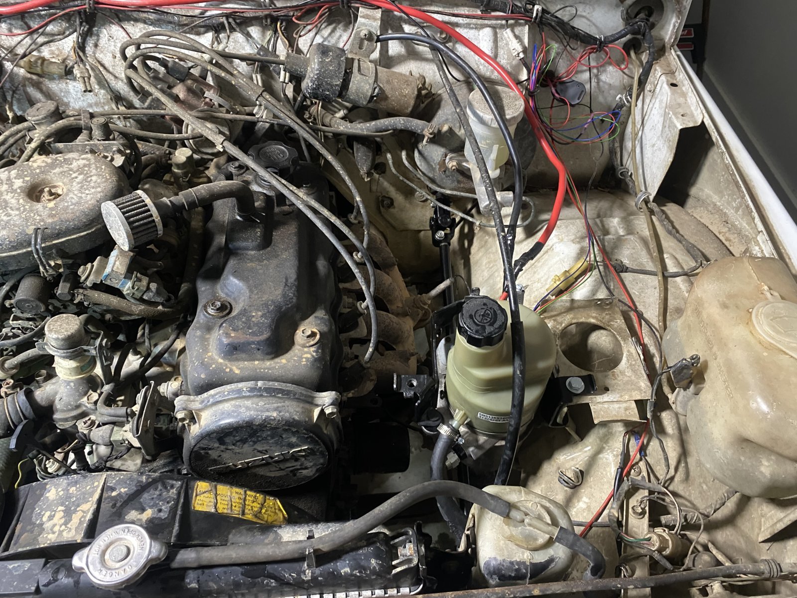

    Changed the steering set up on the samurai.
    Getting ride of the Prius set up and switching it out for a hydraulic steering system. Ended up going with a Volvo electric power steering pump. Paired with a controller kit which allows me to control the speed of the pump. I’m interested to see how this works as I haven’t seen many people try this. I also swapped the steering box for a power steering box out of 96 sidekick.

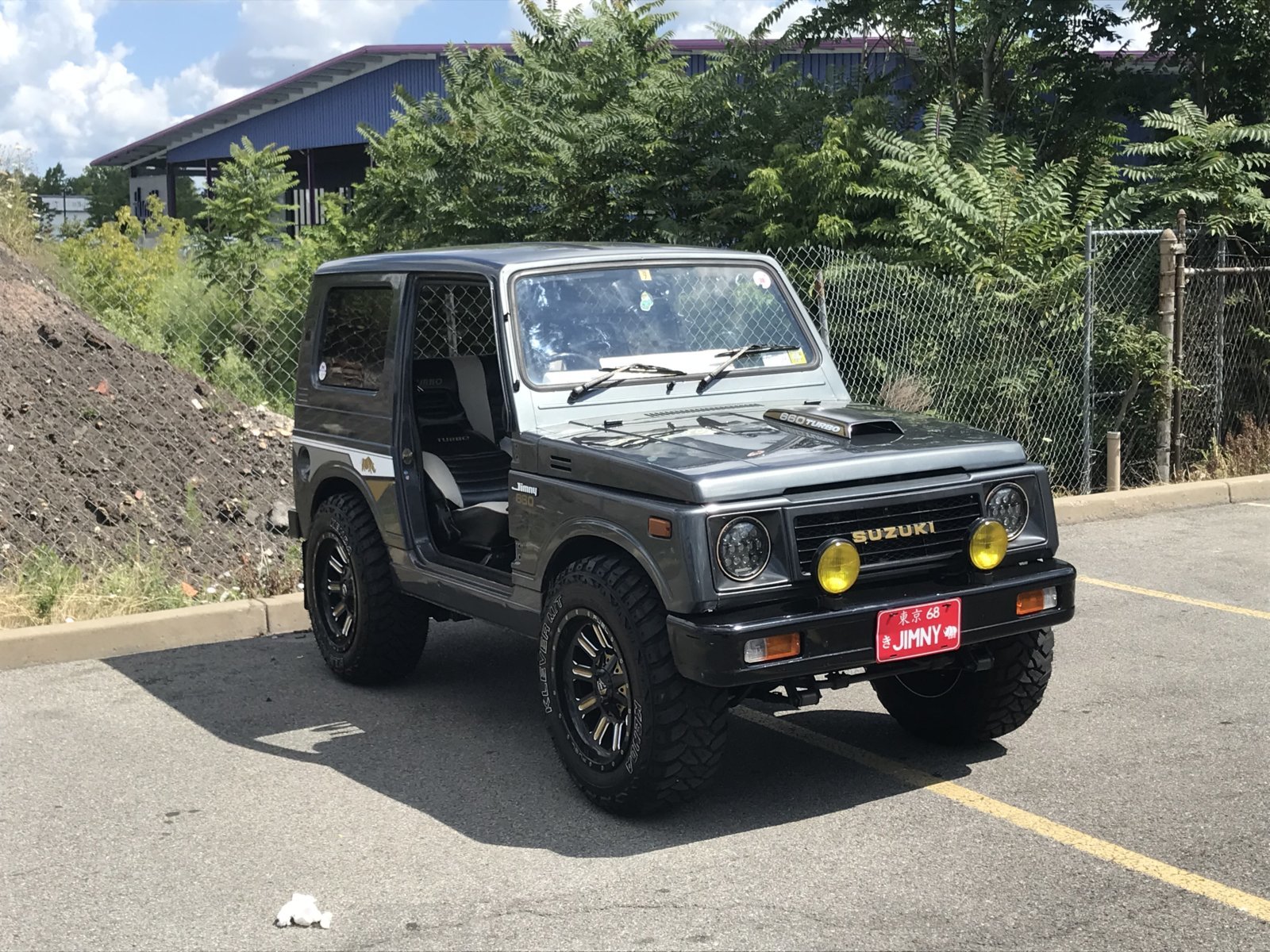

    IMG_1401.jpg Someone local to me is rolling in this..
