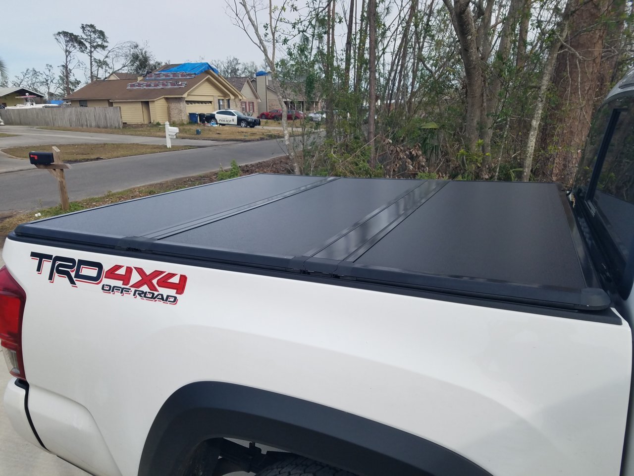

    Review time! Sorry for the delay, it just got here yesterday. See my link above for what I ordered. Think it's out of stock, but maybe the seller has more under a different item. I think one thing I would say is look for a seller that has the correct year groups for what gen cover you want (there was someone selling a 2014-2018 cover. Maybe it would fit, but I doubt their attention to detail.)
    Box opening, seemed reasonably packed, nothing fancy
    Came with weather strip for the tailgate. Overall the weather stripping seems good, and I don't expect much rain to get in sans one area I'll talk about. Extra stripping is nice though.
    Came with all the mounting hardware op mentioned and one extra nut/bolt. As well came with 4 extra rubber pads that were thinner than the ones installed to keep the rear section from rubbing on the front when folded.
    Instructions aren't great but it's a logical setup.
    INSTALLATION: took about an hour. As @j_piper previously mentioned, you need to set the hooks as high as possible and let the handles out as far as you can initially. I laid the cover on, centered it and then started putting the hooks in. Obviously getting them all placed before tightening will save you time/hassle. After tightening the hooks fully I was able to raise the handles a turn or two so there is a little slop but not much.There are hooks near the front to hold the cover when folded.
    They sit a tad loose so we'll see how effective they are. And be careful of the metal clips near your window.

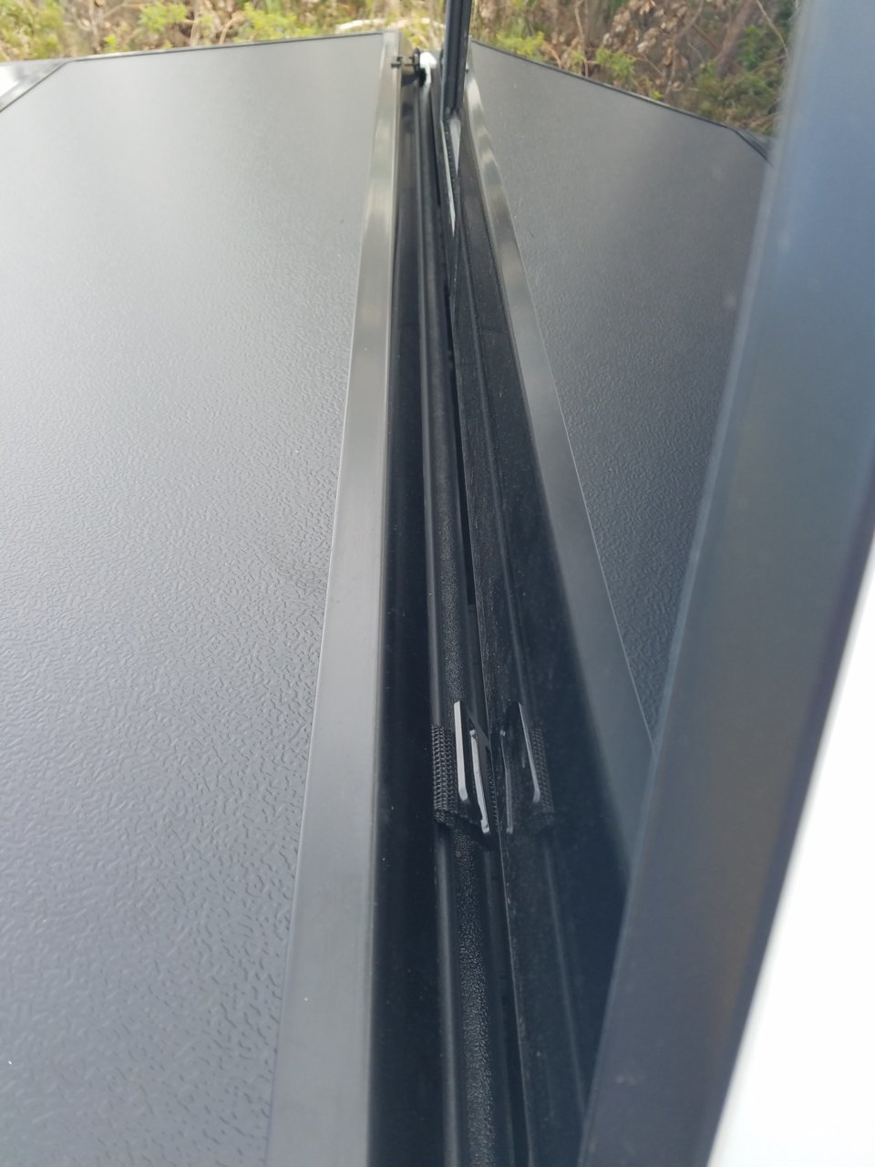

    Only area I may add some weather seal is at the front corners. There's about a 1/4 in gap there but everywhere else seems sealed well. I even tried lifting up on all areas as someone mentioned their Extang cover had a 1/2 in gap to their tailgate when raised. I couldn't raise the cover high enough anywhere to get a gap between the weather seal and the bed. Tightening and placing it well will save you time later. The cover seems like it will provide great security.
    Folded, as mentioned the hooks are there in the front. There are also rubber pads to prevent the folded sections from rubbing.
    Didn't have to modify the rails. For the people asking about cleats, looks like you could use them in between the hooks you just won't have a ton of adjustment options. With a few attempts, I think you can get it on or off in 2 minutes no problem. Tailgate seal is so good it makes a funny sound like Tupperware now when I open close.
    OVERALL: very happy with the cover. For $350 I don't think you can beat this for hard folding cover value. Probably not as top notch as an $850 cover but then again I read some reviews of problems it doesn't look like this one has. Any questions let me know. Hope this helps!

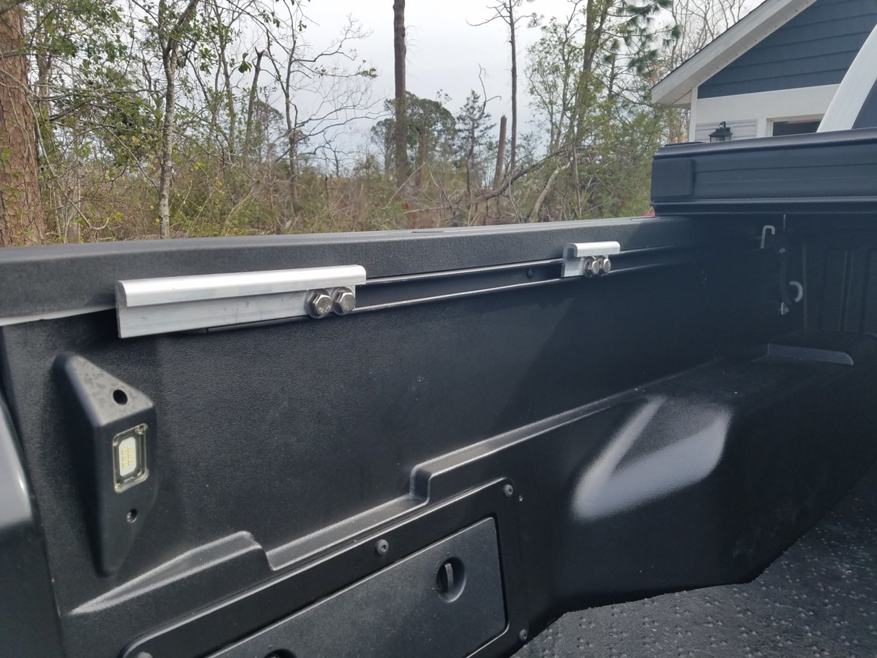

    I agree 100%. The instructions do not say where the longer brackets go, but I figured up front since you first lay it on the bed in the folded position up front to install it. On my truck it made no difference, the 3" brackets would work just fine and still provide about 1/2" wiggle room in either direction. I may drill wide holes in the brackets if I ever need to take the cover off, but for now it will stay as it is.
    I also might get some threaded plastic wing nuts or knobs (if I can find some that fit) and use those to replace the levers under the plastic cam clamp part. Using the lever arms these don't unlock easy because they slide around in the slot on the board above, while unscrewing the wing nut or knob would be just as fast IMO.

    I also used Velcro dots to secure the strap so it won't flap against my window when driving. My version has the metal hook while others have a plastic clip.
    Here is how it looks hooks secured down;

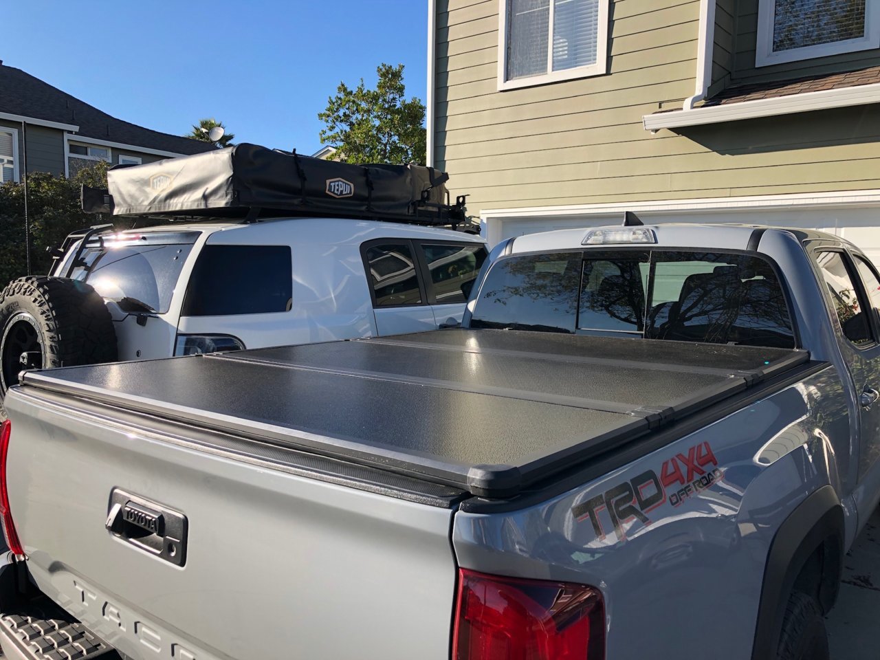

    So the one I ordered is DT Moto brand. All the old links are dead on eBay so couldn’t even see the seller names so I took a chance and am really happy with the cover. Decent for the budget hard tri fold. May try those cleats from etrailer posted above as they seem cleaner. The brackets are slightly different on mine though and are painted black so that’s nice. Blends nicely when not on. Will post pictures this weekend.

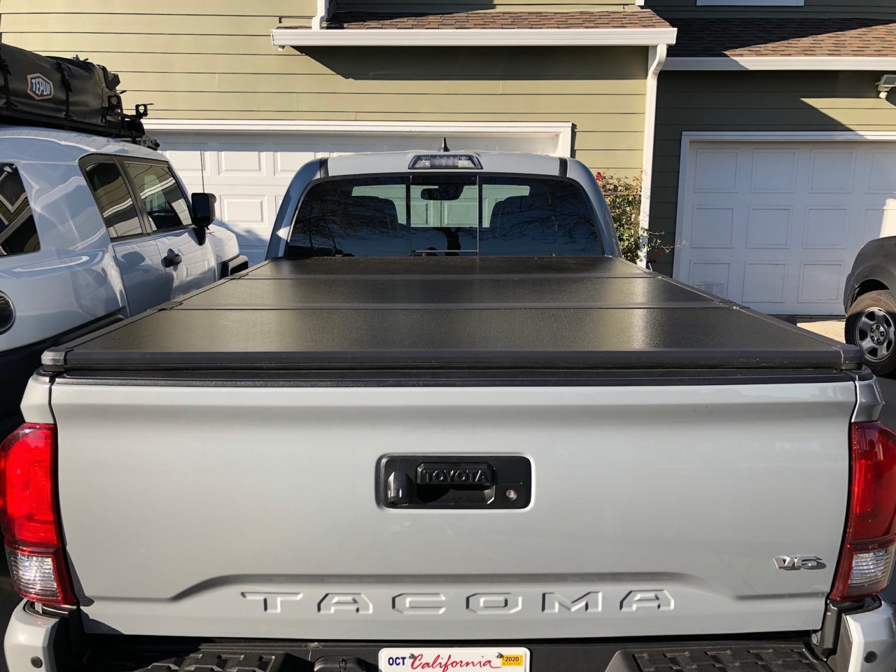

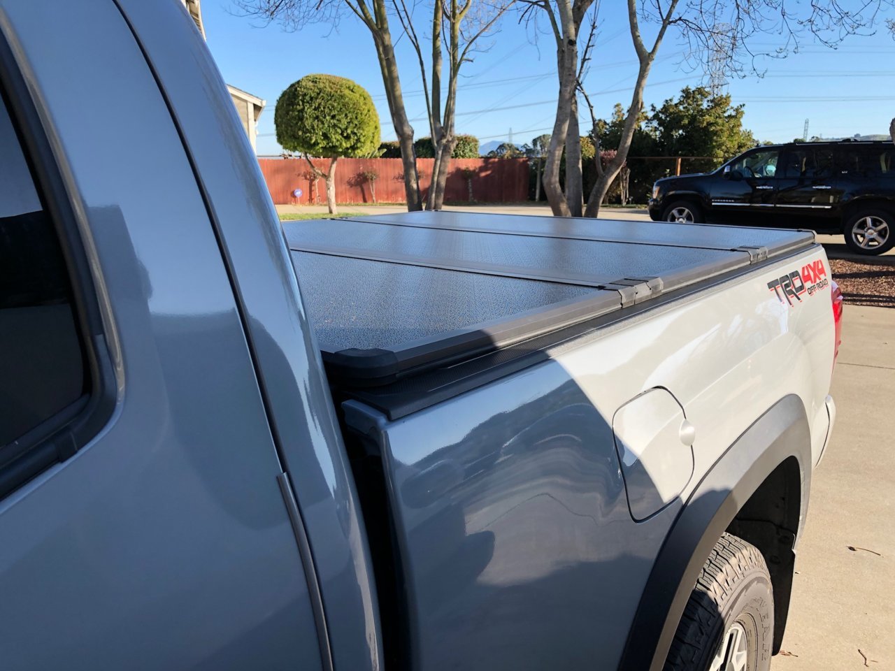

    Here are some pictures of the DT Moto hard tri-food on our DCLB.
    I really like that the retention straps for when it is folded are plastic clips instead of metal. Same with the receiving end near the windows. Give me a little piece of mind incase it comes loose.
    Really nice to have the bed to use as secured trunk space now when not in its open configuration. The electric tailgate lock in combination has been awesome.
