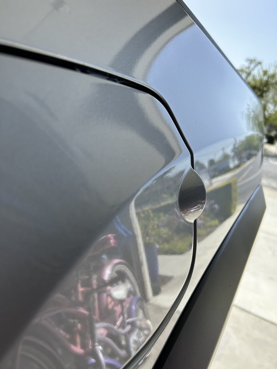

    So I’m the guy making a thread without pics:anonymous: I’ve had my new rig for three months and just noticed the gas door isn’t aligned. Closes but sticks out about a half in when closed on the side opposite of the hinge. Has anyone come across this, possibly like me you ordered the “no panel matches up” factory installed package :thumbsup: Any strategies used would be greatly appreciated. I’m out of town and this is what I’m thinking about, oh the life of a Tacoma owner.

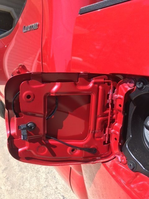

    On higher-time trucks, if the fuel door hinge isn't greased, then it can seize and bend the hinge pin (thin rod) causing this condition. It isn't expected with a new truck not even past it's first oil change interval (where the greasing happens). Take it to the dealer (preferably one with a body shop) for them to either tweak it straight or replace the door & hinge under warranty.

    Here is the best thing to do with that gas cap strap.First thing I done to my truck brand new.There is cap holders you can get for lid.I just set mine on corner of bed.

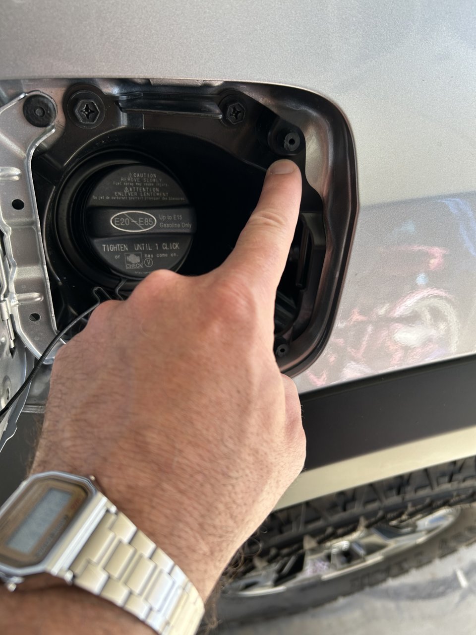

    Ok, fixed. Couldn’t deal with the dealer so I took it all apart. With the plastic surround removed around the cap I could close it fine so I realized it was the rubber bump stops that were preventing it from closing flush. I cut them both with a razor blade and boom, flush. Thank you to all of you who stood by me through this perilous journey.
