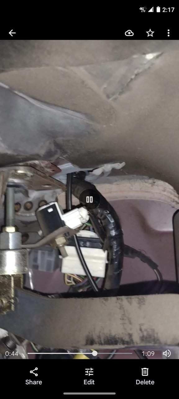

    Thanks to everyone. I'll upload a photo that shows the bracket may be bent.
    The rubber piece is still there (the one that contacts the switch).
    When I get up here in an hour I'm going to wrap some vinyl tape around it.
    If that doesn't work (the internal guts of the switch are broken), then I'll try to pull the plastic wire couple off and jump it with a paper clip. But if that couple fights me and wont come off I got to snip the wires and tape them together.

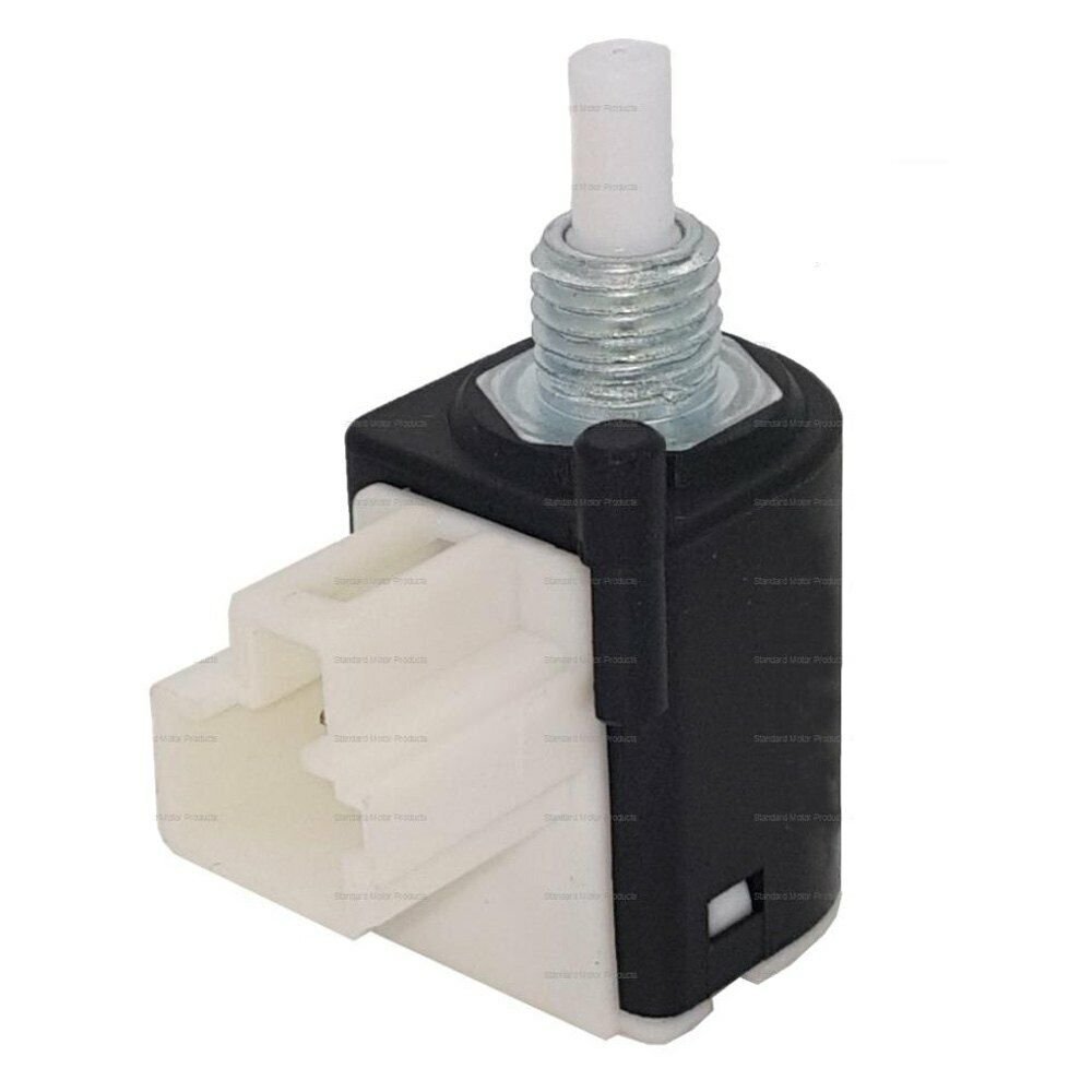

    For what it's worth, replacing the switch is very simple, and the switch itself should be less than one of your Uber rides.

    Wondering how to do that on an AT.......when the NSS goes on them its north of $120.....doubt you get much of a warning either.......although a lot better protected.....
