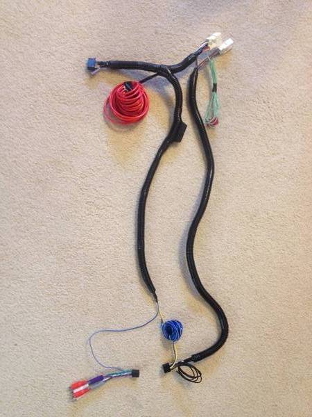

    Here is the wiring harness I created. all connections are soldered, heat shrinked and taped. Isolated the power adn remote wireing from the speaker wires. added wire loom to prevent wiring from going everywhere. still need to add the steering interface to the wirharness but will do that following install and test of the AVHX5500.

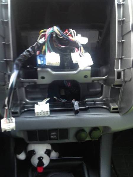

    Removed original head unit. amazing how easy this was..

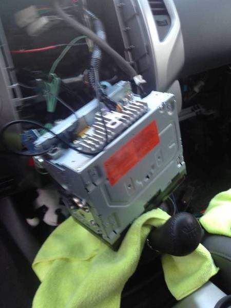

    Have the amp and AVH X5500 roughed in. Installed the ASWC-1 steering wheel interface and tested, all functions of the steering wheel worked perfect. Synced phone and tested the X5500.
    For anyone who is deciding on getting a deck and getting speakers later let me tell you there is a huge difference with just the stock speakers. I cant wait to hear the difference with the Polks and SO B8pt. I am hoping to get the speaker brackets and the parking brake bypass tomorrow so I can complete the install.

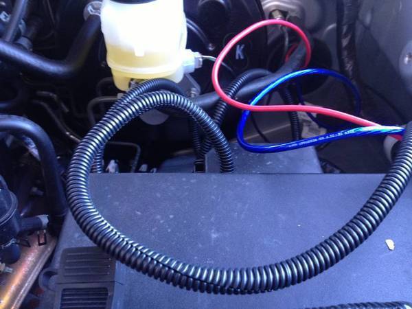

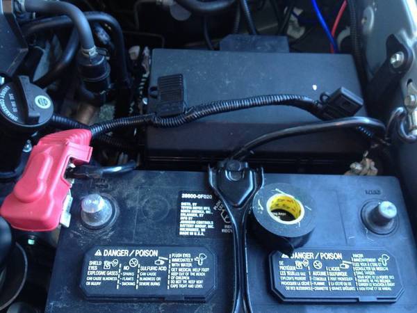

    Finished running all of the wires it wasnt to bad but doing it in upper 30 deg weather tends to slow down progress and require alot of hot coffee breaks..LOL It looks good so far in eng comp wiring looks stock and is not noticeable. here is the wires run I will take another pic once complete.
