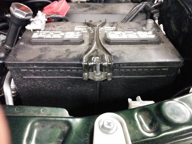

    I've got a 2013 DCLB that just went in for the lift and lockers, it's got 6k km on it, the only work that had been done to it prior to the lift was toyota dealer installation of my supercharger. Well the battery dies while on the hoist when getting the lift installed. The shop showed me the issue. As shown in the picture the battery hold down had been SEVERELY over tightened by the dealer when installing the supercharger. I've since got the pelfrybilt battery box and the dealer is replacing the battery free of charge... Basically them over-tightening it caused the top cell to collapse...
