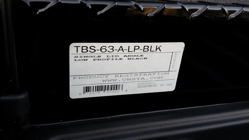

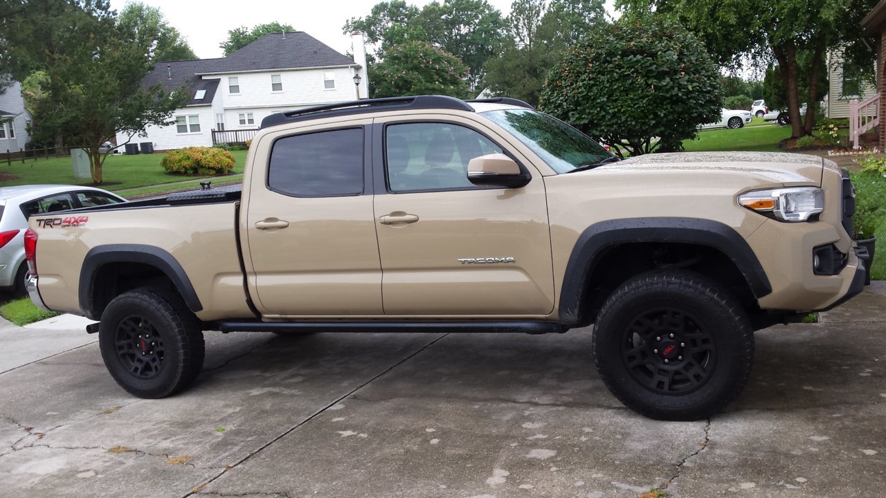

    I have a 2016 longbed and it requires a 63 inch UWS toolbox.
    I have a 60 inch on my 2004.

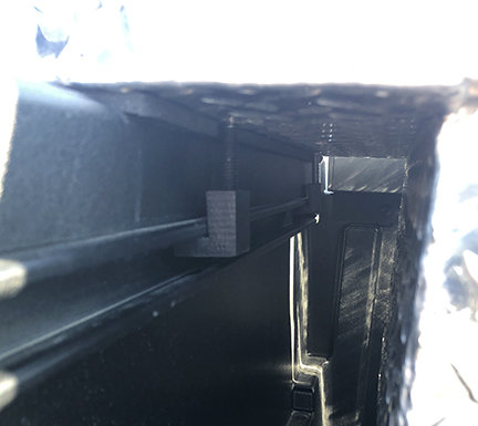

    I have a 2018 DCLB and put on a 60" toolbox because I did not want it going to the outer edge of the bed. 63" if you want it all the way to the edge. I was told by some UWS dealers I'd have to get a beveled one but that was not true. I also got a DeeZee mounting kit and dipped it, you can barely see it.

    I bought a UWS 63" crossover truck toolbox that fits all the way to the edge of my '19; the UWS part number is TBS692.
    I used the J-hooks that came with it to attach to the rail on the inside sides of the truck bed; I upgraded the 1/4" washers to a larger SS size and the 1/4" nuts to SS nylocks.
