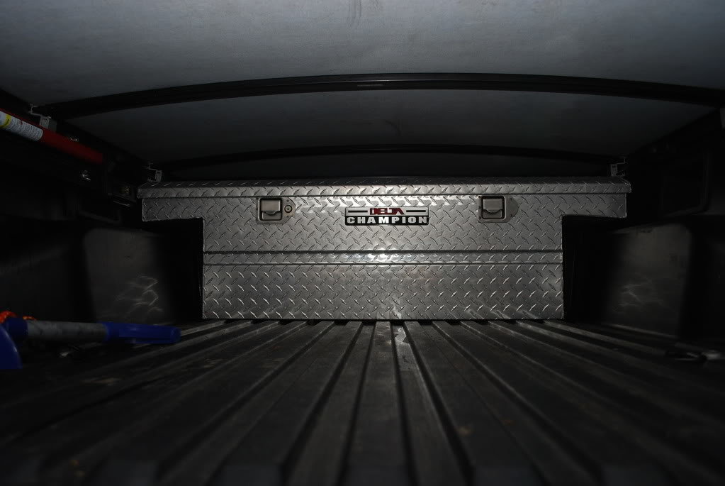

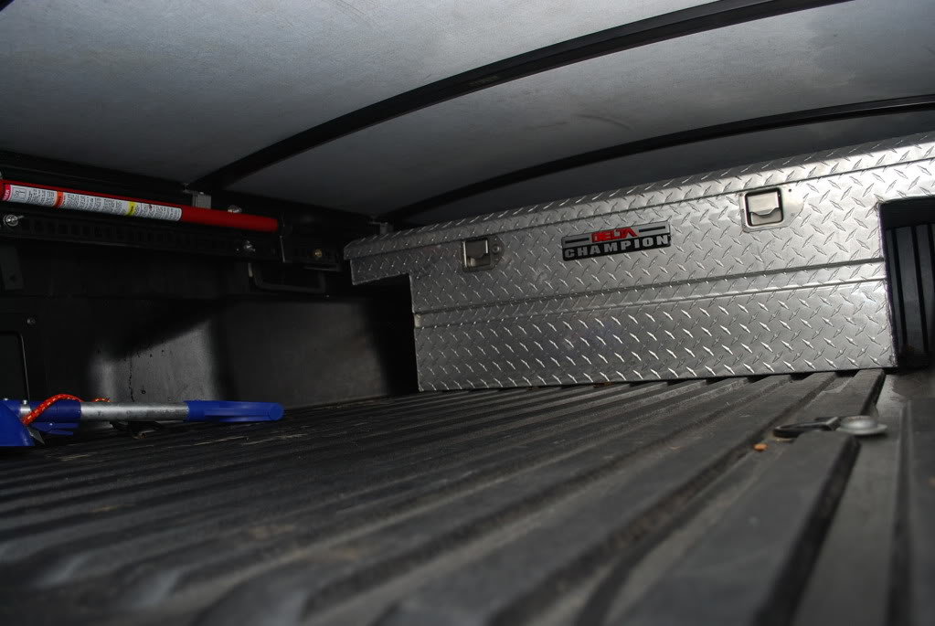

    still have about 5" in the box, and the toolbox has enuf space for a toolkit, all my recovery gear, winch gear, hi-lift gear, a portable compressor, and I still have room left.
    its easy to mount, just popped it in place, drilled 4 holes, and then dropped in a bolt with a flat washer and a rubber washer, and then crawled under the truck, and flat washer and a Nylock nut.
    Its secure, and hasnt moved about with any of my wheeling.
    Sorry theres no pics without the cover, but i was too lazy to undue the cover.

    thanks for the pics. with the cover was actually better because it gave me a better idea of clearance. Thats more than likely the box i will end up getting unless the cardomain guy emails me back. for the price, i probably cant get one made cheaper, and i dont have the ability to build it.
