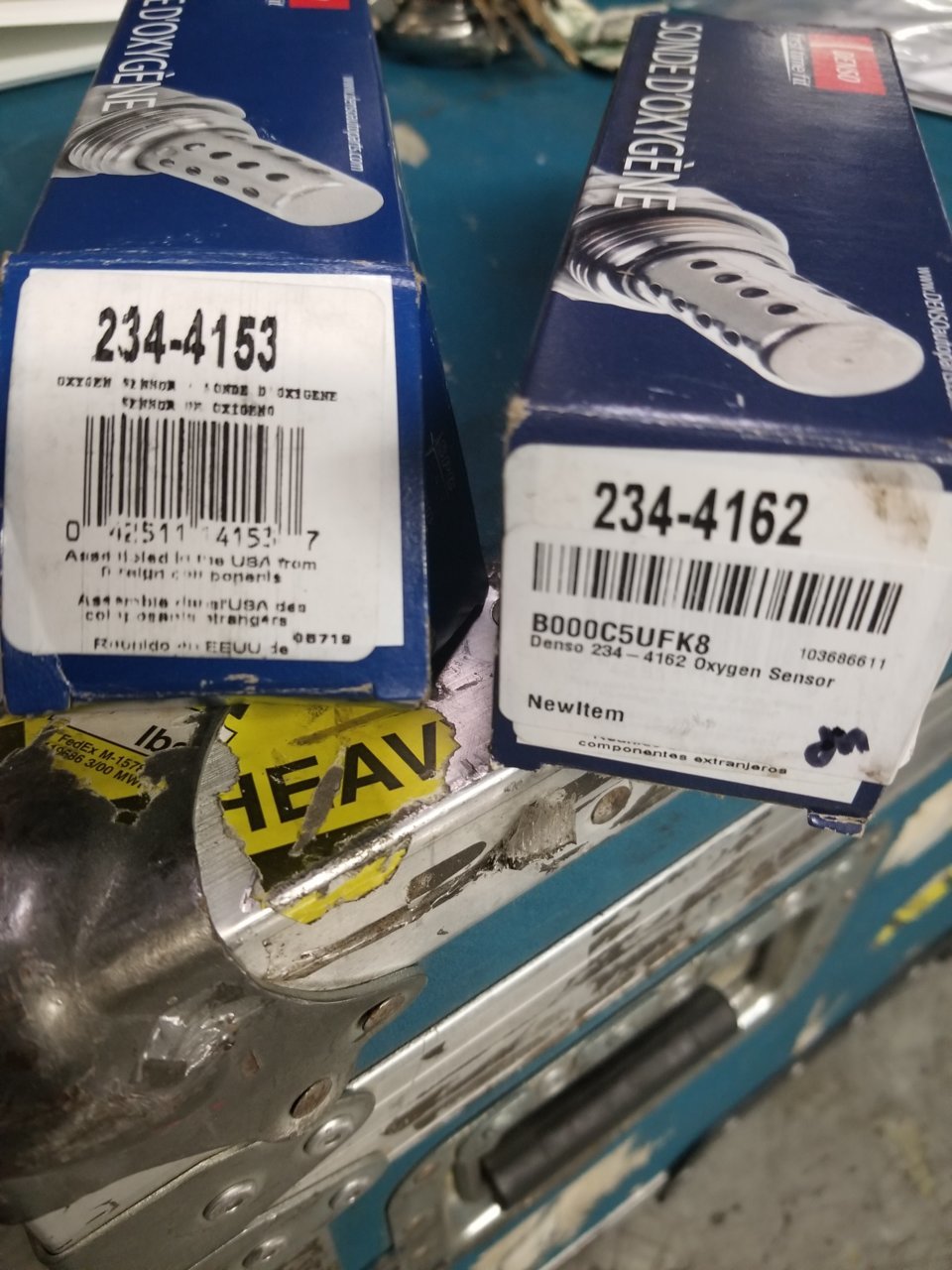

    The worst p0172
  10. Sep 22, 2019 at 9:08 AM
    Dammmm
    Dammmm [OP] Well-Known Member
    Oct 17, 2018
    #269768
    54
    martin
    1999 toyota tacoma v6 3.4l rwd extra cab per runner
    I need one that can kinda point me in the right direction. I replaced to many parts . The mass airflow sensor. O2 sensor upstream and down stream. 15691684141783939323438995276385.jpg

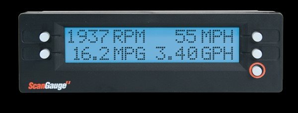

    Scangauge II is what I have been using.
    What I like is that this gauge can attach to a readily visible point on your dash console with any backlit color you want to program.
    I just updated their most current software 4.5, which gives you more "X-Gauge Commands"; a format allowing you to program protocols to read anything that the vehicle computer puts out. Thats where your limit is on what these will tell you.
    I got a second one for my other car on Ebay unused for $35 but had to pay $25 to update the software. New ones start at $135.

    You mean scanguageII. And if you mean temps, pressures, etc. how could it not?

    i should have posted this above, its a list of available codes for the scangaugeII
