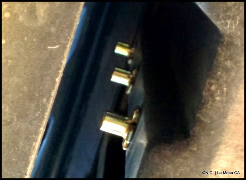

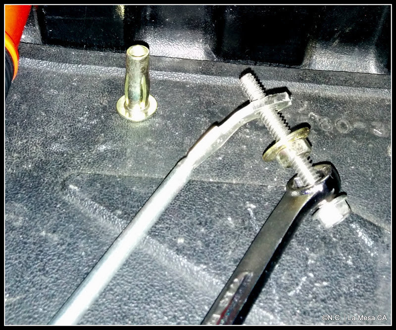

    I went the cheap for the install tool. A 2"x1/4-20 bolt, nut and 2 fender washers. I also used a piece of flat steel to keep the rivet nut from spinning. Two 7/16" box wrenches. Place a little oil onto the bolt threads to help the nut from binding. This work great for 10-12 rivet nuts before you will want to replace the bolt.

    Looks good David. Nice pics. :D

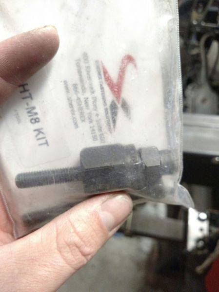

    Here is a picture of my home made tool:
    I did break a few bolts and foul some threads (because I mixed different hardware (galvy/stainless/grade-8)), but I just swapped out for new ones. I tried pretty hard to find a full threaded grade-8 bolt, but I could not find one. Anyways, I'm real happy with how mine turned out.

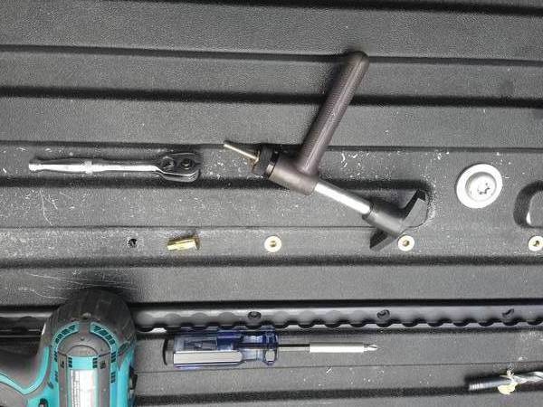

    Best 1 I've found....
    Also from McMaster Carr

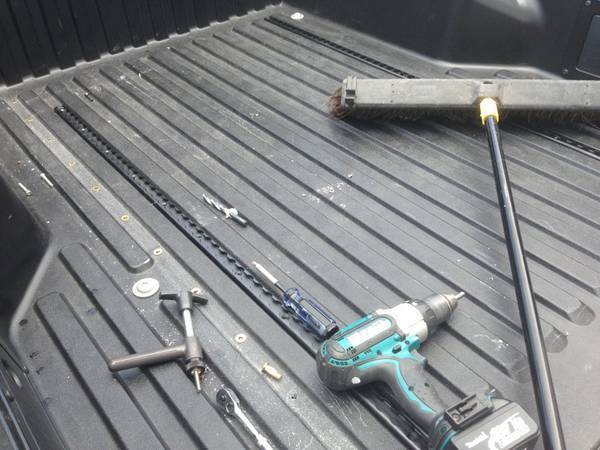

    I bought this one a couple years back, along with about 100 6mm rivnuts, I knew I'd be using it a bunch for various projects and I wanted a tool to save time on those little buggers. It's paid for itself several times over. I used it the other day to put 8 rivnuts in my bed for a bedslide project, between drilling and installing, I was done with that step in less than 5 minutes.

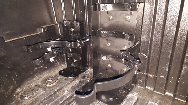

    I used the pre bulbed rivnuts (per @Crom suggestion) as they have more space between the face and the crimped part. The listing says for .28-.50", but they seemed to grab the bed pretty good. The regular rivnuts seem to be for sheet metal and stuff a little thicker, like 1/8". I'm using the prebulbed ones to mount my co2 and fireX
    Edit regular rivet-nuts are for the following thickness "sheet metal grip range: 26 – 13ga" 13g is 3/32"
    Amazon has lots of different grip ranges available these are the ones I used (.28-.50")
    https://www.amazon.com/gp/product/B010GQXMAW/ref=oh_aui_search_detailpage?ie=UTF8&psc=1
    These might work even better as they have a grip range of .02-.28"
    https://www.amazon.com/S25MG280-PRE...rd_wg=Sj2tx&psc=1&refRID=6A0SFK4AEC4YX3Z5RWNB
