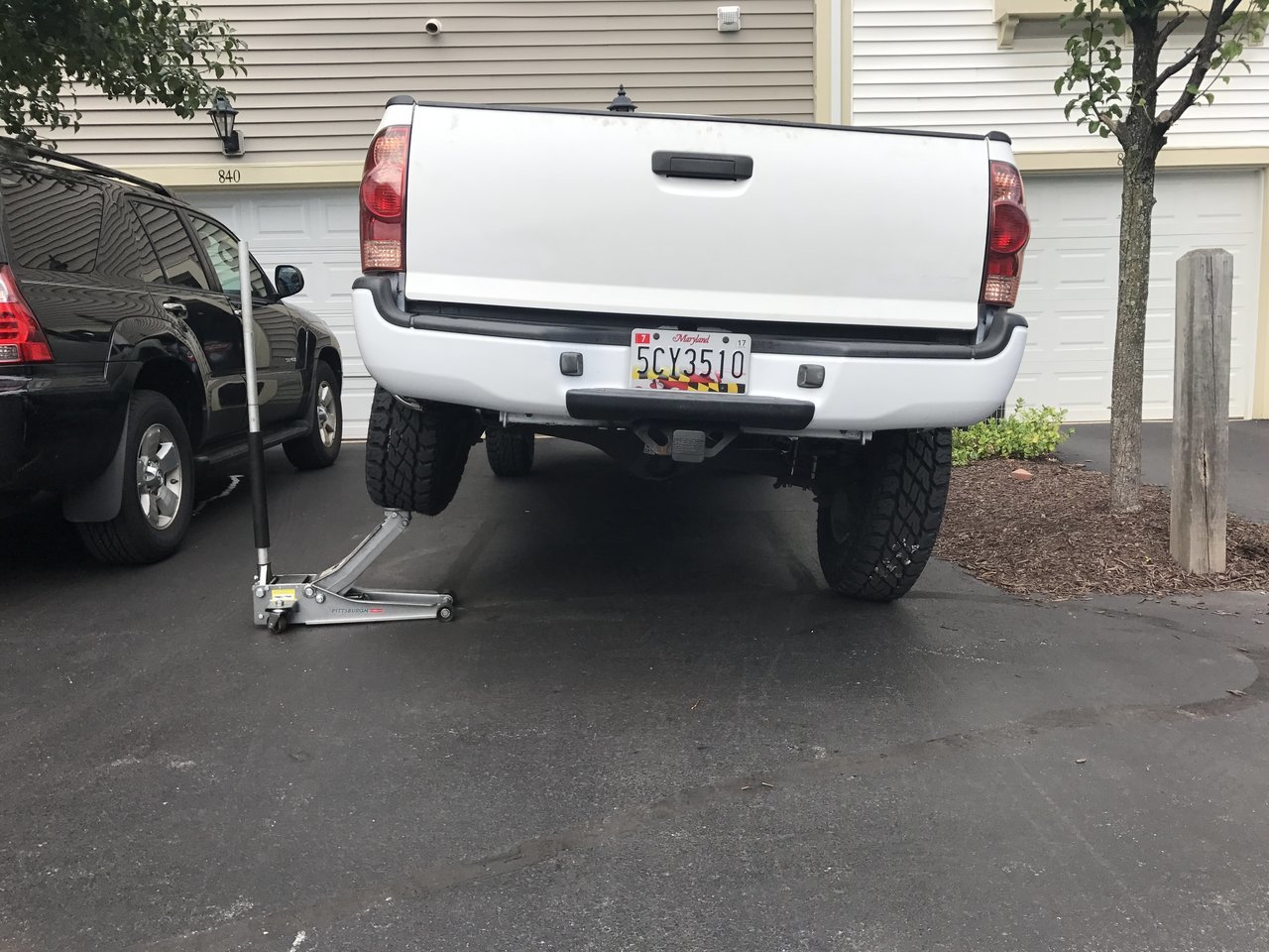

    I highly recommend getting a better jack, like the harbor freight one. You can get coupons online and it makes only $10-$20 more and lifts a lot easier and feels a lot more stable. Here's a pic of the type of jack I'm talking about.

    #40
    EatSleepTacos
    Mar 24, 2015
    #151688
    59,651
    Randy
    West Valley, AZ
    2017 4Runner
    Yeah, we've chatted before in that thread! I've had the other type of jack before, and this one is leaps and bounds better. It's heavy as shit, but so stable.
