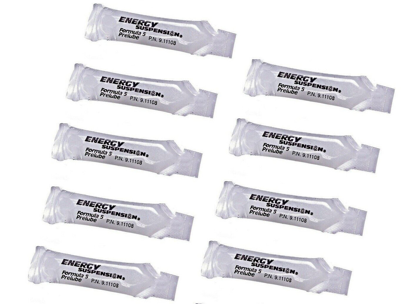

    That 4600 setup is whispering my name, seems simple enough..
    What is ES grease? Ill pick some up

    Sorry . . . Energy Suspension (brand.) It is silicone based. Petroleum based grease/oil will accelerate the deterioration of rubber. A sloppy oil change or a leak can blow back to the steering rack and rot out the bushings. ES grease is super sticky as well.
