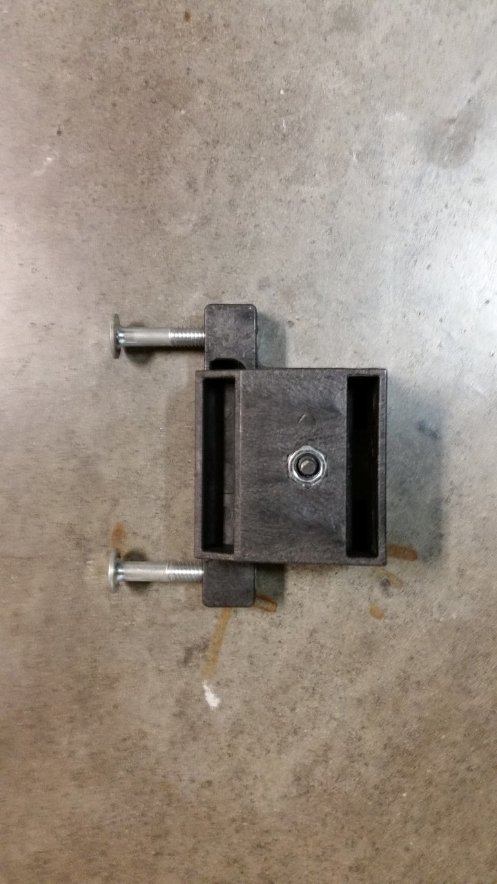

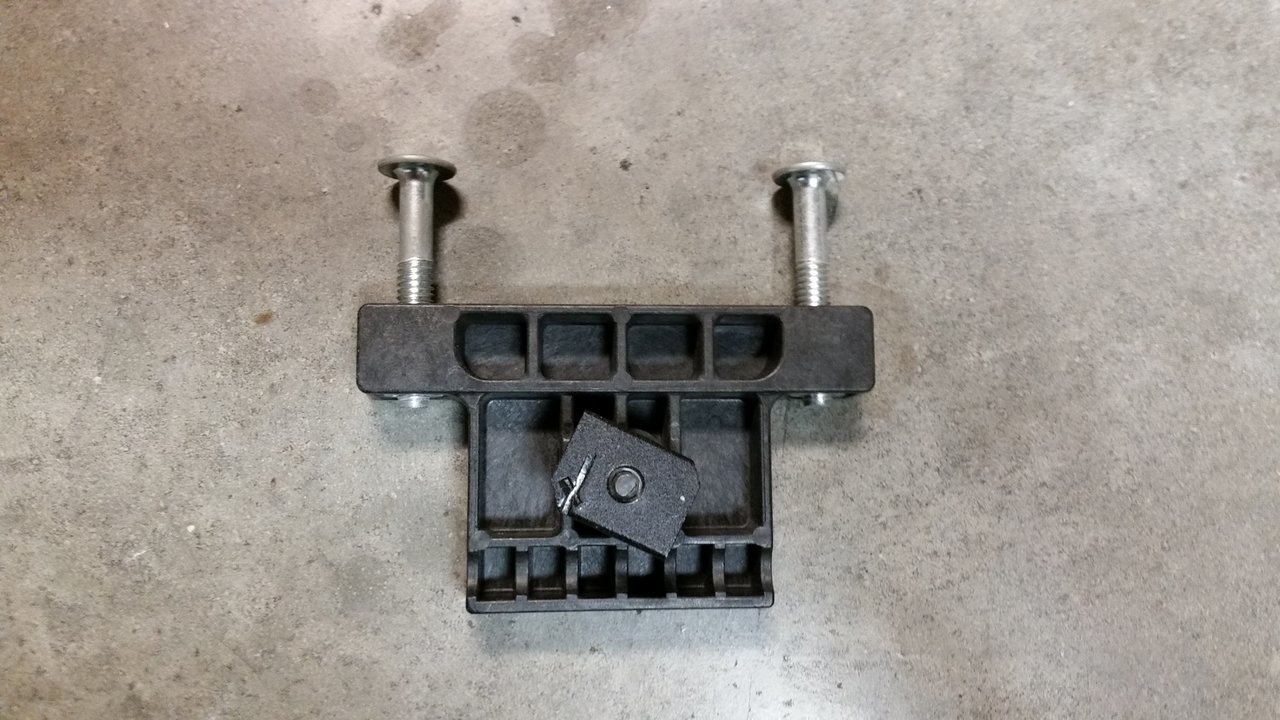

    Never much cared for how most people mount crossover boxes with j-hooks.
    When I had a crossover, I used the Better Built Grip Rites bolted to the side rail with T-nuts.

    How did that work?
    I picked up a black Kobalt box new for $150 and want to mount it securely.

    It's two pieces per side; meant to pinch under the bed rail.
    I only used one piece per side; bolted to the bed rail with either a spring nut(sans spring) or t-slot nut.
    2 piece
    1 piece

    Where did you get the t slot nut? I got a u-bolt that had the piece of metal jussssttttt big enough and in my haste of not having proper nut I may or may not have JB welded a nut to that panel to fabricate my own t slot nut lol.
    Theres an old post showing someone used part of a Leer mount and Im going to check a topper store in my area on my next day off.
