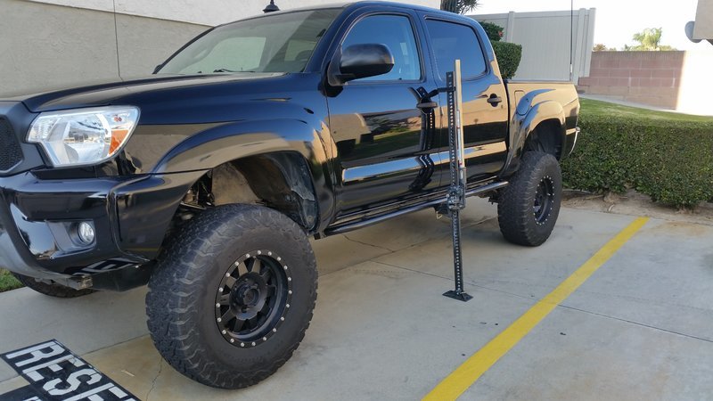

    digitaLbraVo
    digitaLbraVo Derka Derka
    Sep 6, 2012
    #86398
    7,514
    Covered in stickers and chrome stick-ons for extra horse torques and foot powers. Icon sticker gets me tons of travel, dozens of milimeters.
    You can see pretty clearly in this picture how much of the inner plastic lining I've had to trim up, I also had to cut out the inside line of the plastic flare that has the holes for the mud flaps to hold onto.
