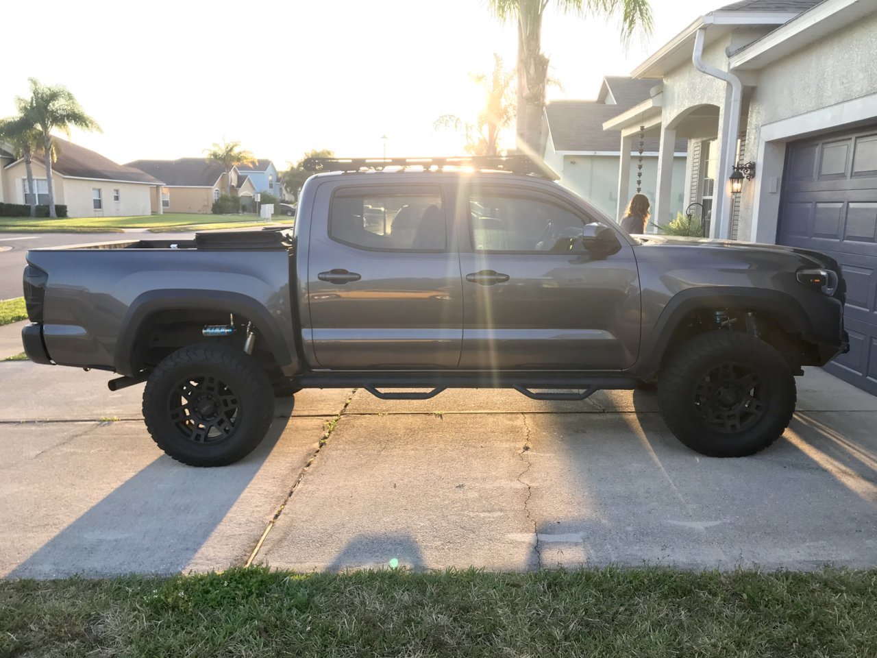

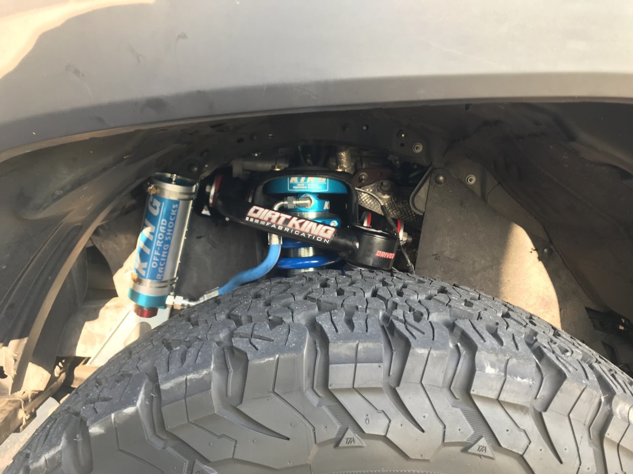

    I’m dead but it’s complete!

    Nice work. Nothin' to it, but to do it.
