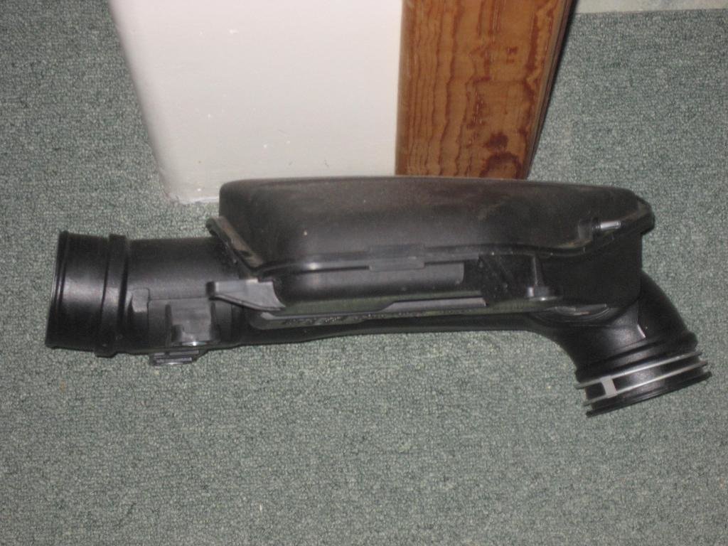

    As far as I know, it still doesn't because no one has yet figured out how to make it fit with the throttle body moved 2 inches to the right.
    0b4f7bcf-06aa-4fab-ab10-61e7049e85fe_zps_0a21089d86d3f8cc504e318d4e9c752d8fd508ed.jpg
    Got any ideas? Post 'em here. ;)
