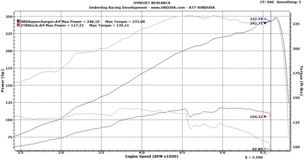

    Does the 2.7 have a top end past 4000rpms?? It just seems to tapper off in mine.

    Taken from URD website, this is their Dyno of a stock 2.7L I4.
    The bottom two red lines are stock HP and Torque ratings:
    So you are quite correct, there is quite the drop off. Tooters stock Dyno should follow a similar trend.

    Well, that's my honest impression. It ~feels~ like it doesn't have any top end. But then again, the 2.7 didn't have top end before. We'll know for sure on the dyno. :)
    The slow turning industrial 2.7 is an economy engine, and will never be a high performance engine because it was not designed to be one. This is why no one makes "speed" parts for it. Anyone who wants more horsepower simply buys a 4.0.
    When I'm driving, the engine hardly ever goes above 3,000 rpm, so the goal of this project is to enhance the normal driving range, and was not intended not to be a high performance product.

    That curve shows the purpose of the design of the 2.7:
    Economy.
    People who buy it, do so for the better gas mileage. Whose who want more power and speed buy the 4.0.
    And look... the normal driving rpm range isn't even on the chart. I'd bet that the stock 2.7's torque curve is really good in the low rpm range of 1,000rpm to 2,500rpm.
