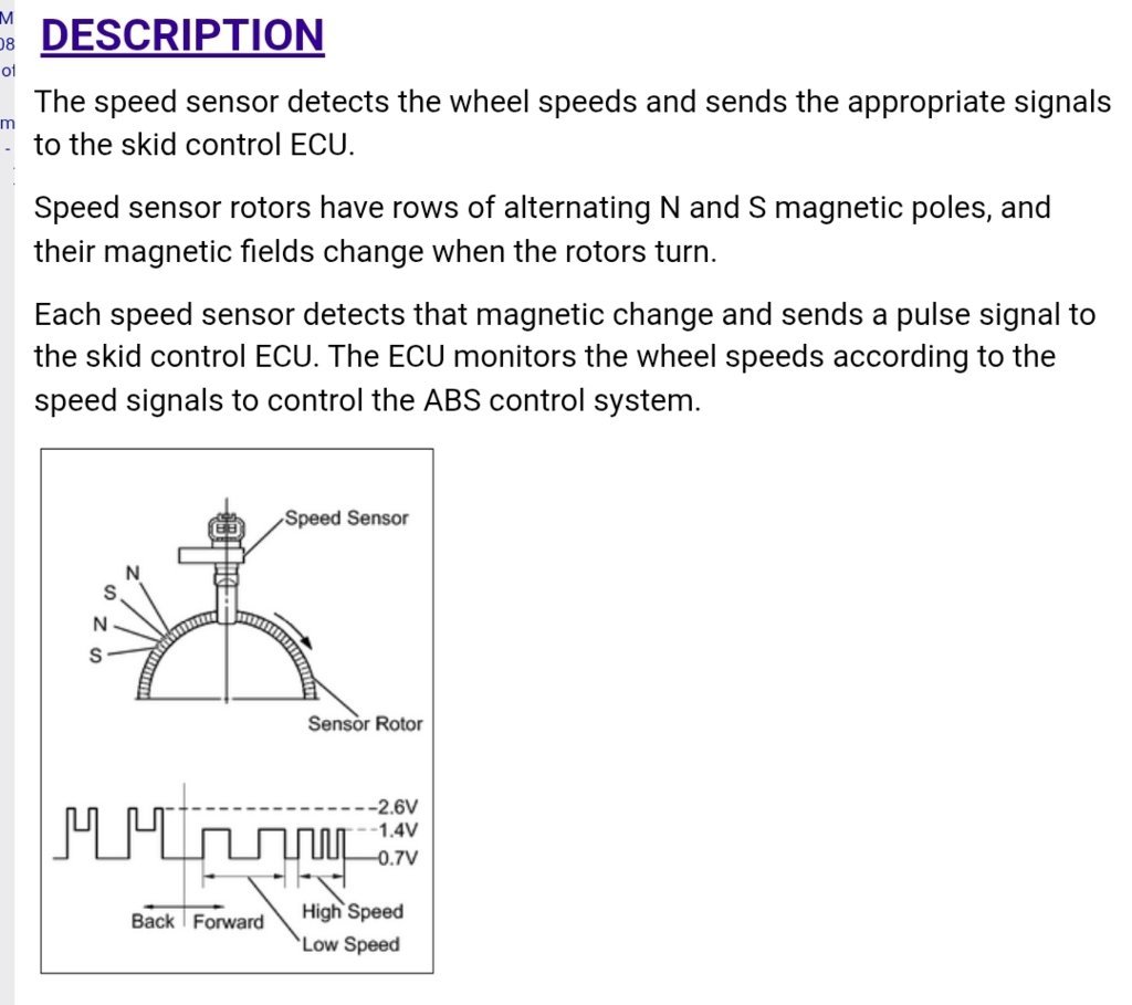

    I'm swapping rear axles and want to have a custom tone ring made to press onto the shaft. It looks like the rear tone rings on the 2nd gen are somehow incorporated into the bearing and don't have visible teeth. Does anyone know what the tooth count would need to be to make the ABS happy?

    Teeth wouldn't work, the tone rings are alternating magnetic poles and it doesn't give us a "count".

    Dang. I wonder if there's a way to cannibalize a bearing and put the magnetic ring on the shaft somehow.
