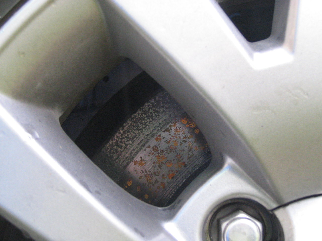

  10. Sep 8, 2017 at 10:55 AM
    #30
    gwozdz
    gwozdz [OP] Member
    Jul 5, 2016
    #191249
    12
    John
    Way Upstate New York
    2016 SR5
    Here's what I am looking at. Its the area you can see between the holes in the wheel.
  11. Sep 8, 2017 at 11:17 AM
    #31
    127.0.0.1
    127.0.0.1 AKA ::1
    Dec 24, 2012
    #93641
    3,915
    /etc/hosts
    2013 NBM AC 4.0 4x4 Auto OR
    YUP, that is brake pad missing or failure. warranty work ASAP.
    if the disc brake piston is the thing scraping (sure looks like it) they OWE
    you a whole new brake caliper, not just pads. that is big time serious problem
    when piston scrapes disc...metal dust can work it's way back along the piston and
    the brakes could suddenly fail or lose fluid with zero notice and ...that is extrmeely
    bad.....

  12. Sep 8, 2017 at 12:51 PM
    #32
    Toyoland66
    Toyoland66 Well-Known Member
    May 10, 2013
    #103918
    416
    Colorado
    09 GX470
    Mostly stock on 35s
    Take off the wheel and look at the caliper...
    FFS 3rd gen....
    SeanDub likes this.
  13. Sep 8, 2017 at 12:52 PM
    #33
    Toyoland66
    May 10, 2013
    #103918
    416
    Colorado
    09 GX470
    Mostly stock on 35s
    And its a 2016, how many miles?
  14. Sep 8, 2017 at 1:09 PM
    #34
    127.0.0.1
    127.0.0.1 AKA ::1
    Dec 24, 2012
    #93641
    3,915
    /etc/hosts
    ....................................>>>>>>>>>>>>>>>>>>>>>>>>>OP had just over 6k miles when I notice this
  15. Sep 8, 2017 at 1:29 PM
    #35
    gwozdz
    gwozdz [OP] Member
    Jul 5, 2016
    #191249
    12
    John
    2016 SR5
    It's a 2016, bought it in June 2016 and I have just over 6700 miles now.
  16. Sep 8, 2017 at 1:37 PM
    #36
    Doggman
    Doggman Well-Known Member
    Sep 8, 2015
    #163722
    2,544
    John
    Alabama
    2017 TRD OR MT
    Dang. The rust is fine. That always happens after rain but something is definitely not right. The entire rotor should be shiny and worn...not half of it. First place to look is the brake pad on that side of the rotor...if there even is one.
  17. Sep 8, 2017 at 1:42 PM
    #37
    pjensen641
    pjensen641 Well-Known Member
    Nov 22, 2016
    #203045
    695
    Boone, IA
    '17 MGM ACLB Sport Manual
    Are both front rotors that way or only drivers?
  18. Sep 8, 2017 at 7:29 PM
    #38
    gwozdz
    gwozdz [OP] Member
    Jul 5, 2016
    #191249
    12
    John
    2016 SR5
    Both fronts.
  19. Sep 8, 2017 at 7:44 PM
    #39
    shakerhood
    shakerhood Well-Known Member
    Aug 9, 2015
    #161370
    37,117
    Southern Ohio
    2017 MGM DCSB Off Road, 6 Speed MT, P&T
    I would take it back to the dealer for sure.

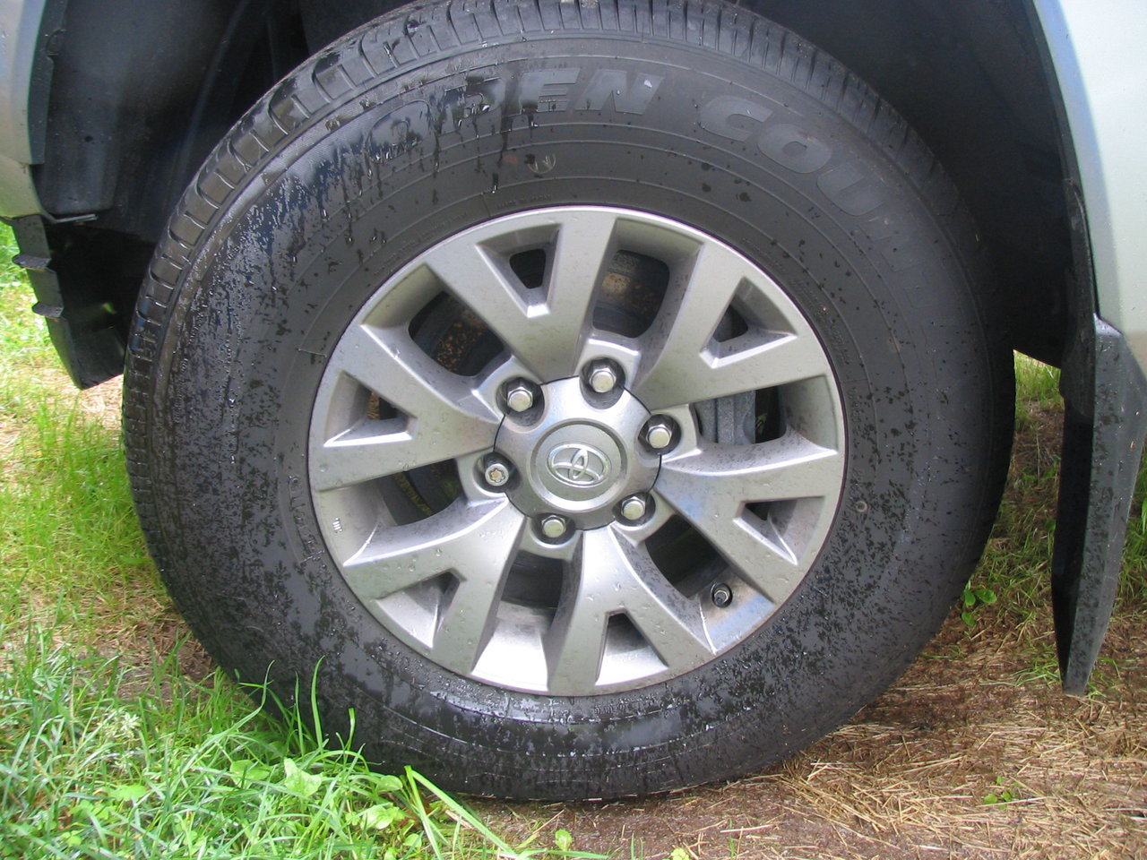

  20. Sep 12, 2017 at 9:36 AM
    #40
    OdiN1701
    OdiN1701 Well-Known Member
    Feb 19, 2017
    #210998
    1,975
    Colorado
    2017 Quicksand TRD OR DC SB
    And updates OP?
