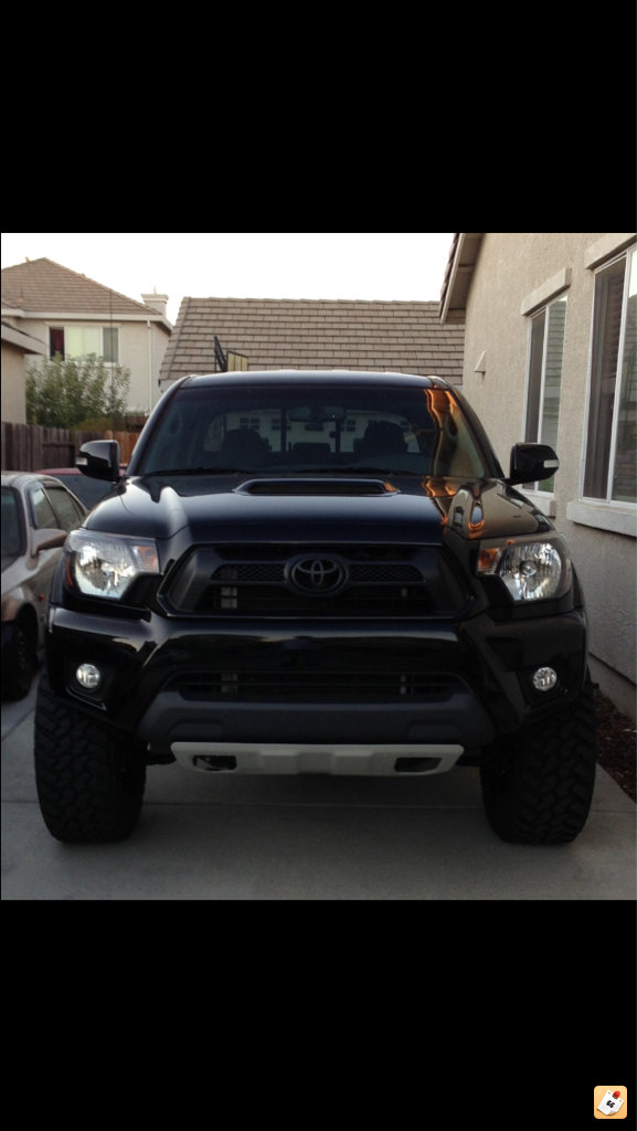

    My taco doesn't have that lean yet! Adding that spacer would cause it to have a lean at this point! If at one point it does start meaning, I will just add it on.mypu5e4y_2250b2fadc04e116d66b61c5d53a16397061a01e.jpg
    As of right now it sits level

    Have you measured ?
    Looks like the driver side is lower to me

    Yea, I see it too. Fill your tank up and measure

    No I haven't but if it is sitting lower, then I always have that spacer for just in case. On my 06 tacoma off road DCSB it was noticeable. Not much on this one
