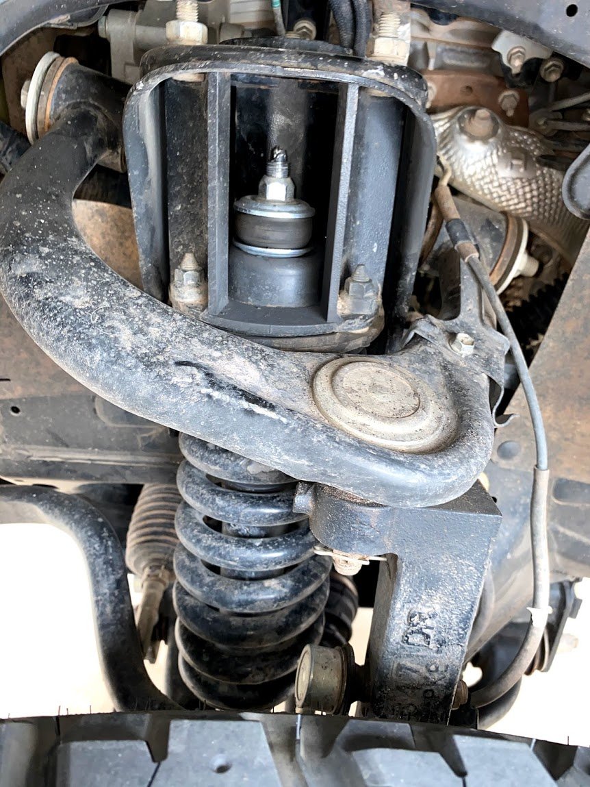

    My First time off-roading, the front driver side strut broke at the top AND bottom. Local mechanic installed two new Duralast struts from AutoZone on both front tires.
    Here is new strut install

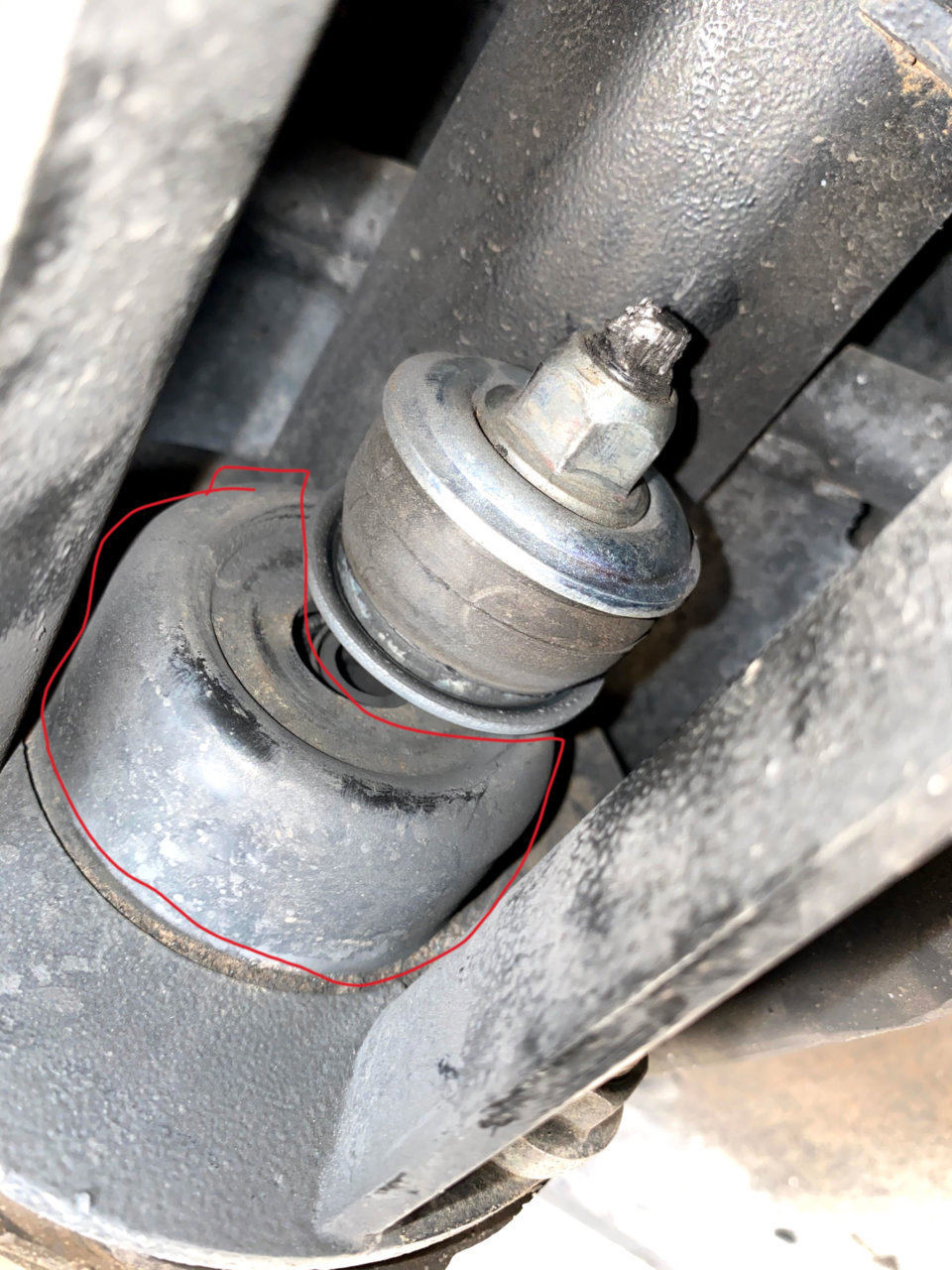

    6 months later - I hear a lot of squeaking noises - Toyota Dealership said my front passenger side strut was loose at the top and has caused damage to the custom lift part.
    In the image above, the strut is loose at the top.. it has pushed inwards and bent the metal in on the part circled in red. What the heck is that part? At first I thought it was part of the lift kit.. but then i started realizing it might just be the Strut Mount Kit that got damaged? Couse that part is only $80. However, the custom/welding repair shop quoted me $1450 for two new struts and welding repair on both sides.
    What do you guys think? If it really is just the Strut Mount Kit damaged... and all I need is a new strut and new Strut Mount Kit... then I can just take it to a lift shop for a new install right? I might even ask them to remove the Strut Spacer and just put in a lifted Strut...

    Quote:Local-mechanic installed two newDuralast struts fromAutoZone on both front tires.
    I would take back to local mechanic and show pics, the strut was not even tight to start with..

    I would, but I can’t, the damage and repair was done in Mexico.
