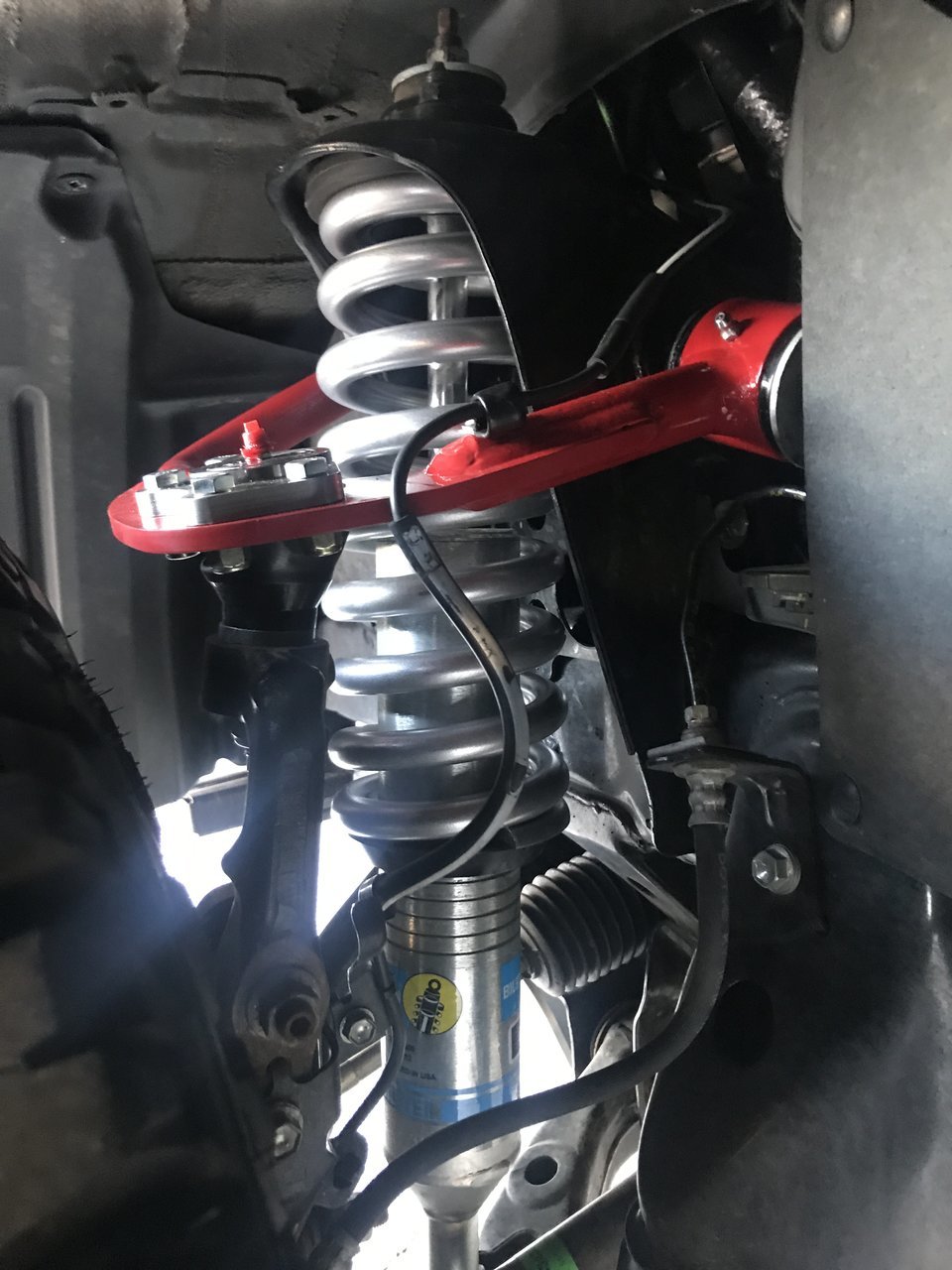

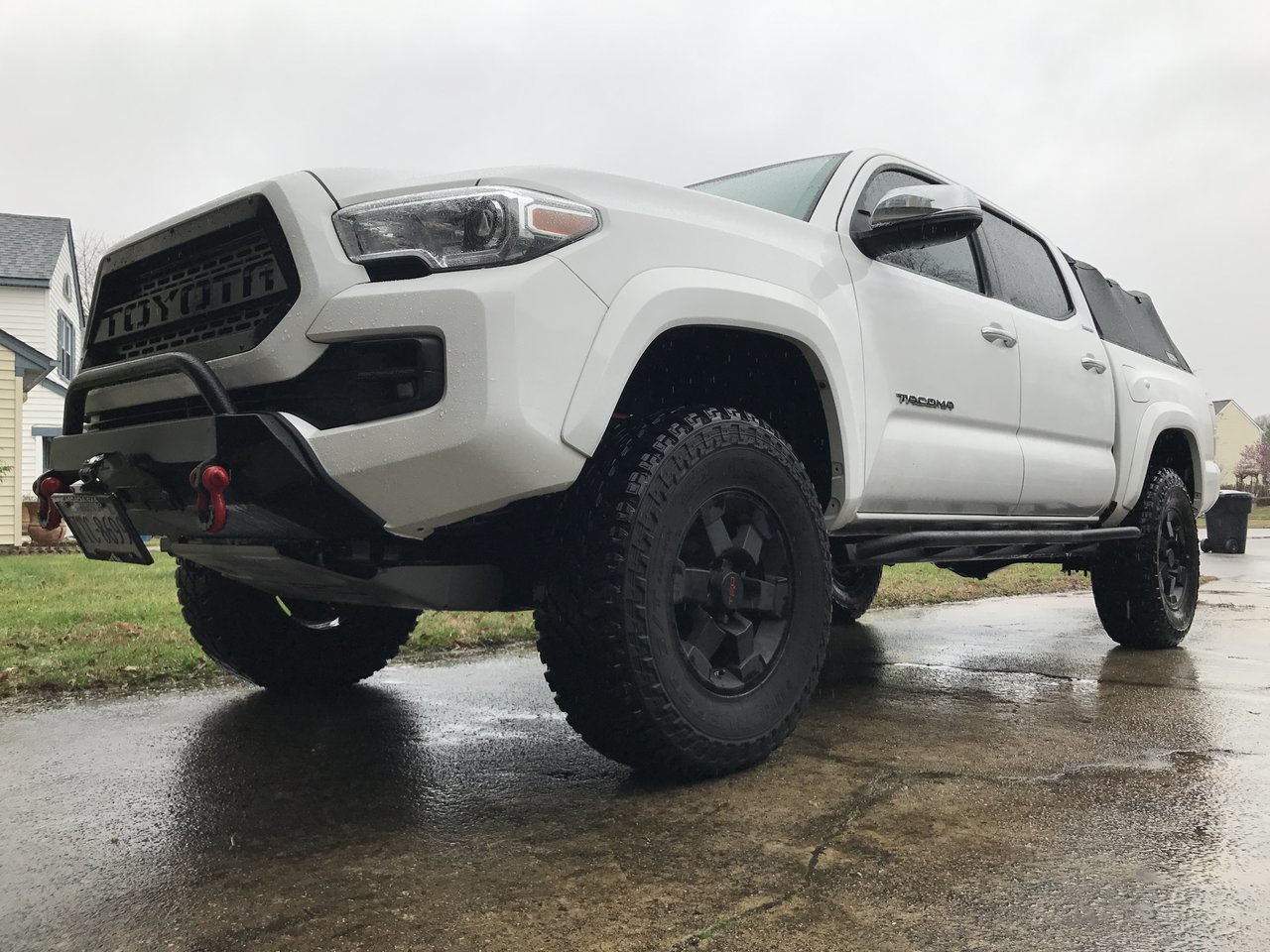

    All you need is a 650 Eibach springs (14") I'm also on 6/5 setting, you could consider 700 if you plan on adding a crap load more weight up front but I don't know anyone running a 700 so it may be pretty damn stiff. I put on a steel bumper and now sliders.
    Sitting 38.25" from ground to fender up front Before the sliders, sliders on now I'm at 38 or more, hard to find a flat surface. I'm on 255/85r16 st maxx
