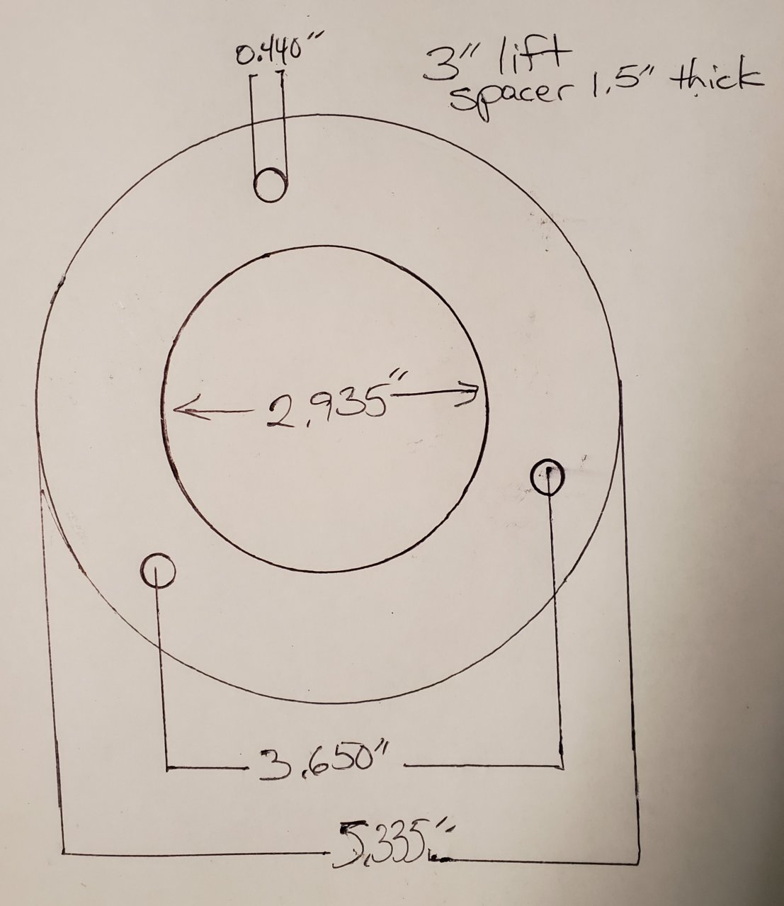

    Here's the one I drew up - can be printed actual size. If you find yours, let me know how it compares.
    Disclaimer *I have not tested this is correct*

    Can confirm, this fits!

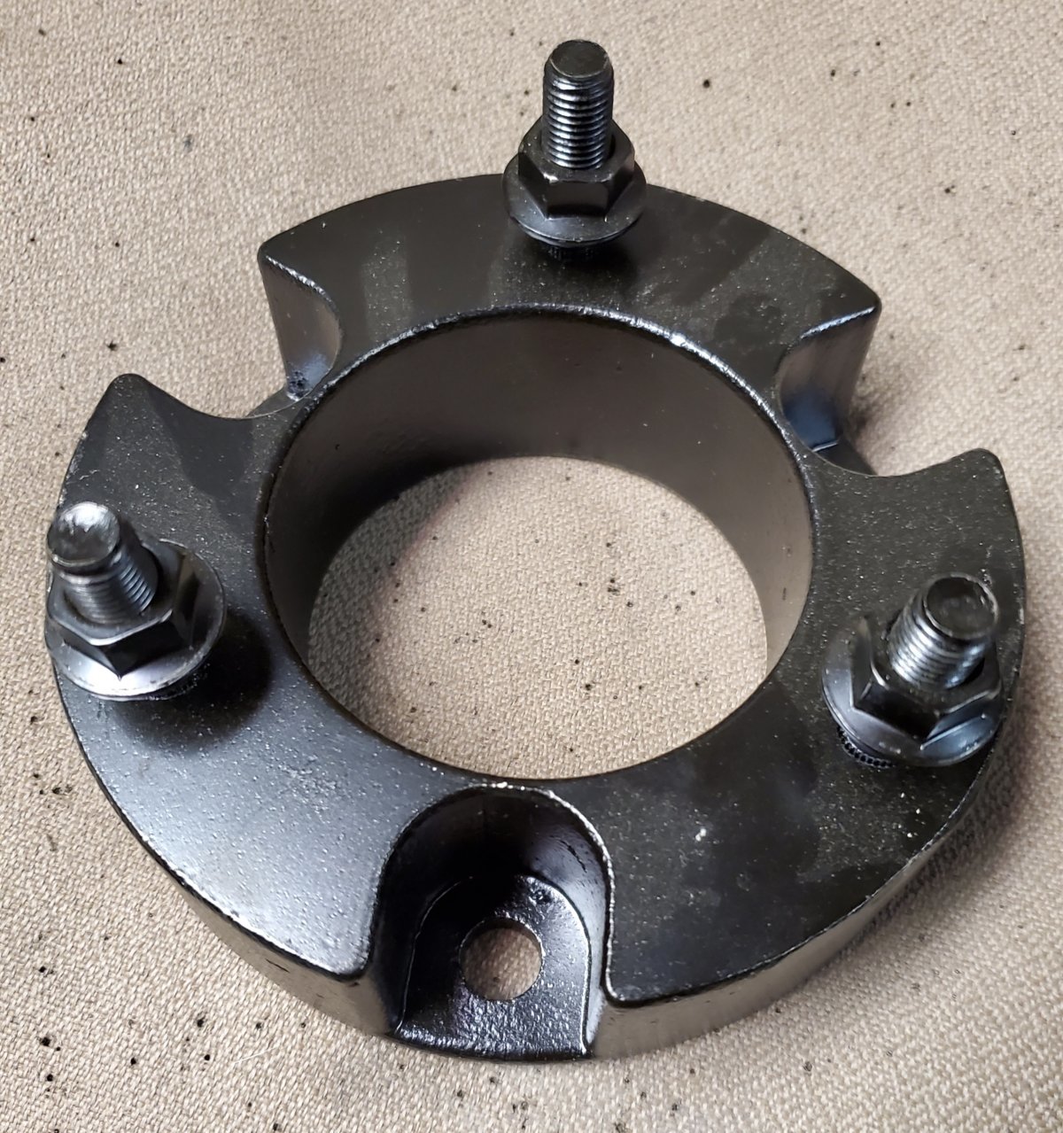

    Here you go:

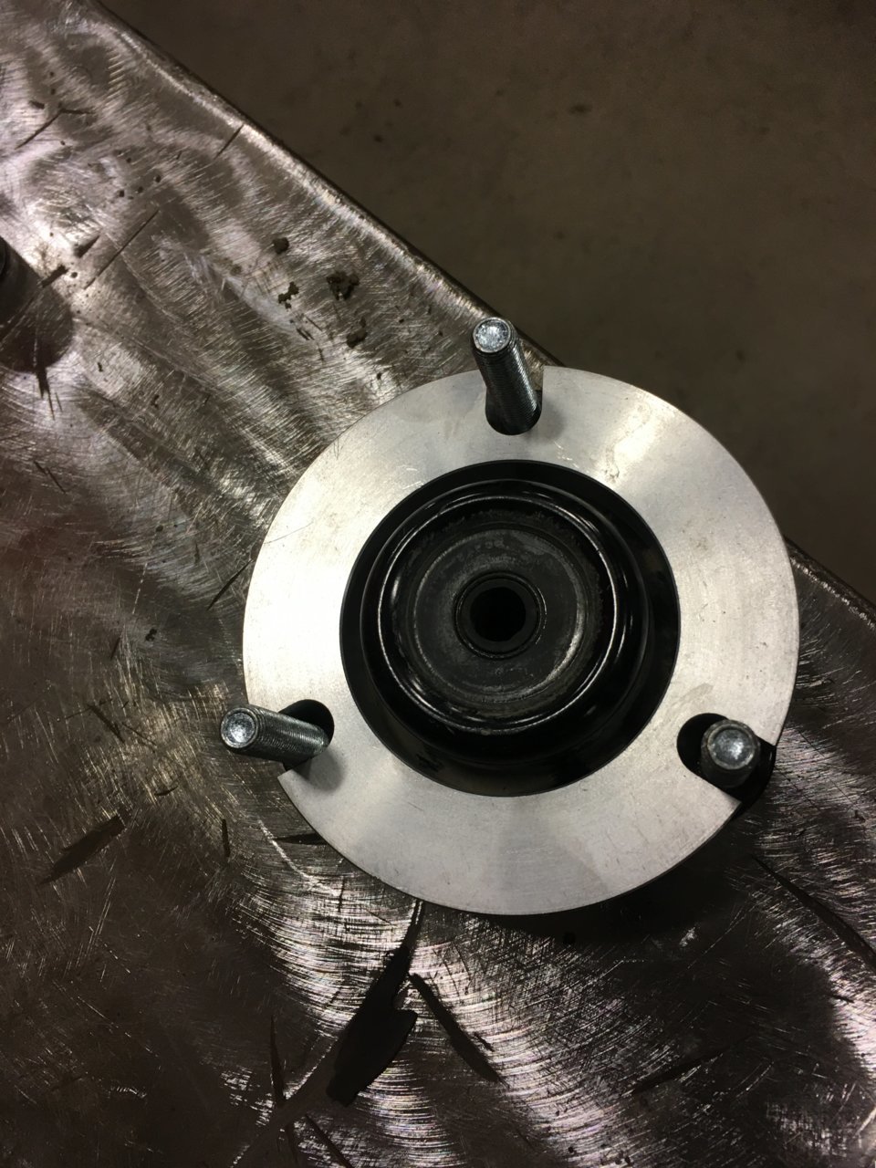

    Got my hands on one to measure. It's 1/2" thick - is there a change to be made in the "hat" studs to get sufficient length for nut engagement? They are M10 - 1.25 threads.
    I'm only looking for an inch change in height and the 1/2" should do it.
    Later......... Found the Dorman stud p/n 610-308 which is the right M10-1.25 but 29mm length? Would that be a useful changeout part for the factory "hat"?

    Found a set of longer studs M10-1.25:
    rogue-off-road p/n BU30000 = (6) 50mm studs and (6) elastic stop nuts
    $15.00
