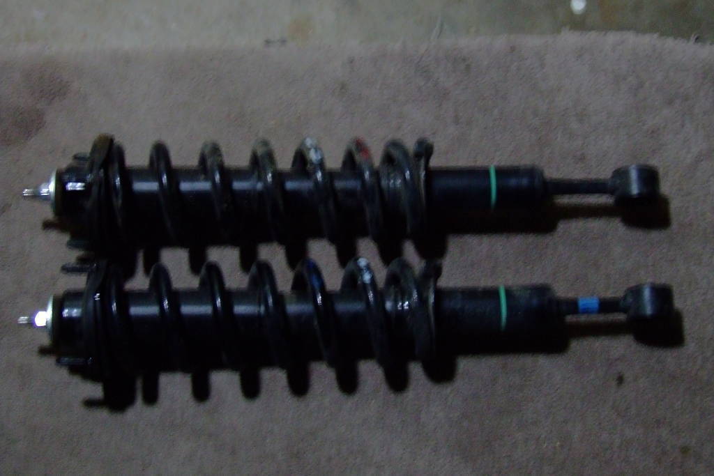

    im doing a lift this weekend as long as all the goodies get here by than.
    5100's with 885's with top plate spacer. my question is where do i put the spacers. do you put the spacer on the assembly of the shock before it get bolted in ? any pictures would be helpful

    Sorry for the fuzzy picture. See the three bolts (left side of pic) on the top ring above the coil? It would go on top of the ring with the bolts going through it, then get installed.
    How big of a spacer are you talking about? You will get twice the thickness of the spacer in lift (1/4" = 1/2" & 1/2" = 1")
