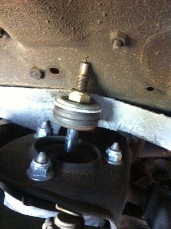

    New here to the forum; I don't want to hijack a thread, but also don't want to start a new one on the subject of "strut mount".
    So I had OEM struts and bearing plates/mounts installed in my 2002 4x4 Xtra Cab two weeks ago. Day before yesterday hit a small pothole going through a residential area at about 20mph and you can see the result in the pic.
    Does anyone know if this would be due to a faulty strut or a faulty bearing plate/mount?

    Holy crap man!
    Need more pics so we can see whats going on.
    For one, those don't look like factory bushings and two it sure seems like theres a lot of thread up top (possibly the strut was over torqued). The reason I mention the bushings is because if they are poly they don't compress as easy as the rubber ones and with that much thread that bolt had to be torqued on pretty darn tight.

    The bushings will be shot, I'd just get all new assemblies with washers and bushings if I were you. They are not that much at all ;)
    Aside from monroe, KYB probably carries them. Perhaps even moog. The Monroes are good though and I actaully like the quality of their studs over KYB.

    I'm in the process of moving and am currently living 850 miles from all my tools; I have a local shop repairing it. I've asked them to make sure they don't toss any of the parts they pull off, so I'll get some pics of the failed parts to see if that sheds any more light.
    I'm just salty 'cause they were just installed two weeks ago and are warrantied for one year - the only problem is that I'm four hours away from the nearest authorized shop to service under warranty!
    My hope is that when I take the parts and pics in to the shop that did the work, the guy will treat me fair and at least refund the cost of the parts.
    Thanks for the insight, I'll compare the amount of exposed threads to the one on the other side for sure!
