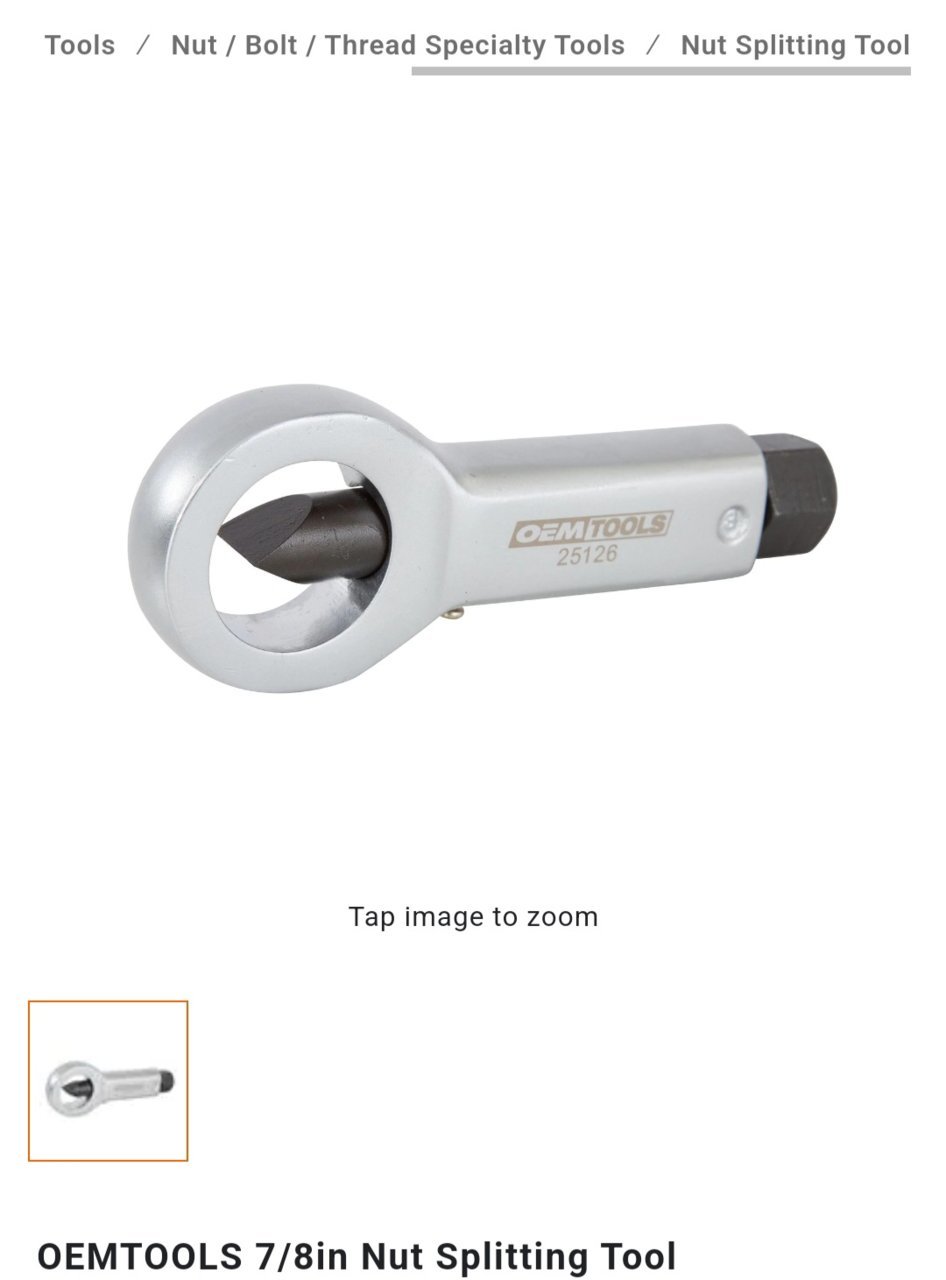

    For future reference this tool is your friend for seized nuts in the Northeast.
