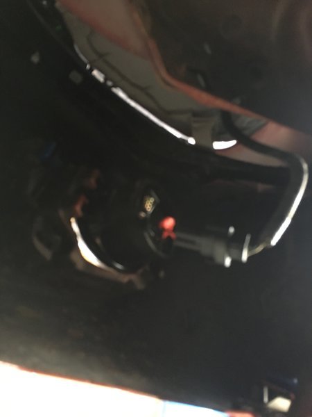

    Ive been working on my TRD Pro 2nd gen recently, not to much but and update.

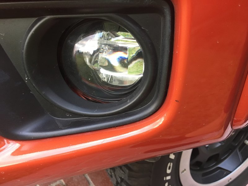

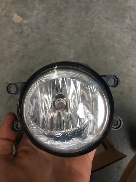

    They are not like a normal fog light. Instead they emit a bight horizontal beam. You can see the lens in the photo above. The photo below is the stock fog light.

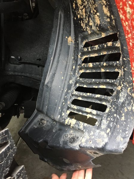

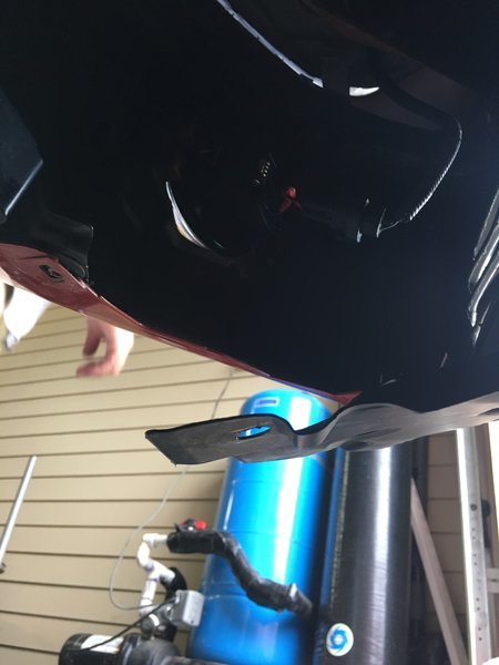

    This was a very easy install except for the space access. It would have been easier if I would have taken the wheel off, but did not my power tools charged up so i just turned the wheel all the way to one side and crawled below in between the back of the front bumper and the wheel well.
    The photo above is the main part you have to unscrew to get to the stock lights. Its a whole 2 lights so its nothing. That space in-between the inside of the wheel and the well is where is was sitting working on the lights. (NOTE: CLEAN YOUR TRUCK BEFORE YOU WORK ON IT! I learned the hard way...)

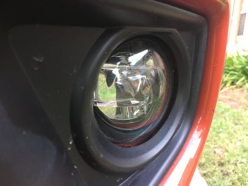

    Its very easy to take out the old fog lights and put the new ones in. Just 2 screws and the clip for the wires. (I recommend using a flathead to get the clip un clipped, its pretty tight.)
    I'm very happy they came out on my truck, they work well, are bight, and much cleaner looking in my opinion.
