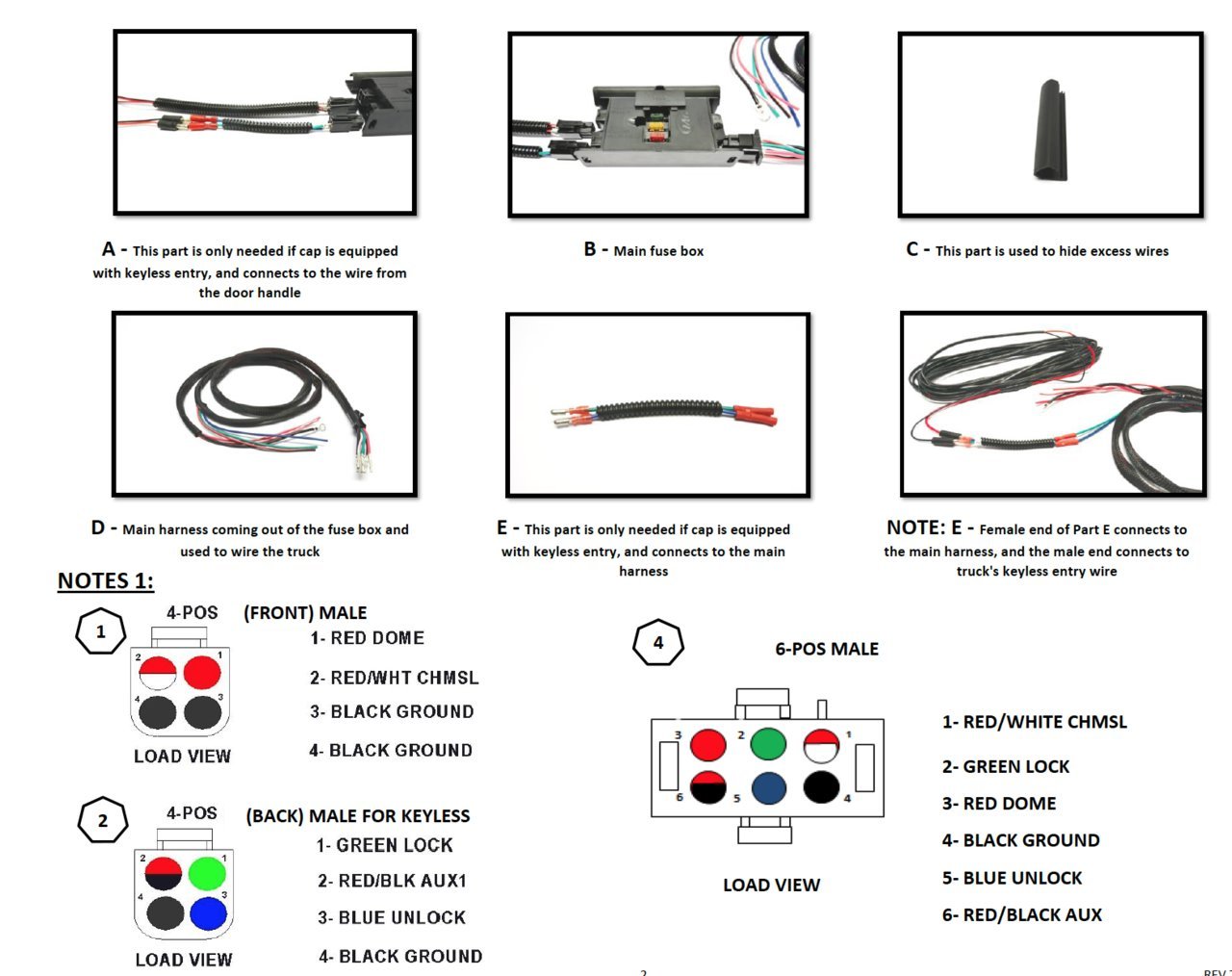

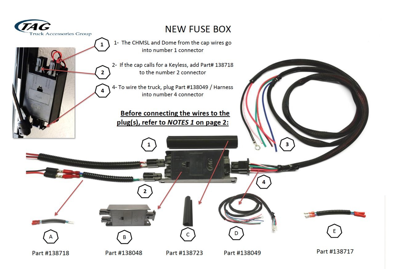

    Here's a little more helpful info I found while hooking mine up yesterday regarding the Leer wiring harness
    9B681136-8A6A-4DC0-9D12-48A72F315250.jpg BE1303E5-D5B9-41E3-90CB-FC7899A05ACB.jpg
