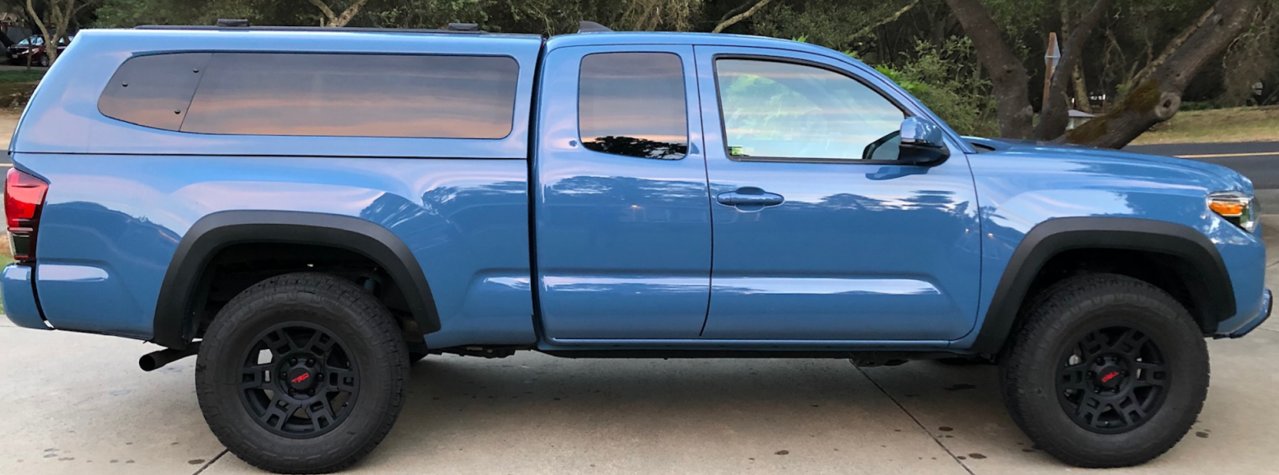

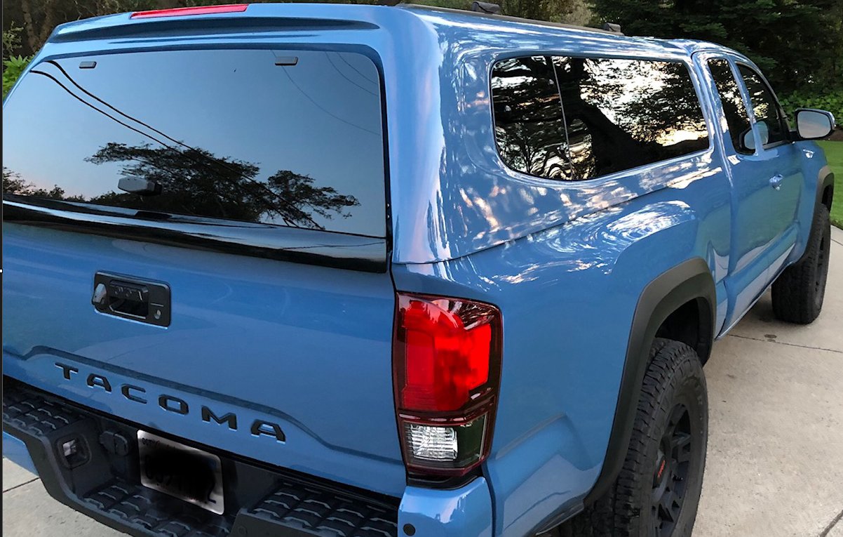

    After adding a Snugtop GB Sport topper to a V6 Auto AC (long bed) my mileage:
    1. Increased when driving on flat & downhill roads at steady speeds.
    2. Decreased in all other driving situations.
    Everyday mileage decreased as approximately 95.8% of my driving is not #1. Believe #1 is due to improved aerodynamics, and #2 is due to increased weight.

    157
    2019 OR AC Cavalry Blue
    Snugtop GB Sport
    Yeah purdy but less functional side windows vs others
