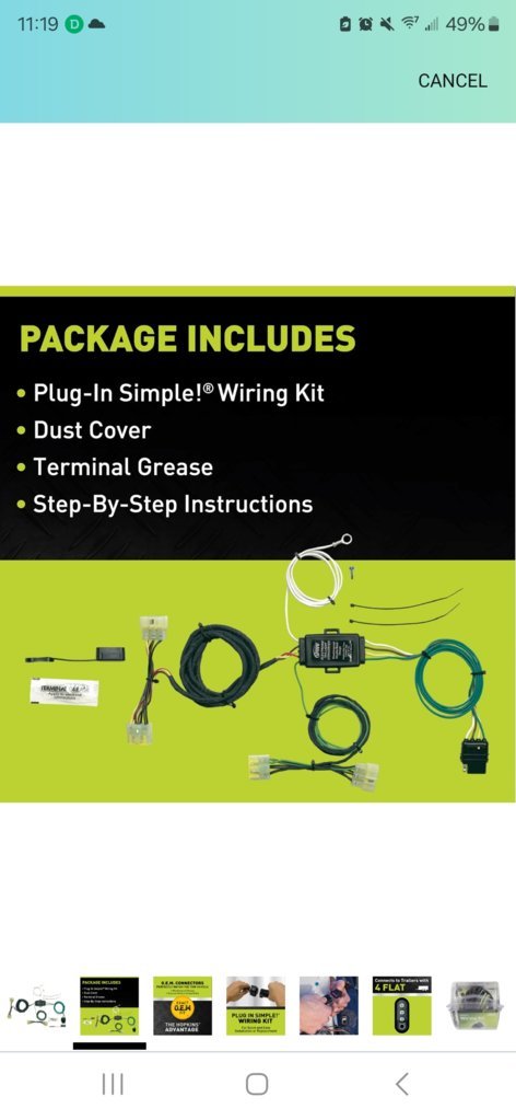

    I bought the Hopkins trailer kit. Link: https://www.amazon.com/dp/B0002Q7ZKK
    I noticed that when I wired it I could only get the topper light to turn on but it would not flash when brakes are applied.
    So I realized that the trailer kit, the brake light wiring isn't connected to the wire for the topper brake light.
    Should I cut the wire to connect it to the actual light?
    I bypassed the kit to the taillight and noticed that when I applied the brakes the light went dim. Is that normal?
    This has been so annoying to get to work lol.
