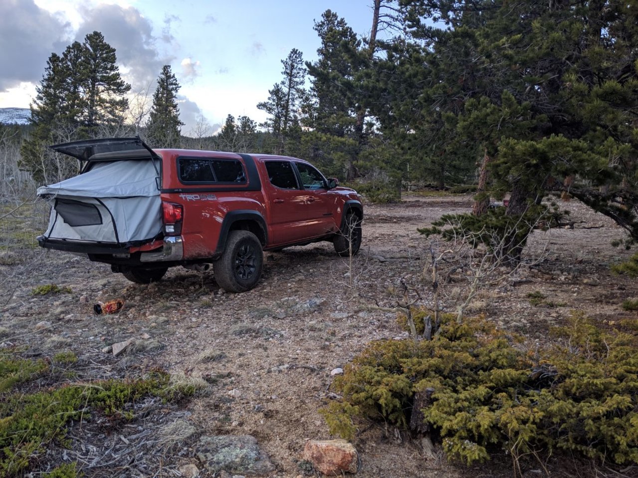

    So as promised, the final update. The parts came in and fit no problem, so if anyone else runs into this issue, you can definitely use bars from a 2nd gen on a 3rd gen. Once we got it all secured nicely we immediately took it out for a maiden voyage camping trip

    I really like it so far! The protective coating is really nice in person and looks great with a little two-tone action going on. I've also blacked out everything on my truck so it matches really well. I was chatting with the guy at the topper dealership and he said it looks best on the non-standard color trucks (black, white, grey), so if you are still driving the taco in quicksand I think it would look really nice. In terms of insulation, it was great, I took it camping in Colorado at 10,000 feet, and the wind was brutal this weekend, but nothing crept in.
