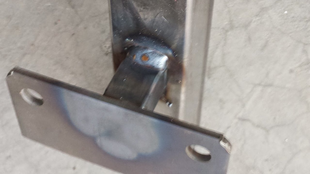

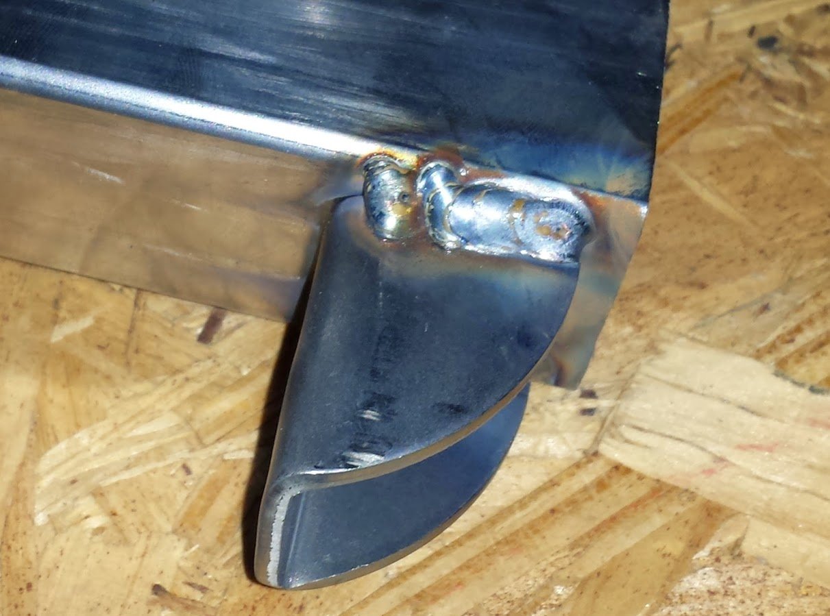

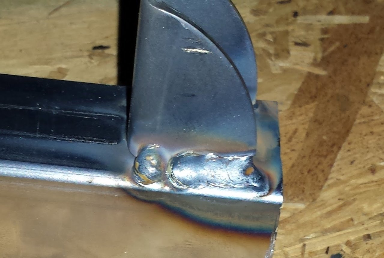

    Looks like some tips I got from those with more experience worked out well. Went away from just trying to tack it up. I wasn't letting the heat get into the metal was the issue. New examples, getting solid penetration, even blew out some on the edge of one bracket...
    For these, did a longer tack on each side, then ran it. wish the phone took better close ups.
    9jUHycBcPMpc8k8OTX35HHGNAx3ZtUD1Fgi68eFz_e09b7202718f659e7e27d52592e2262918bcf04a.jpg
    jKnOywGNGllNUV_lIsTNPVyqkPW9H01zqf3FAYFA_fc3f05a1dfe36f52a144adff57584c33b72a6264.jpg
    For this part, I think it looks like the heat definitely got through the thicker plate, might have had my stickout too far because it started to spatter.
    One down, 3 to go.
    Now I know what size gas shocks to order and need to order the pop pins.
    Next I have to figure out how to connect this to the topper reinforcement cage.

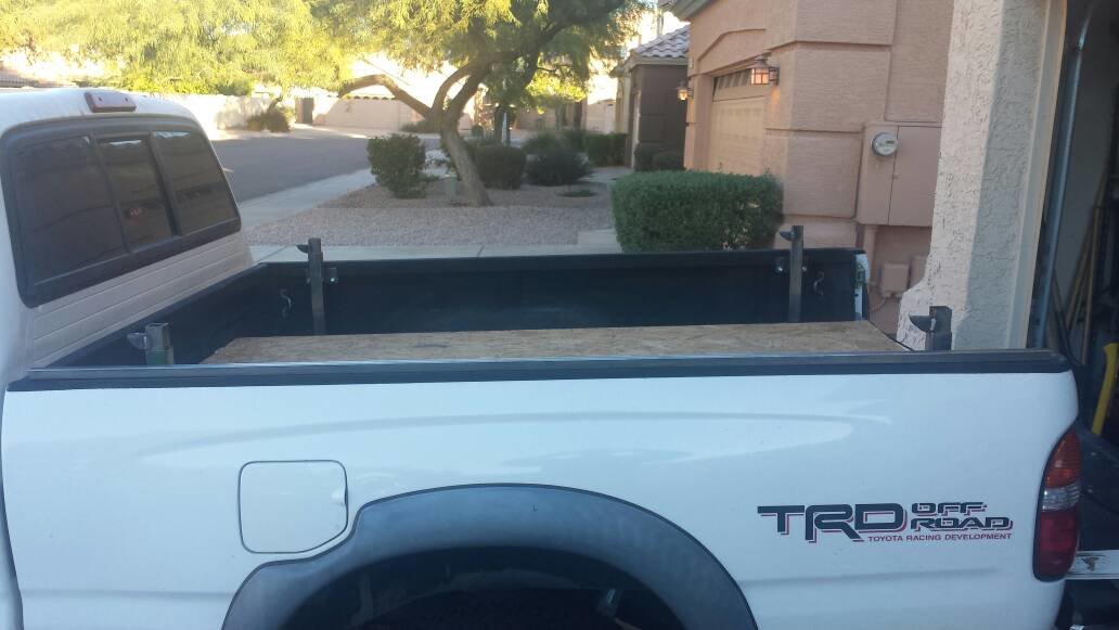

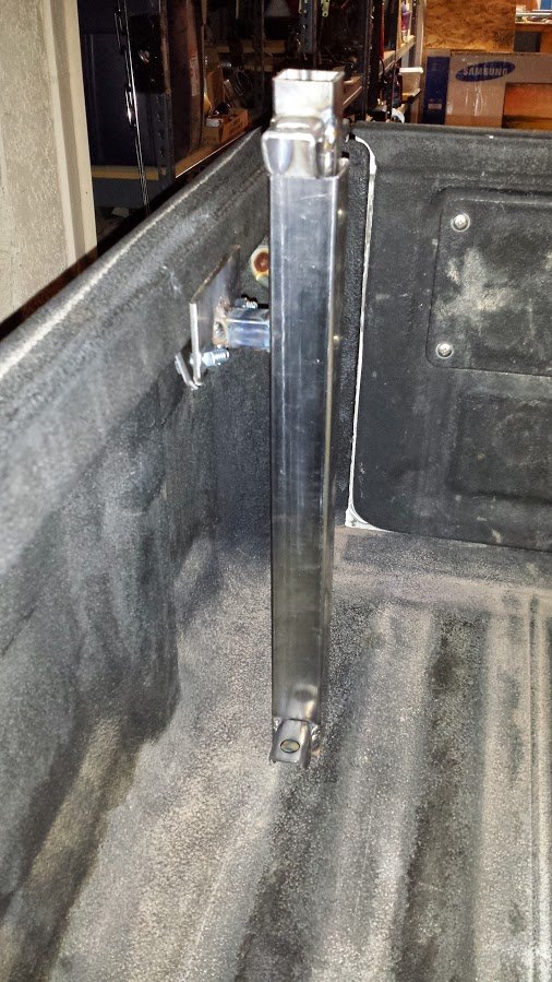

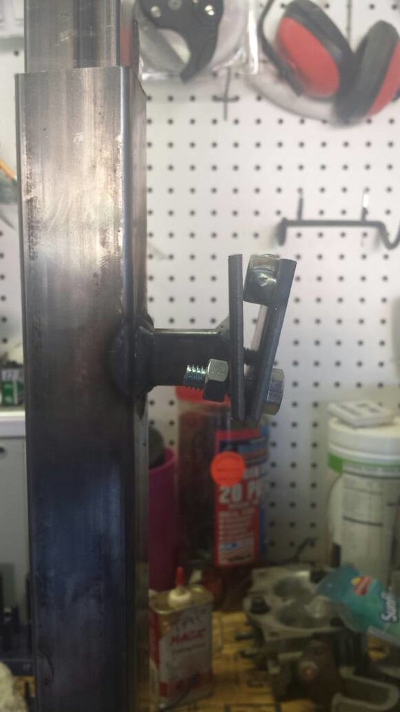

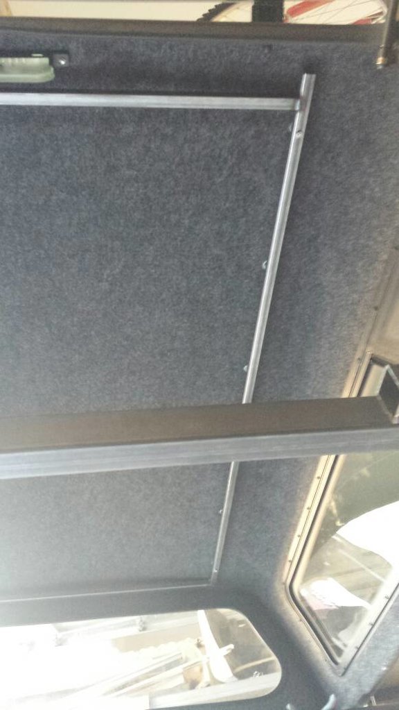

    A little offset. Welded on nuts otherwise as the two peices clamp together the bottom tiny lip of the inside of the bedrail bends.
    Got these measured, cut, and test fit. longer bolts holding the topper roof rack tracks go through. Will be two connecting peices, maybe a third in the middle. Then I have to decide how to come down and connect to the telescoping lift peices.
    I really still want it modular so I can pull the topper or lift legs if needed or all of it out fairly simply if needed.

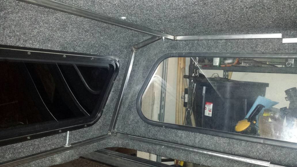

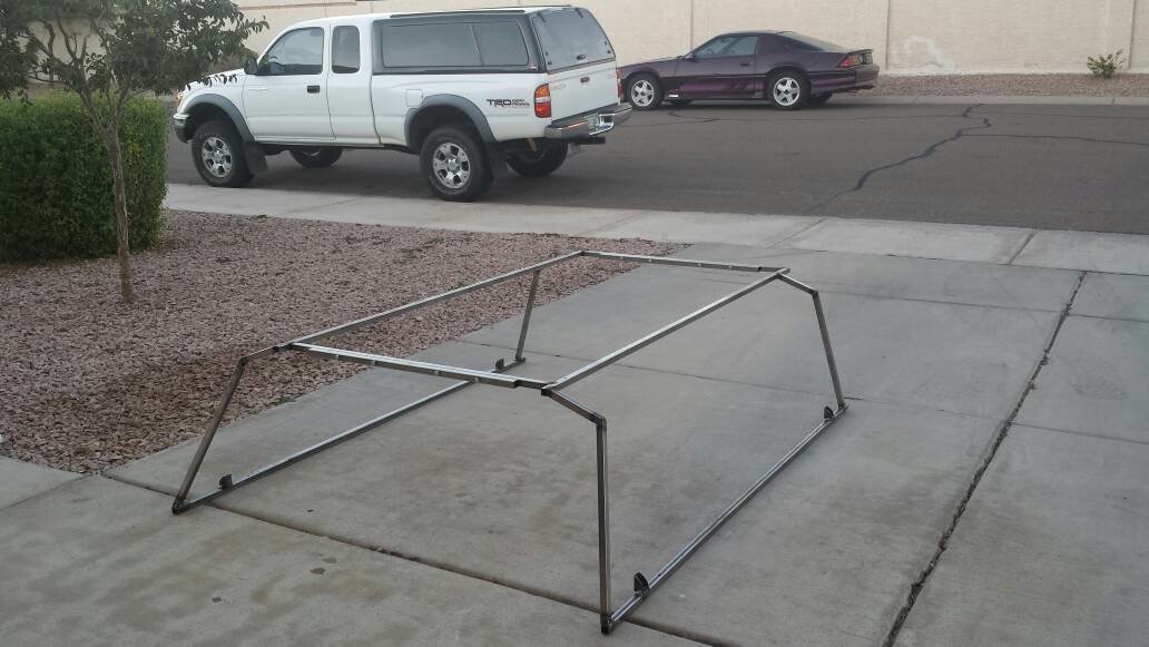

    Bottom frame is mostly to hold dimensions. Has to get sectioned to go in the topper

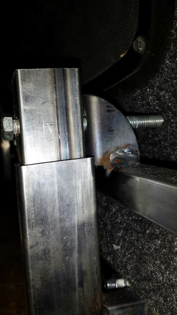

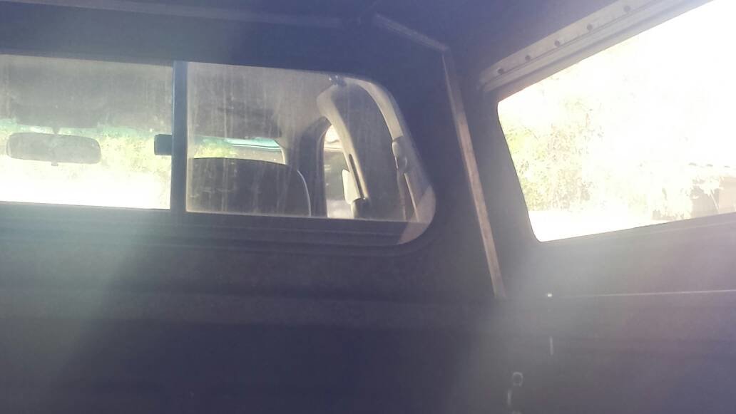

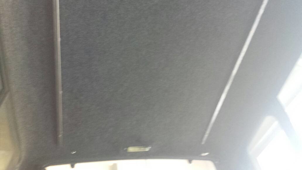

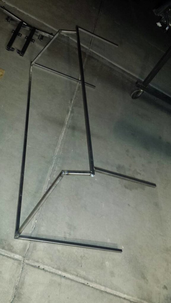

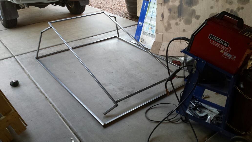

    Half done. Think im going to have two sides that bolt to a square top frame. No way to make it one piece and fit in where I want it to. Probably should have bought a bender and done some of this with some round tube?

    Are you going to sleeve the ends where the two halves meet?

    I think it will bolt together the length of the topper. The two top half peices will come off. The closest bottom half is already back off. It was just there to measure and position. The back (furthest in the pic) bottom is not necessary Ive discovered. The topper is strong on its own, so this is just a little help for when its lifted and for mounting to the lift posts. So really there will be to side parts and one top middle square the sides will bolt to. The sides bolt to the topper at the rails and the top where the topper rack track bolts come through.

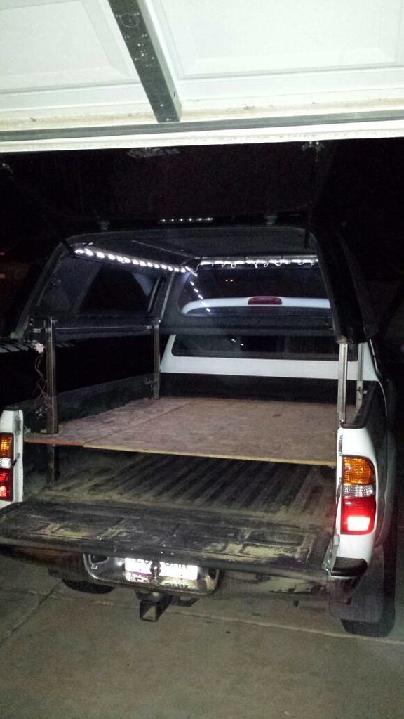

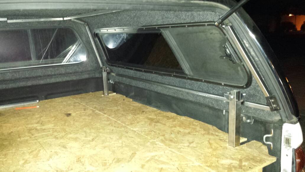

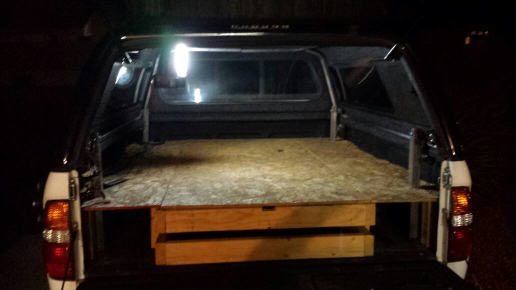

    With the platform. 2x4s will go away in in place of steel cross members that it will rest on. Slide out drawer will like be made. Along with a box up front for house battery etc. ..

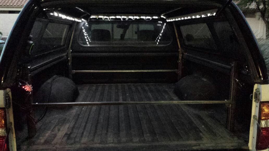

    Going camping tomorrow. Had to button up and put back together at a stopping point. Gf said she wanted the leds back in for the trip (Old sign shop free leftovers)

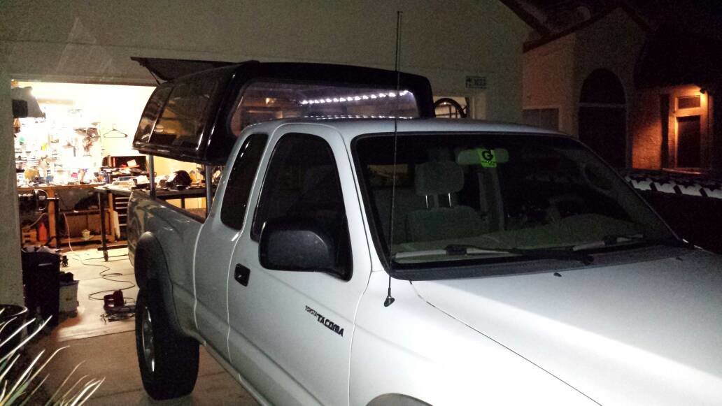

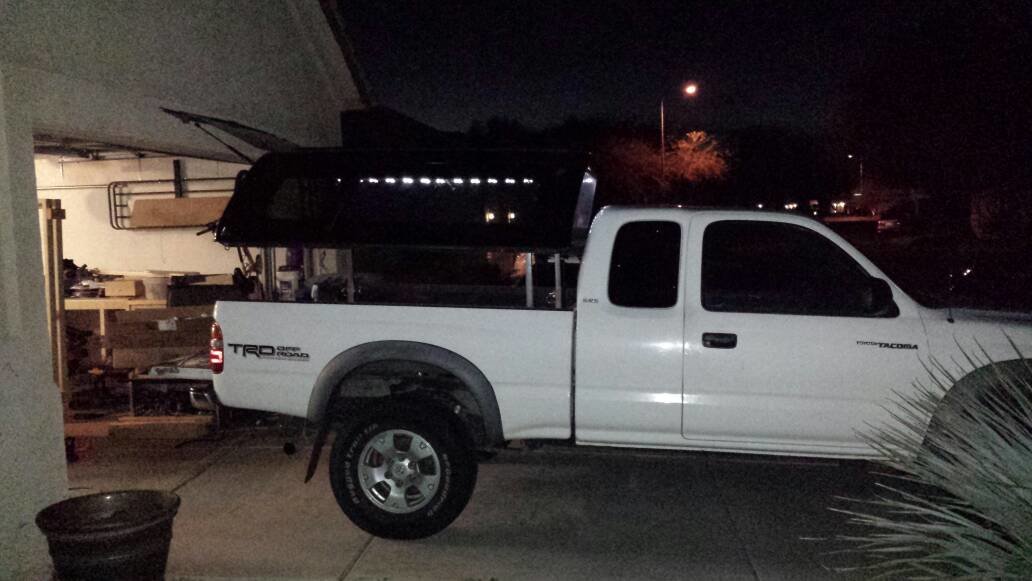

    How bout that!

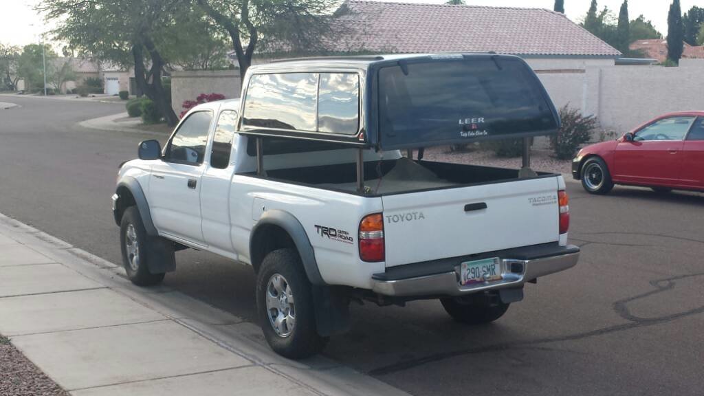

    75 lb struts are too strong. Probably 50s woulda been better. Topper weighs 200. Bought the 75s thinking id eventually have a roof rack but I dont think I'll need one. Gotta either go smaller or figure out a way to pull it back down thats a lot easier.

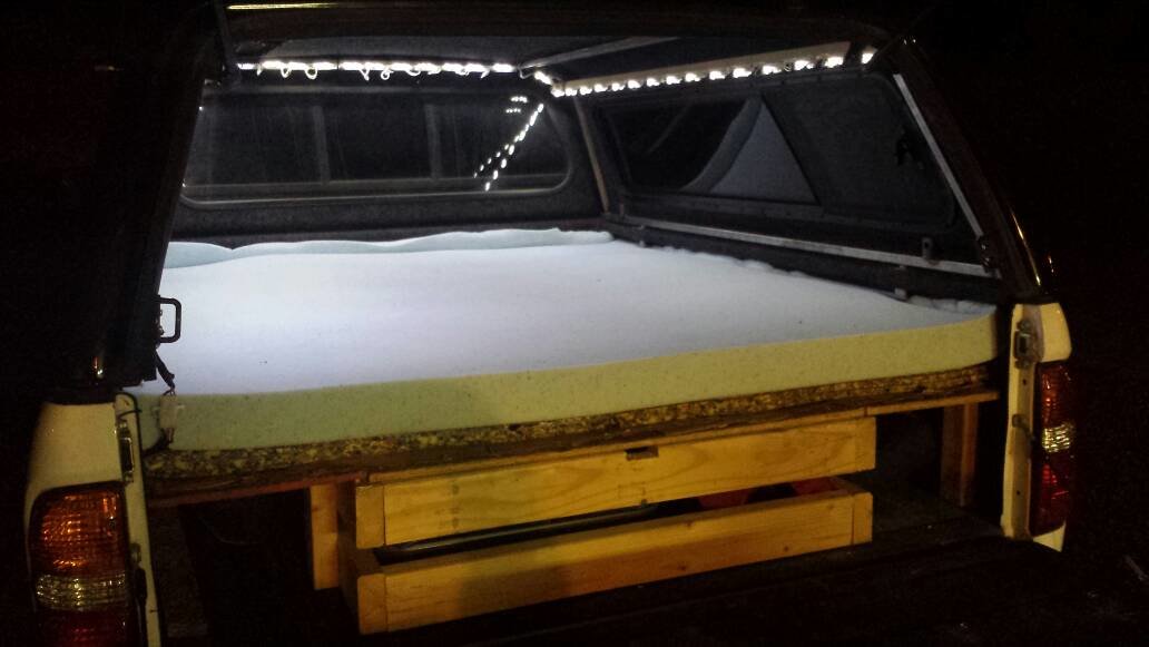

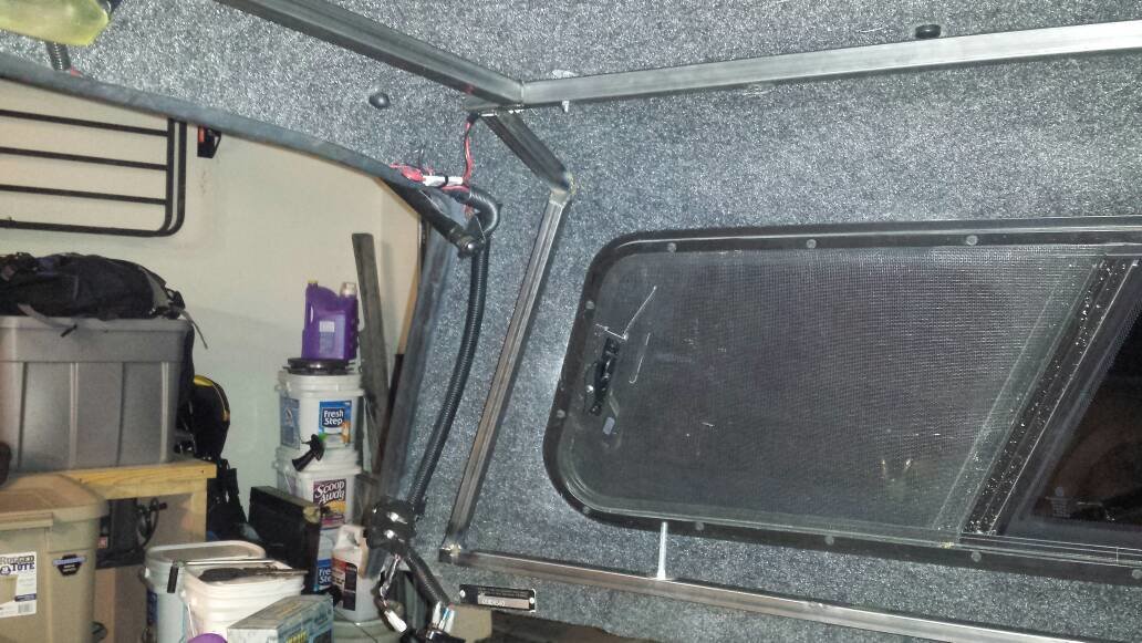

    All electric now. Used a 4relay board with tiny tactile buttons vs a big switch. the buttons are low power so I can have some up front and some in the back. Front and rear are independent. My fiance is prepping side panel curtains and a rear tent. The platform is reinforced.
    Next up is a big sliding drawer and maybe a flip out ladder.
