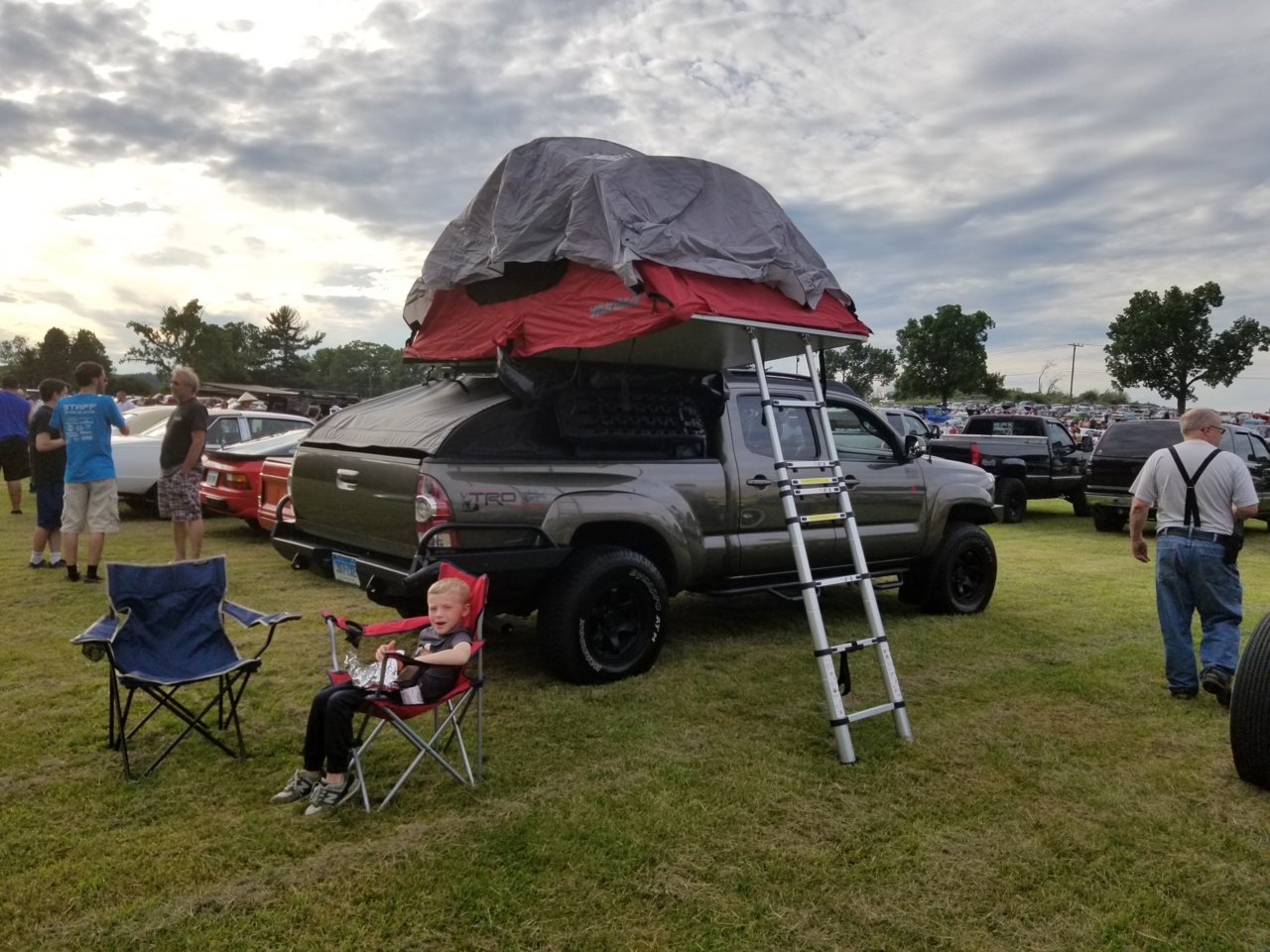

    I went the custom hybrid option. Bed cage with roll up tonneau on top with drop on rtt

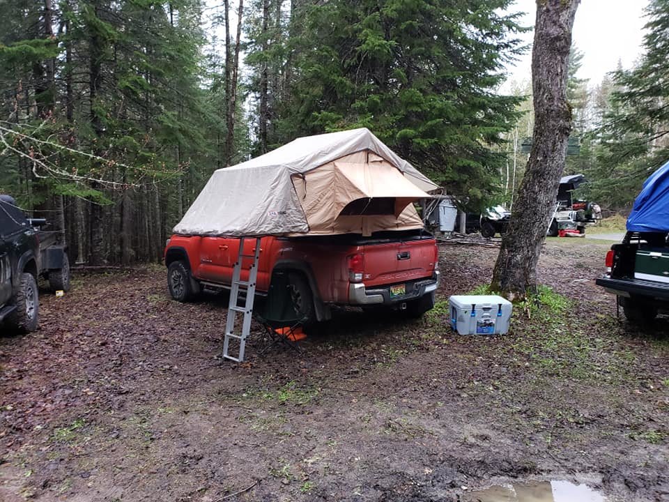

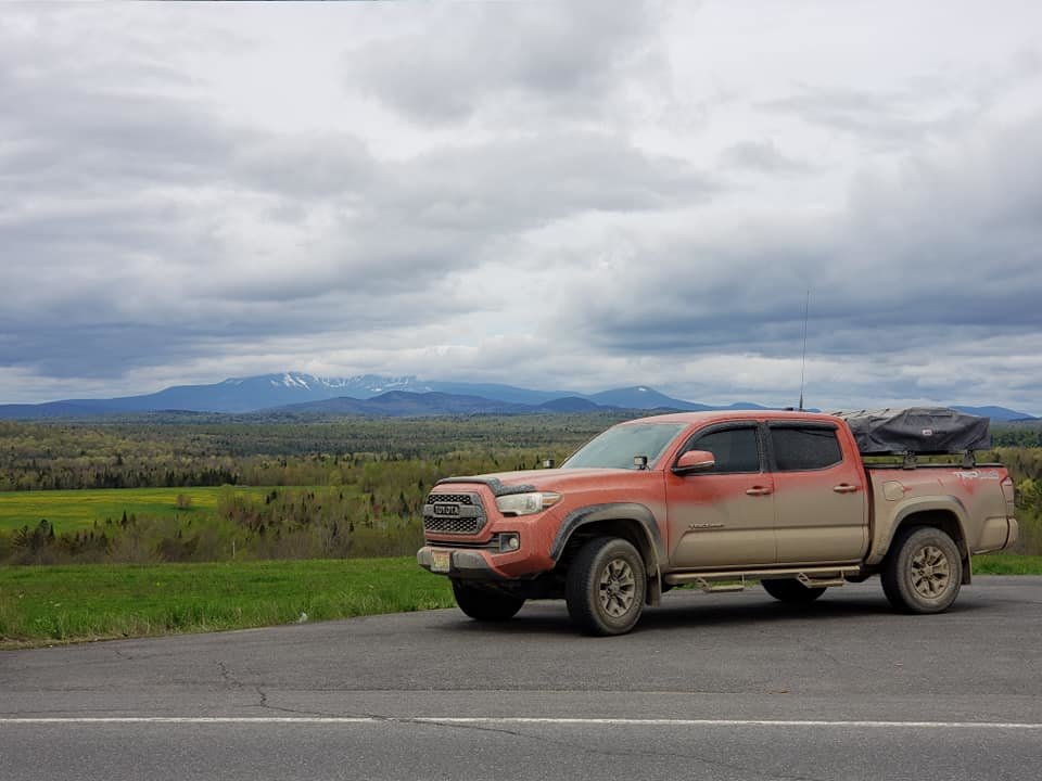

    ARB simpson III with annex, on the KB voodoo high rise bed bars. folded up, and centered on the rack..
    I got the HighRise bars so I can retain my soft roll up tonneau cover, to keep the items in the bed Some-what clean.. dust still gets in through the bed holes I havent filled it.. (no real reason to, stays rather dry in there). also due to pricing on the full sized racks.. $368 shipped for the KBV high Rise, VS over $700-800 for the others.. and I was short on funds for a late fall trip to Northern Maine Woods(this pic, Mt Katahdin in background)
    the only downside to a rack this low is I am unable to use the annex that came with my tent (annex would sit half in the bed (at the seam of the tent floor(drivers side).. I also cannot get an awning that would be worthwhile.. sitting would be ok, but no standing space..
    I am planning to eventually get a higher rack, like either the RCI, or even the MaxRack- modular 18" rack to get the tent higher off the ground, and give me some of the bed space back ( height when i need the space), and then I can use my annex, have the tent open to the back (tent shell, and awning covers the tailgate for loading/unloading, and easier access to the vinyl cover straps, and sides for packing tent away.) I can then also get myself an awning to give me a place to sit out of the weather, and possibly add sides to for longer campouts.
    I have the Tyger tonneau cover from Amazon for $189 works well, although the bars are a bit thick to fit/roll the top under the high rise rack...

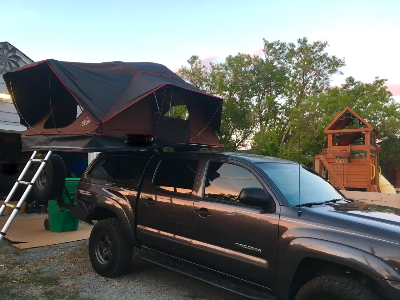

    My RTT mounts on the shell. No noticeable wind noise and haven't seen a huge hit in mileage. It weighs 120lbs so it's light enough that I don't really feel it up there.

    I didnt see much of a drop in MPG at all, even though the ARB does stand a bit higher, and weighs about the same 120lbs for the tent/cover, and another 30-40lbs for the annex walls.. than some of the other RTT's out there. mine is just about level with the cab of the truck, however when i get a taller rack I imagine I will see a 1mpg drop or so.. NBD... my future tire, armor, and suspension setup will do more than that..

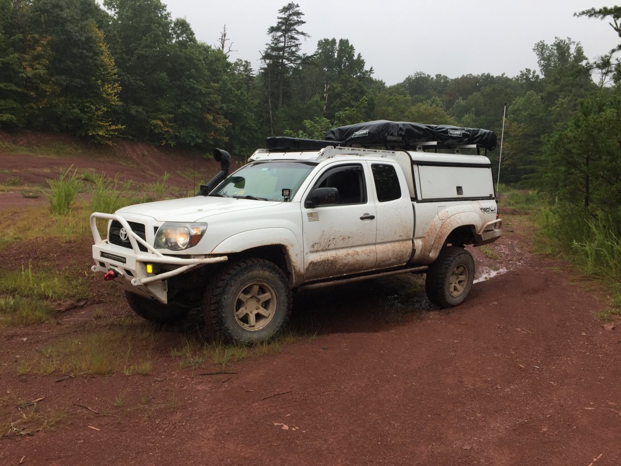

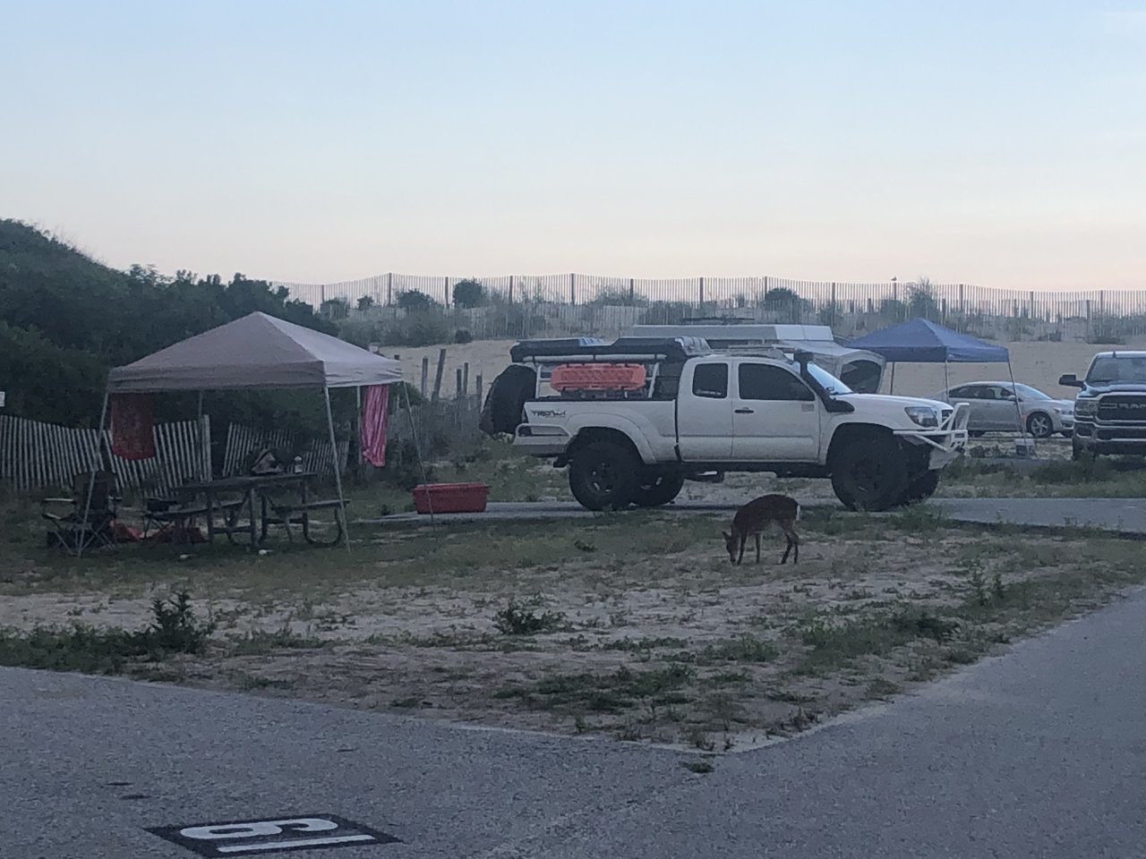

    I've had both, but found RTT on top of topper is way too tall for my liking.
    Might look into thinner RTT. Mine is 11" tall at highest point. I also have full bed use

    I love the slant back look of this! Post more pics in my build thread?
