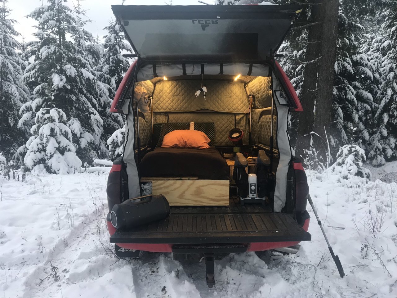

    Hey everyone, I'm working with Tod to be a point of contact for TopperLift here on TacomaWorld. If you haven't seen, we are in the process of setting up a group buy on coming up here in the next week, and lasting about 2 weeks. Feel free to ask questions on here or through a PM to me.
    We have a new material that we are in the process of converting all our inventory and options to. It was developed by Clam Outdoors, the pop up ice house manufacturer. It is a double wall material and much thinner for roughly the same R-value of insulation compared to our current/previous quilted insulation.
    Below is my setup if anyone is looking for inspiration. I spent 3 months and 12,000+ miles traveling across the Rockies this winter skiing all over in it!

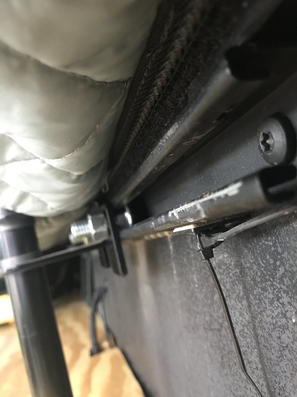

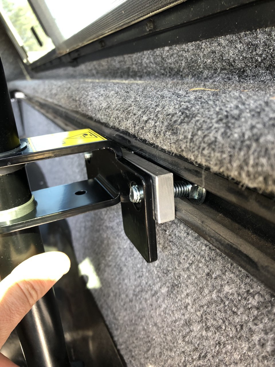

    I'm finally working on installing my TopperEZLift Contractor in my 2013 DCLB! The 2nd gen bed rails seem to be closer to the top of the bed than 3rd gens and other trucks. It seems like the bottom of the canvas would be pinched and bent between the bed and topper when the topper is down, which could damage the canvas/velcro and prevent the topper from seating all the way. I'm considering trying to drop the actuator bracket down below the rail somehow. @gnardoggie, any comment to how this fits on yours?

    In my 2007 DCLB with leer topper, it seats fine with no leaks. I’m opting to take my front bar off to improve how the topper seats with the drop down in the front of the box. I have not had any damage or wear to the fabric though. It is pretty tough 400 denier fabric. When you tuck the sidewalls in, just fold the material over at the velcro point. I like to also tuck my sidewalls up at the actuators.

    Mine is installed that way and I have had no issues.

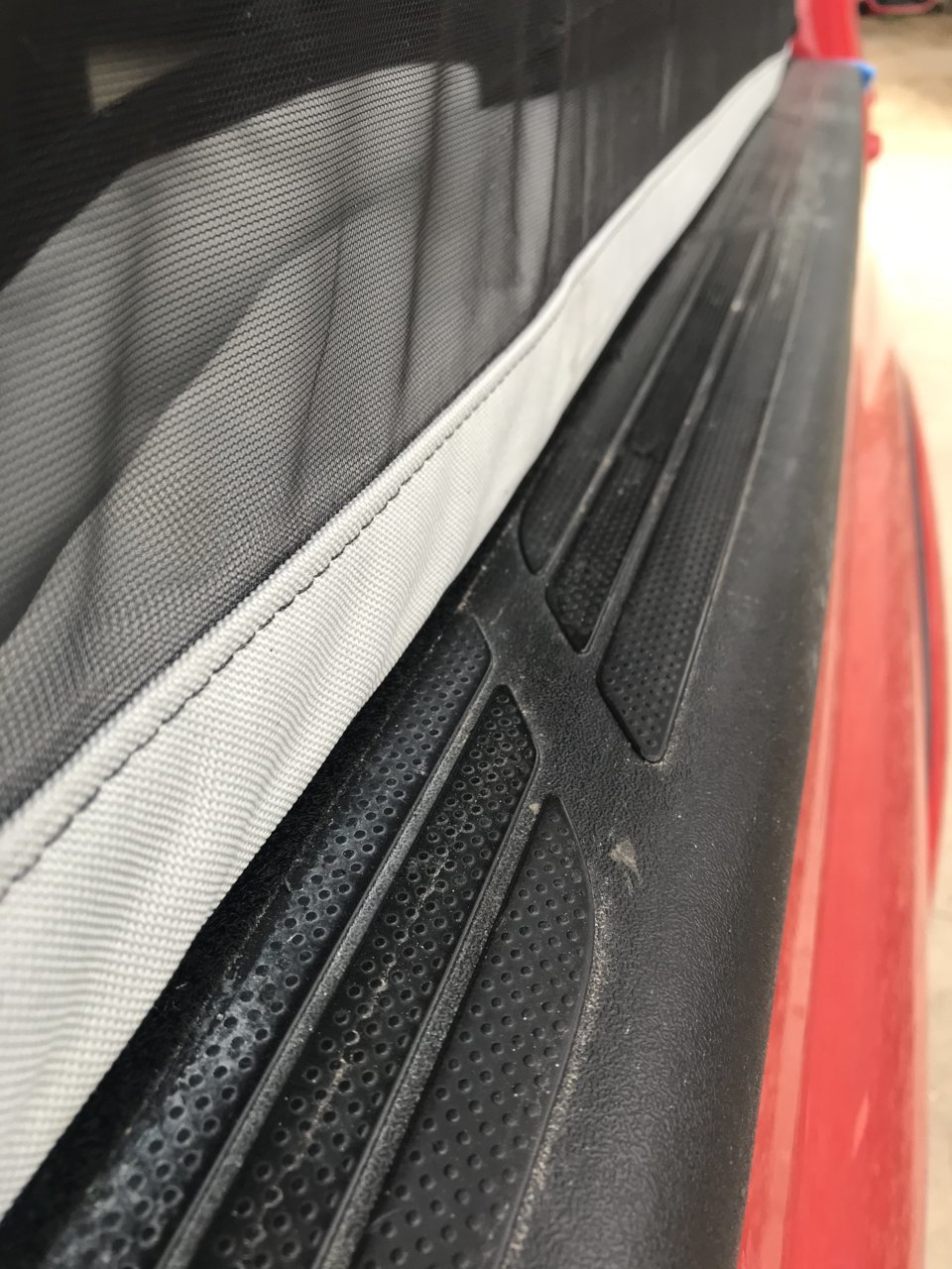

    Seems like it would shed water better if the skirt terminated outside the bed with magnets. I realize it would interfere with close-up but having the skirt inside the rails just seems wrong. Definitely a cool idea though.

    Maybe so, but I personally wouldn’t want to be magnetizing things to my dirty truck while camping. That’s just asking for paint damage. Depending on your topper it’s really a non issue as I’ve explained previously in this thread.

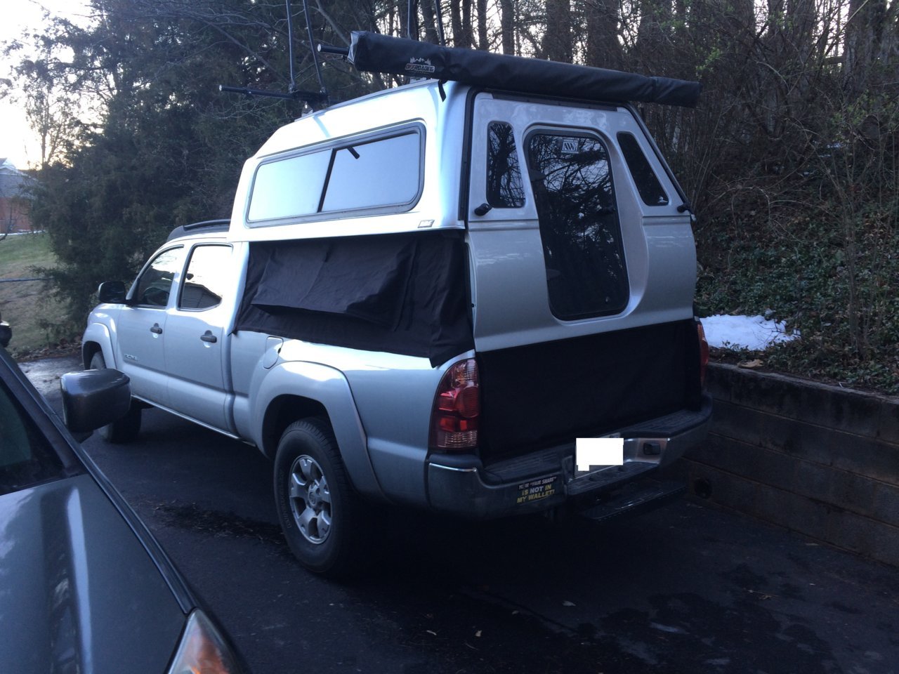

    I recently sold my set up- but agree the idea of not Eliminating leaks led me to design and sew my own tent design, but will echo all the good things that have been said about topper-ez-lift. the lifts and mount design is really good and the customer service is TOP notch. Here are a few pics of what I did. I used magnets and a stiff carbon rod so that the tent stayed firmly against the outside of the truck. As for the wind question. never had a problem but on the few occasions it was really blowing (>15-20 mph) i would lower it some once we were in and ready to sleep. (i added a keyfob remote instead of the switch it came with)

    Thanks for the responses guys. Flyguy seems to have nailed it. First time I saw the ezlift system I said wow, way cool and just what I need so don’t be overly concerned with my criticism, the op mentioned a slight leak and for me that’s a deal killer since bedding would be against that Velcro and once even slightly damp would wick and stay damp an entire trip. I’ve experienced hypothermia from being stuck with a tent that allowed the bedding to get wet in near zero temps and slept comfortably in well below freezing when things stayed dry so I’m more than a little zealous on the topic.
