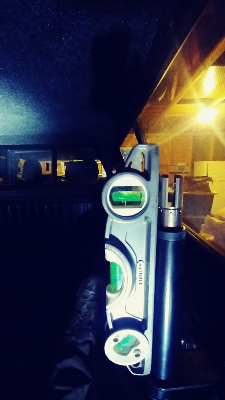

    My vontrol box ram wont lower anybody experience this? Thoughts on whats wrong? Wires crossed etc.....

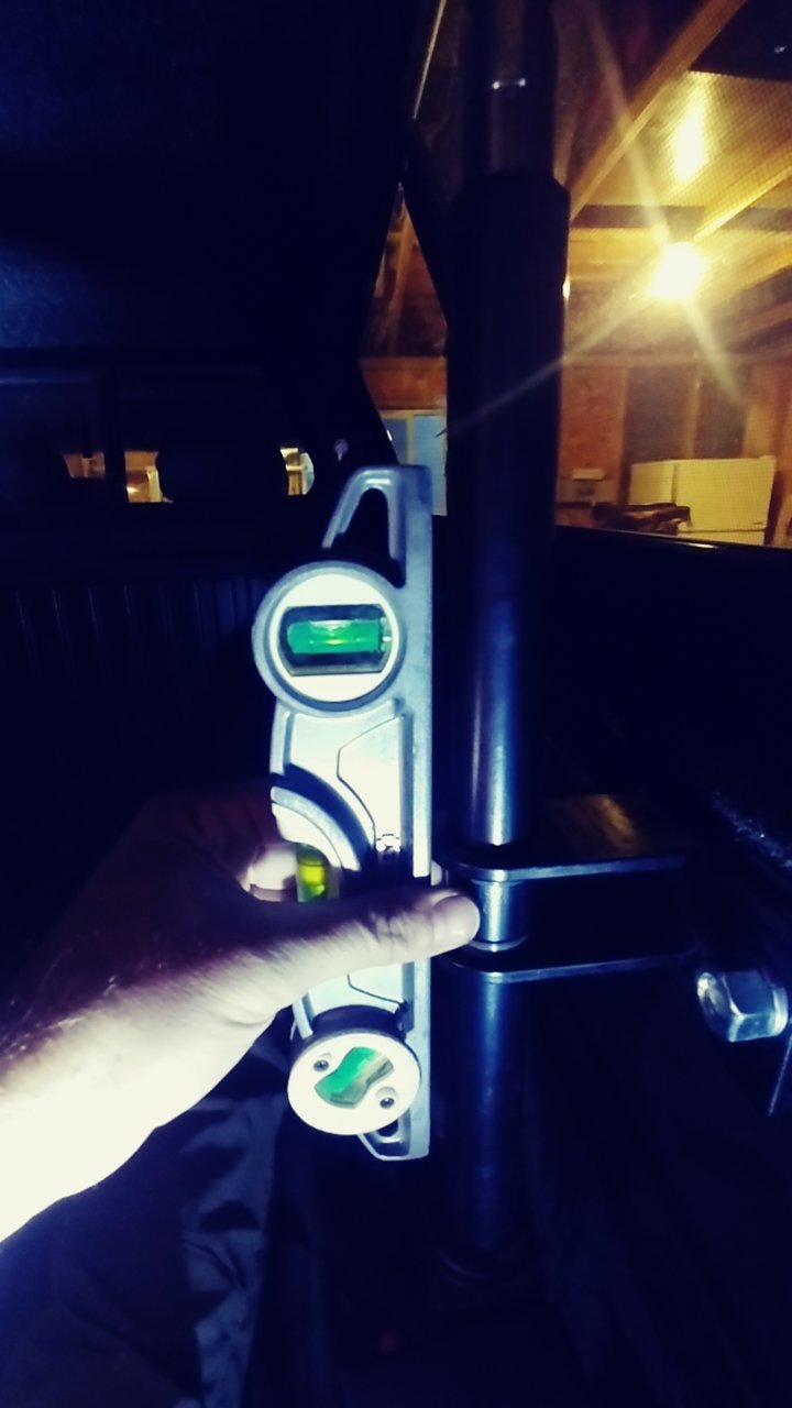

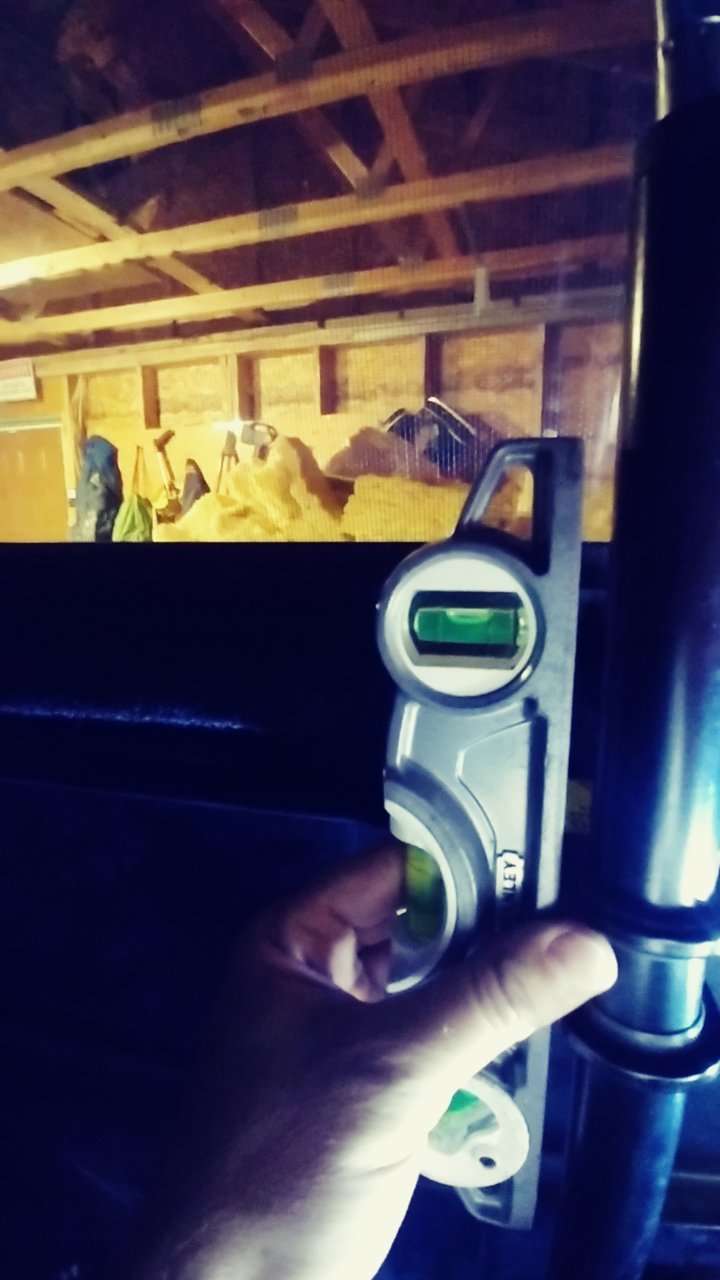

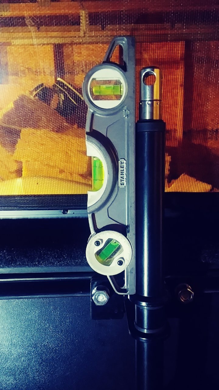

    If it went up but wont come down it is not the wires- it means one of the lifts is not parallel to the others and is binding - get a friend and try to push in on the one that is sticking

    Yep has to do with how level the actuators are. May happen on an incline. I made a video to explain to someone on Facebook. Just uploaded it to youtube. Hopefully this helps you out. Let me know if you have further questions.

    All 4 actuators go up together just fine, the control box actuator won't come down. All 4 actuators are disconnected from the topper at this point to prevent them contacting the topper window. I'll check for level and square but they were working just fine and I can't think of any reason they would have moved.

    Here are photos from both sides, measured 2 different ways.
