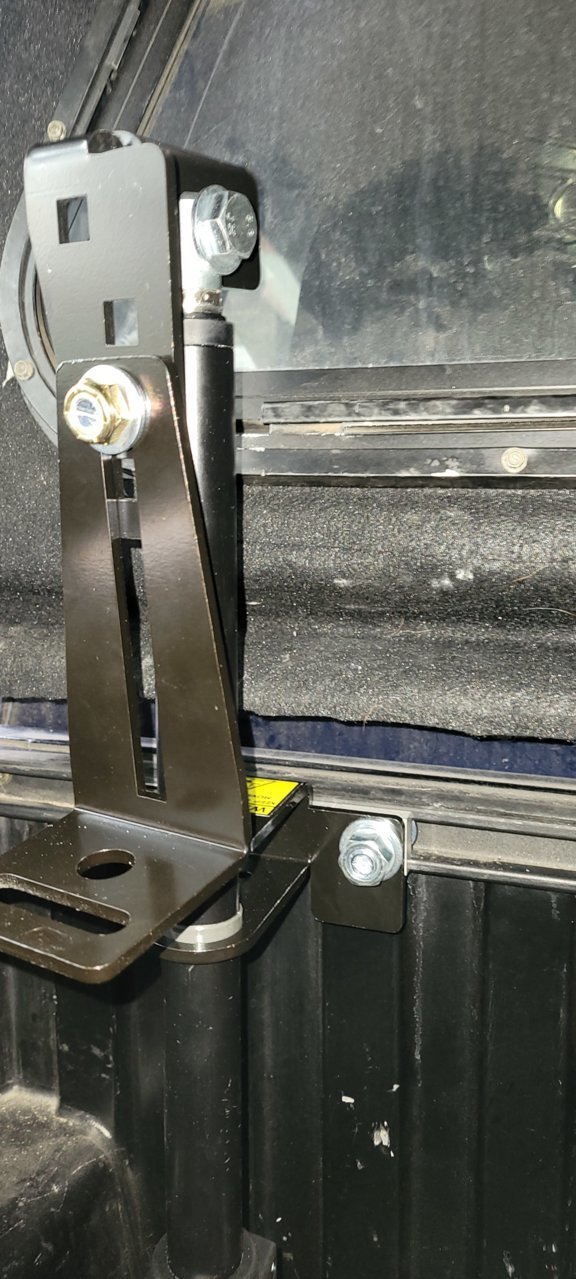

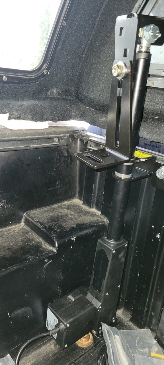

    Has anyone install this on a short bed and can share pictures? Having trouble figuring out how to secure front actuators to topper since they cannot be mounted to the side rails because of the wheel wells. My topper is a really weird angle and doesn't allow for much of the plate screw to feed through... Do I cut the screw and drill from the bottom?20220501_165926.jpg 20220501_165933.jpg

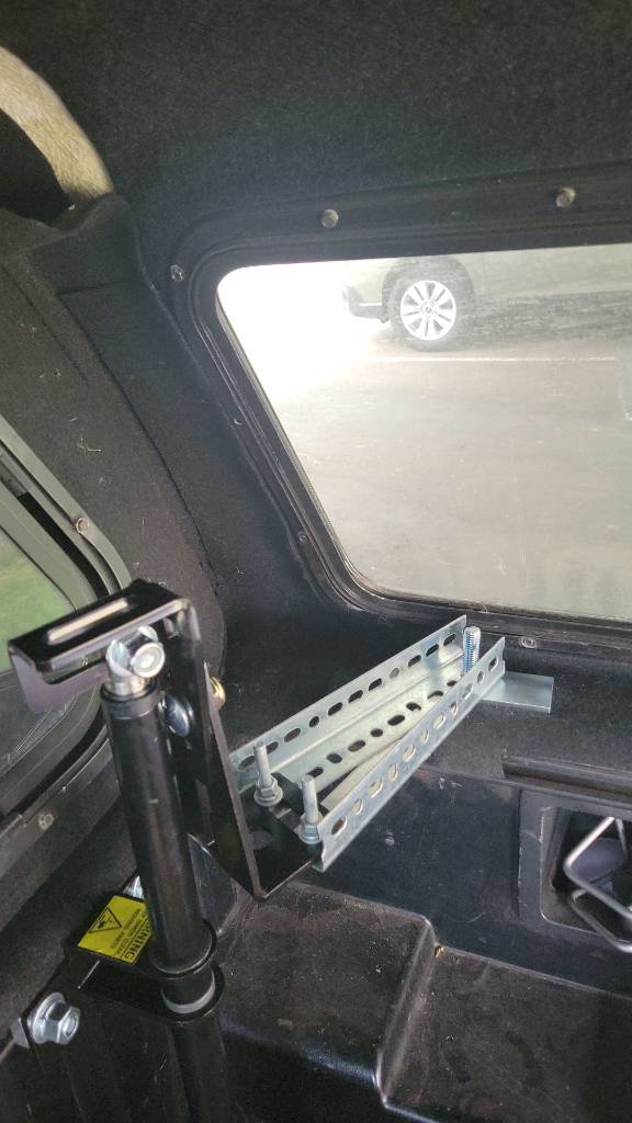

    So turns out it is my LEER cap that is screwing me... The cab window bumps in unlike ARE toppers. I spoke with a nice fella at TopperEZLift (first try, 2 minutes total) and we thought up an idea to attach some slotted angle iron to each side of the front actuator brackets, meet them both to form a triangle to extend it over the wheel well to meet the side rail of the topper. Will need to cut the angle iron and get hardware to attach to bracket. Shouldn't be too hard and will post pics once done for all my short bed friends!

    Here's what I did to rig it up. Not too hard at all just took some time...

    Did you do the same with the front one as well? Any issues with your bracket bending?

    Yes both front actuators are set up like that. No issues bending, it's very strong. Might use it to build a shelf.

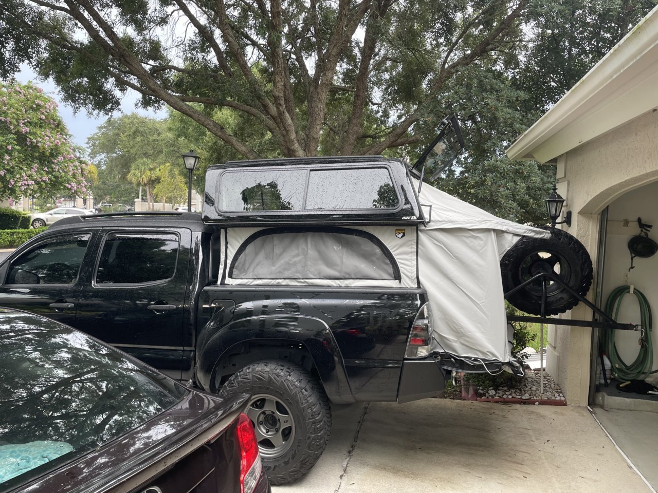

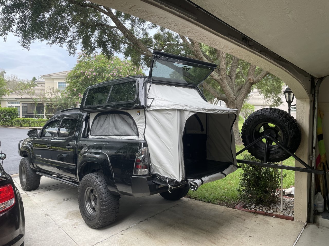

    I had a few shipping delays with the ARE dealer so everything took about 4-5 months to get in but I got the tent installed today. Space is tight in a short bed but I plan to build it out a bit. My cot, commode, and cooler all fit in the bed real well.
