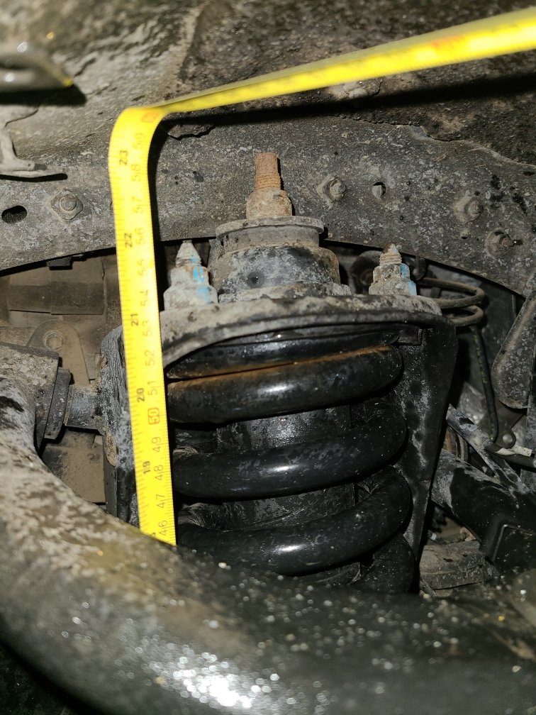

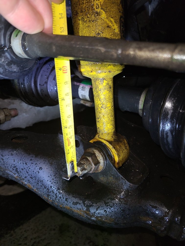

    While on the ground measure hub to fender. Then lift the truck from the frame until the wheel is off the ground and re-measure. Compare and that is how much travel you have.

    Junk head, is that water or is your shock blown?
