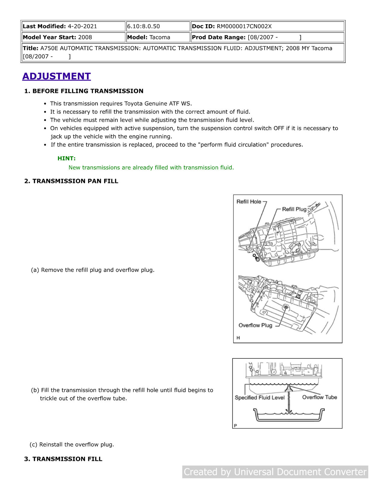

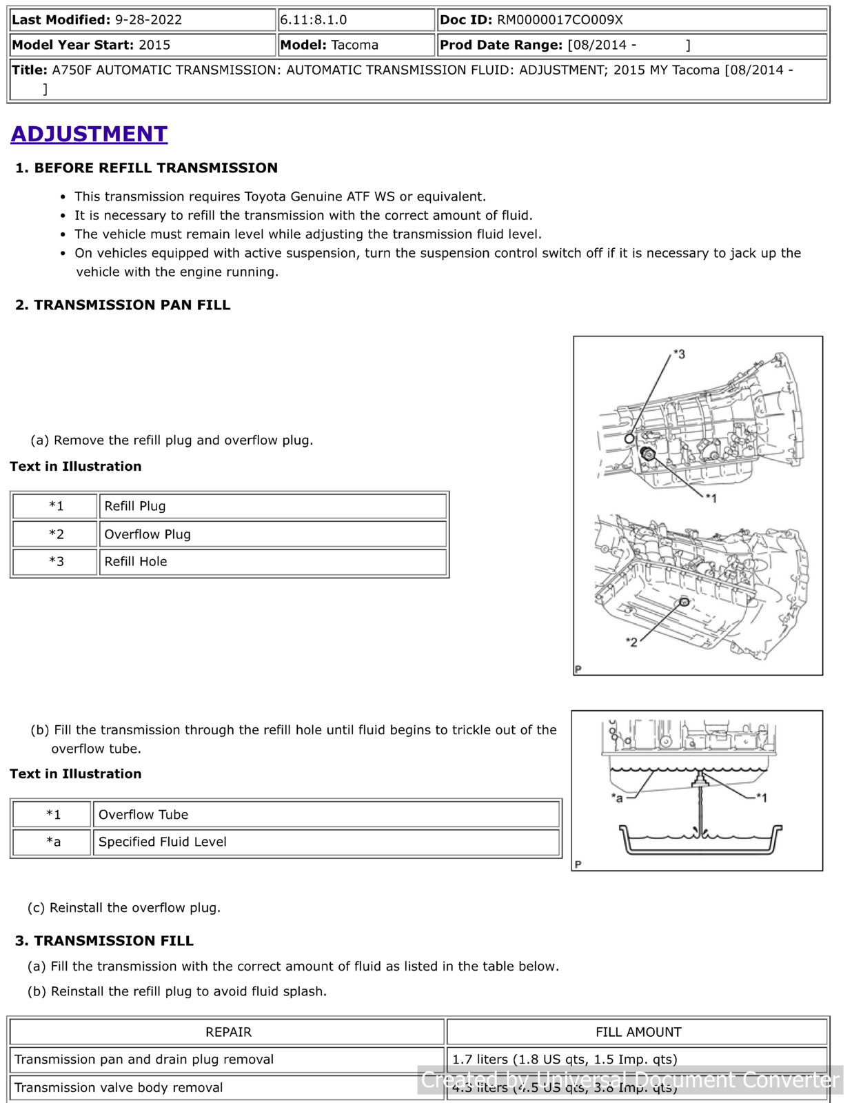

    2wd

    I have a 2006 4wd. I don’t think i have that top #3 - got the side fill, drain and i think the one you meant on bottom which uses a 5mm allen. I got the gist of how to get the oil on that side 24mm hole but not 100% clear after- with both the side 24mm and the bottom 5mm out then start car and add oil till comes out 5mm one? I take it i should run through the gears too?

    Yes you can run it through the gears after you start it then go back to park and add oil till it comes out the check plug.
