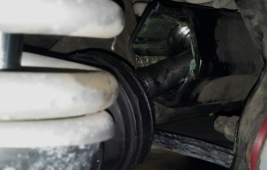

    Ok, im a bit frustrated, but maybe this is the work of God. i was considering the ecgs bushing fix for the front diff anyway, now i have no excuse not to order it.
    however, a new toyota axle is too much dough, it is only a tiny tear i have anyway, no water or sand or anything could have contaminated it yet, so i was considering a boot fix. Toyota makes a boot kit, with grease, for like sixty bucks, but while ordering it, it crossed my mind that i may not be able to install the factory boots without dissassembling the c/v joints themselves. can this be done? this is new territory for me as my last truck i was comfortable running its shithoused boots. this one is too new for such treatment.
    ideas? fixes? anything? thanks guys. btw it is the driver side, outside boot

    so i found a video of a guy taking apart a random axle. the wheel end joint (outside joint) popped right off the axle no problem. similar to how our axles seat in the differential with a c-clip sorta thing where the splined portion of the axle shaft engages the c/v joint itself.
    are the toyota axles like this? put the shaft in a vise and the outside joint comes right off with a gentle hammering?

    I'll chime in because I have torn a boot on the passenger side and I opted to go for the boot kit from the dealer. I will tell you from personal experience that I will never do that again, its a hassle! you will have to disassemble the whole cv to get the boots off (you could cut them but you'll still have to disassemble to get the new ones on) and dealing with the new grease is a MESS! On top of that, you'll need a special tool to crimb the boot clamps down and if you dont get it just right it could end up seeping from the edge of the boot.
    If you go down to auto zone you can get a rebuilt one that may have even come off a Taco (not sure that only our truck uses it). There is usually a core charge that you will get back when you bring your old one in. It will get recycled into the system to be rebooted. When I priced it, it was about $65-70 after getting core fee back. Hope that helps!

    Let's put it this way..you can buy a boot replacement kit from toyota for about 60 bucks or you can buy an aftermarket boot replacement kit from Napa that even cheaper. The labor to replace a torn boot isn't very hard at all provided that you have the right tools. I have replaced 3 torn boots already on my taco. There is no need to replace a whole half shaft becouse of a torn boot. For the outer boots i would suggest the aftermarket ones from AllPro Offroad.

    This is the inside joint or tulip..there's a c-clip you remove and then using a brass drift or even a piece of wood you knock the tulip joint off..you also remove the three bearings, they come off by pulling with some pressure..

    is it necessary to remove the bearings for proper greasing? or am i ok just popping the tripod off for boot replacement, putting it back together, and filling her up?
