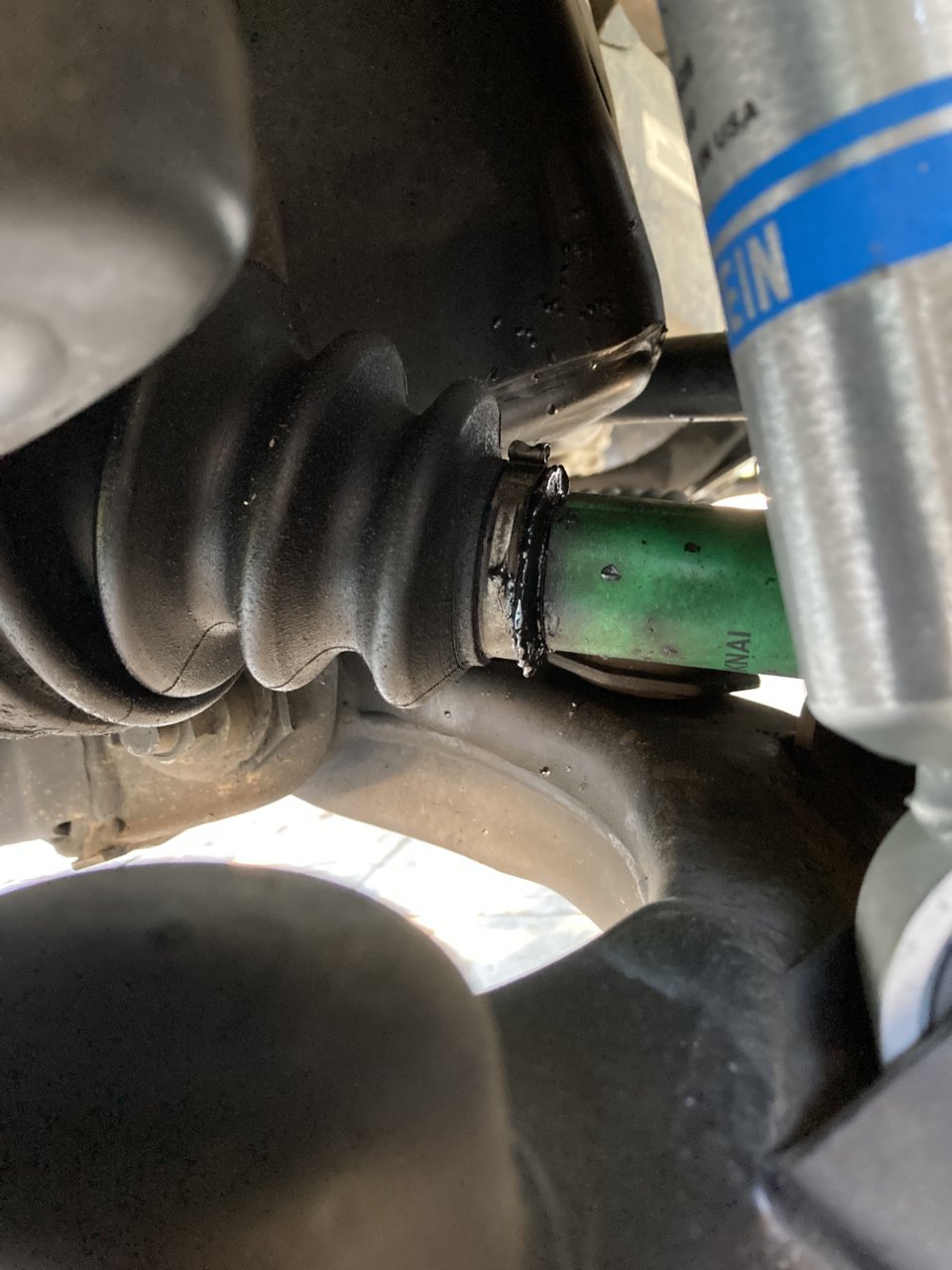

    I noticed grease in my wheel well (yay). Sure enough, my CV boot looks freshly torn.
    My truck is a 2000 Tacoma manual transmission 5vzfe (3.4) 4x4 TRD I believe with ADD.
    I have Fox 2.0 IFP shocks with SPC upper control arms. I guess it’s supposed to be a 2” lift up front. I have about the same lift in the rear. The truck is pretty much level.
    I installed the Fox/SPC about a year ago, or 5k miles.
    The truck has about 186k miles on the original CV axles.
    Do you think the boot tore due to age, or is it the lift, or a combo of both?
    Should I reduce my lift and then replace the CV axle? Or just replace the CV axle with the lift as-is and cross my fingers?
    If I do the CV axle I’m going to use a Toyota part.
    Here’s a pic of the driver side CV axle. Sorry the truck is on a slight hill (driver’s side is downhill). There’s no flat spot anywhere on my driveway/garage.

    2” is fine for stock cv axle just put a diff drop. Ik when I had to redo my cv axle toyota didnt have any and told them to give me a call when they have one, waited a month and nothing so i put some auto zone junker in ther for now.

    It’s most likely age. Yes lifting your truck does affect cv axles but your lift is fine. For reference I replaced my original CVs around 160k miles

    Both though the age effected it more then the lift changed just how the boots had been set all those years.

    You angles look fine and as others have mentioned, the tear is likely just due to age + the (slight) change in positioning from the lift. It happens to a lot of us - when we lift the truck, 20 years later - that in the first few thousand miles, one or both boots tend to tear. Definitely happened to me when I put on a lift (to OEM CVs with original boots) back in 2018.

    The tear is most likely a combination of age and the lift. The lift puts more of an angle on an aged boot and the boot can't handle it. Boots tearing after a lift is VERY common.

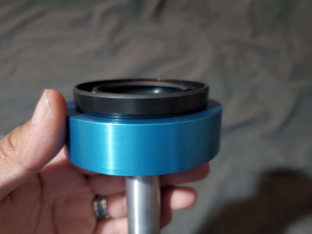

    For the oil seal job, there's a super cool tool the Wit's End company makes for the job. I showcase it in the video below replacing seals on a Lexus GX470. The tool is now available with an extra long driving handle which makes it even better. That driving handle also works super well for driving in the ECGS bushing on the driver side of the front diff. The tool is linked in the video description.

    I’d like to order the tool. They only have preorder right now. I might want to do the job before the tool becomes available.
    How did you get one of those already?

    Hmmm, I thought he had it available for sale already. I got one of the first ones because he knew I was going to shoot a video showcasing it.

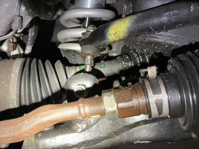

    Dan , what about aftermarket long travel boots like this?

    I have no first-hand experience with them, but unless you're running a LT setup, I'd stick with the Toyota boot kits. In my experience, they last the longest and fail due to age more than to lift (as long as you stay at 3" or less, which you want to anyway since even at 3" you have almost no downtravel).
    In fact, while I'm sure there are plenty, I don't know that I've heard of anyone having a (Toyota) rebooted CV tear a boot, but I've seen several of the CVJ "extended travel" (red) boots tear. That - to me - reinforces the theory that most people tear boots when they first lift their truck. In that situation, the boots on the truck are usually (a) as old as the truck and (b) have "worn in" at the pre-lift ride height. Changing the angles on them puts stress in places that weren't previously stressed, and the boot tears. A new boot, at the new ride height, can "wear in" at that height and be fine for a long time.

    At 186k on my 2001 I added a 3” lift , Well what I think is a 3 inch lift basically Bilstien 5100 on EMU 882 springs on setting zero with a 2.7 L engine. Almost Immediately within 300 miles both the inner boots started leaking a tiny amount of grease and flinging it luckily I don’t see any tears so I think for this particular problem I can pull the CV axles which are still Original. Then I can use Turbodb’s CV reboot tutorial before I actually get a tear and ruin the nice Toyota CVs.
